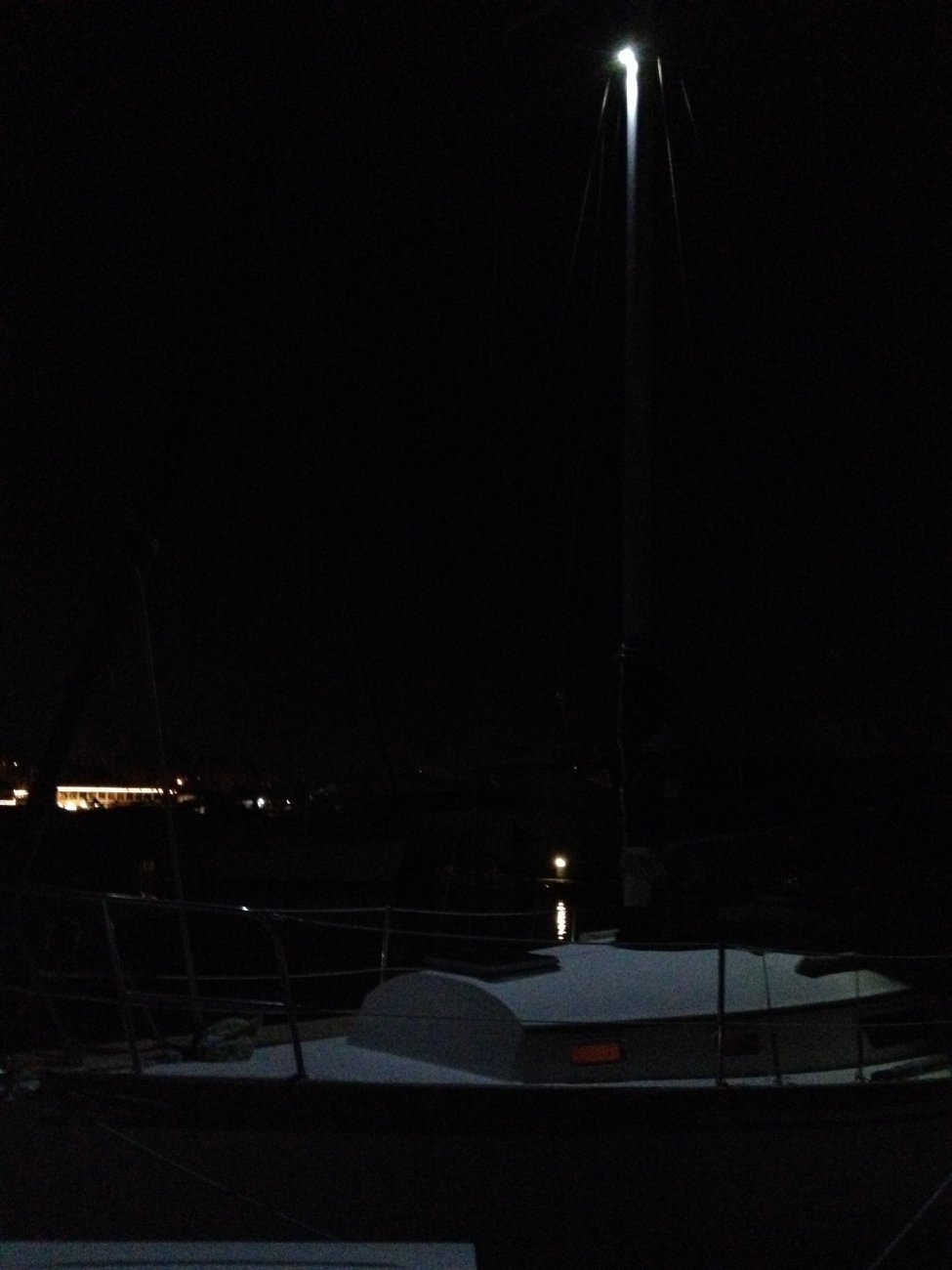

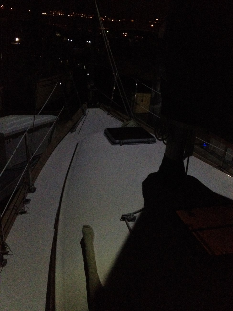

I did the thread on this Aqua Signal topic about a year or so ago.
Installed the Marine Beam bulb. No issues yet.
I won't say it's brighter than the halogen, but it's certainly bright enough. And it's a nice moonlight color. Also I think the coverage is wider and more even. The whole foredeck and even some of the dock is lit. See pics.
