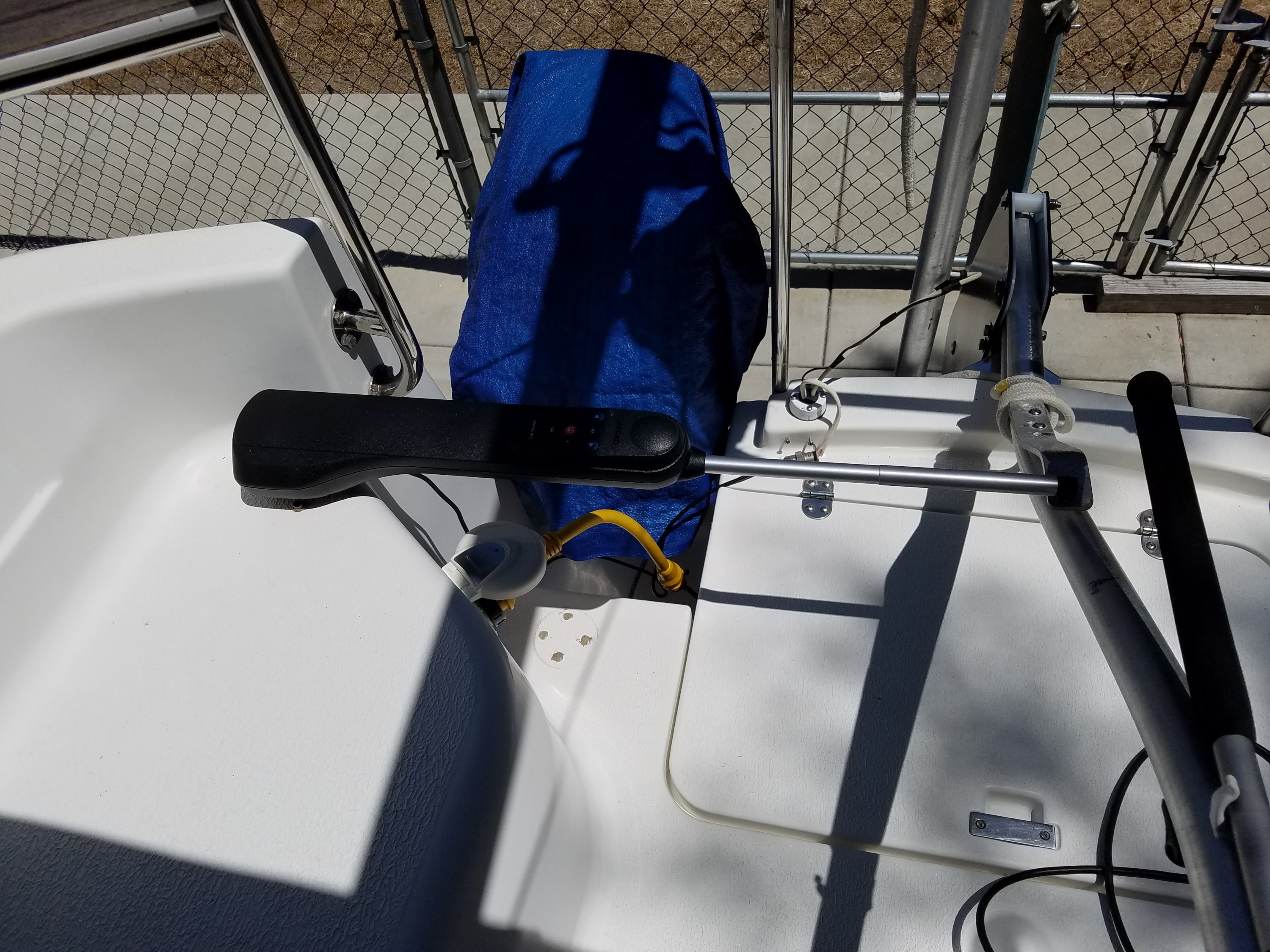

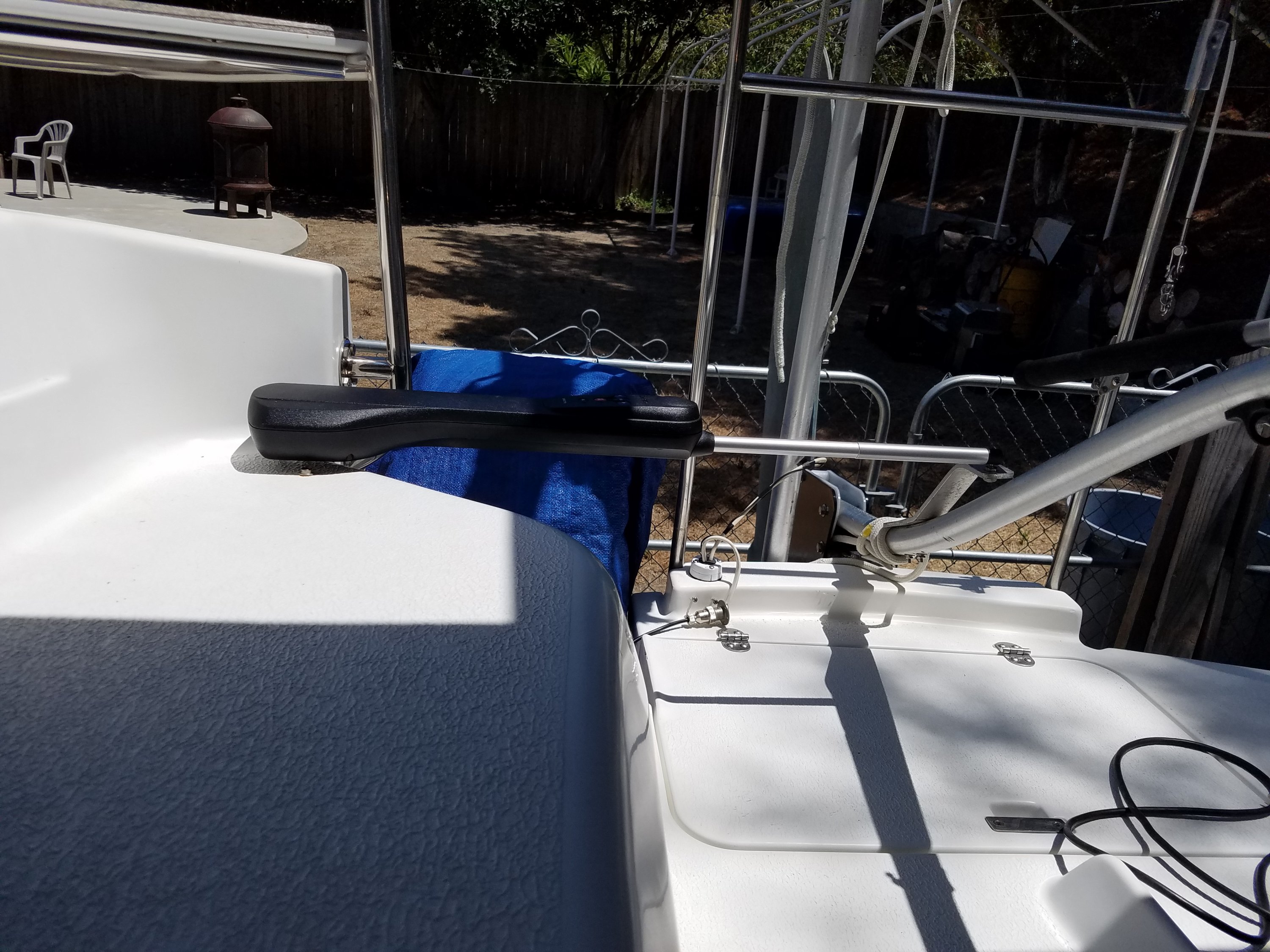

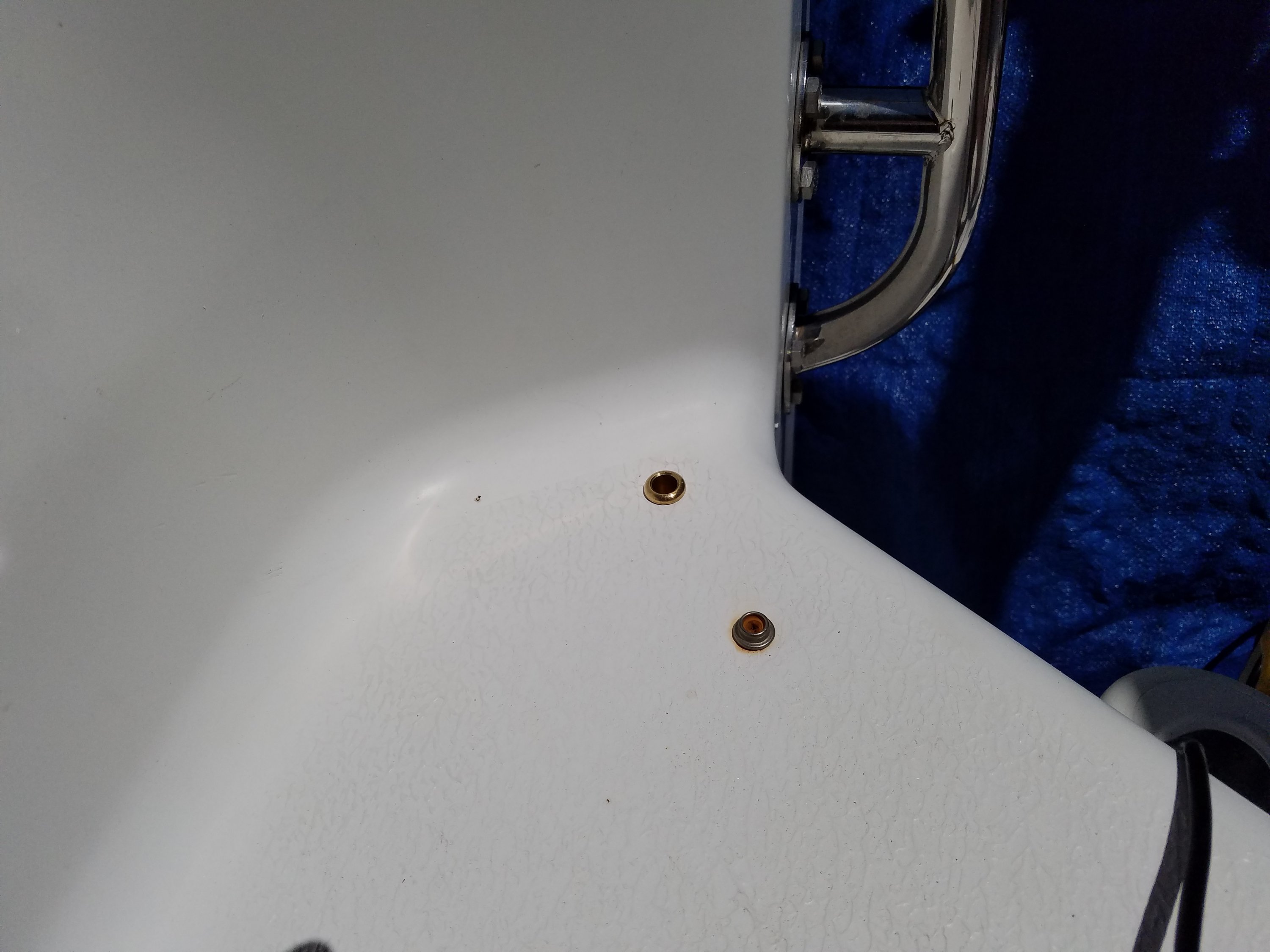

I ended up moving the mount for my TP10 to the starboard seat. There just wasn't enough travel for a port tack. I think it was really kind of ridiculous the way it was installed. The only thing it could really do was hold a heading, forget about the tack function. I removed the old aluminum mounting pedestal and for now just covered the holes with butyl until I can fix it correctly.

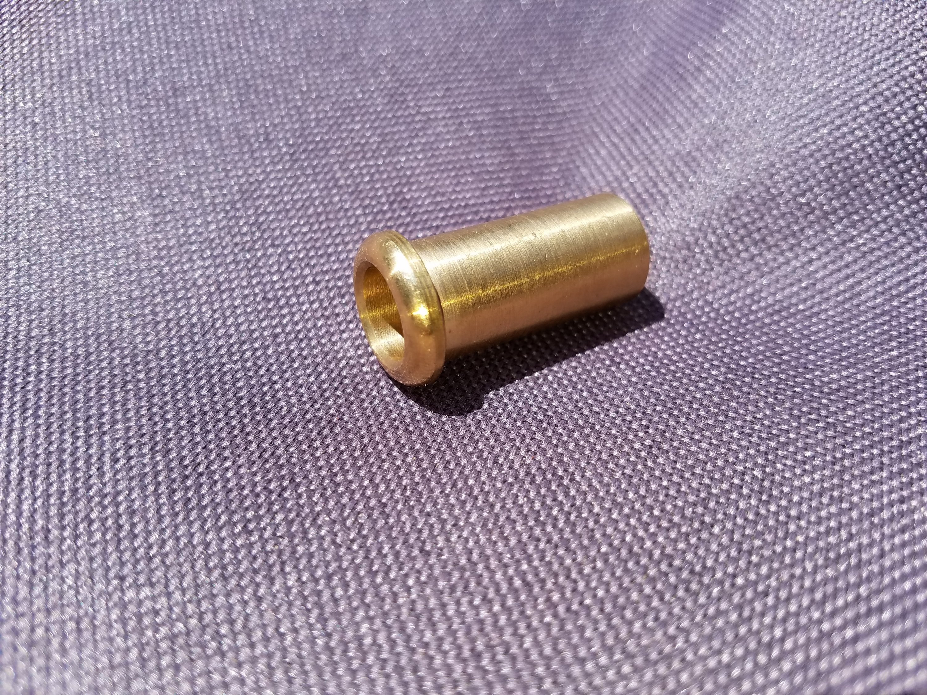

All it takes is this little brass mounting cup.

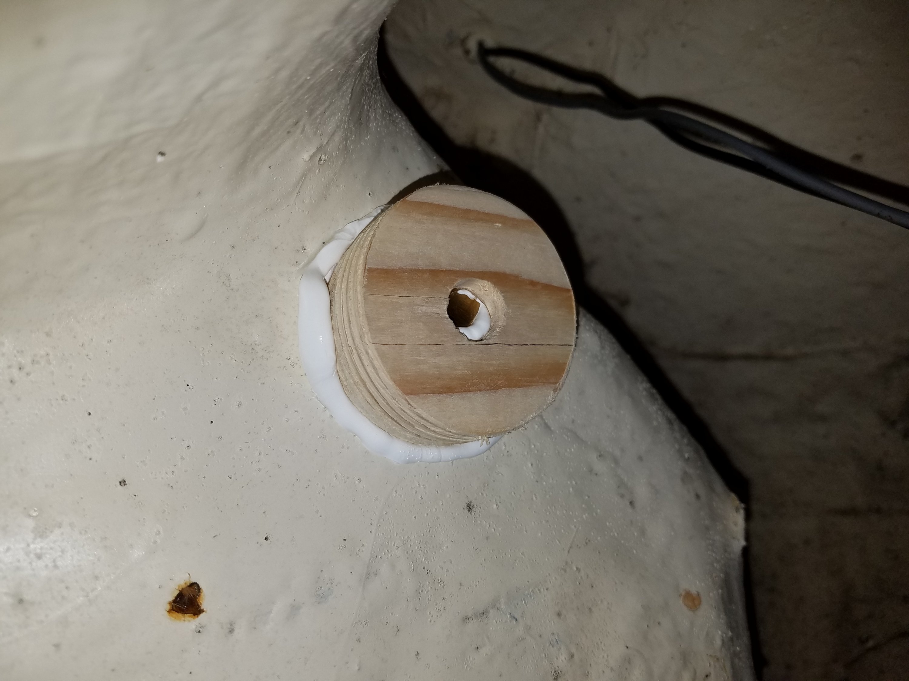

I installed the mounting cup in the starboard seat, using 5200 and a piece of hardwood inside.
It's very unobtrusive. The cockpit cushion goes right over it.
Someday I plan to replace the tiller and rudder assembly with a Rudder Craft setup, but that will take $$$. For now I just modified the parts I have to make it work. The tiller pin bracket was originally mounted on the bottom of the tiller. I moved it to the top and bent it to the correct new angles. The tiller pin is 18 inches from the pivot point of the rudder, as the instructions specify. I added a 6 inch rod extension, purchased from WM.
This setup should work well.
I'll still need to do something about the electrical plug.

Hopefully the proximity to the motor doesn't throw off the flux gate compass in the unit.

Well, I don't know yet. But in one of the pictures you can see the holes left behind from the old mount. It was sort of a little closer to the motor there, lower anyway. And the compass is more to starboard though. I guess I'll find out!
