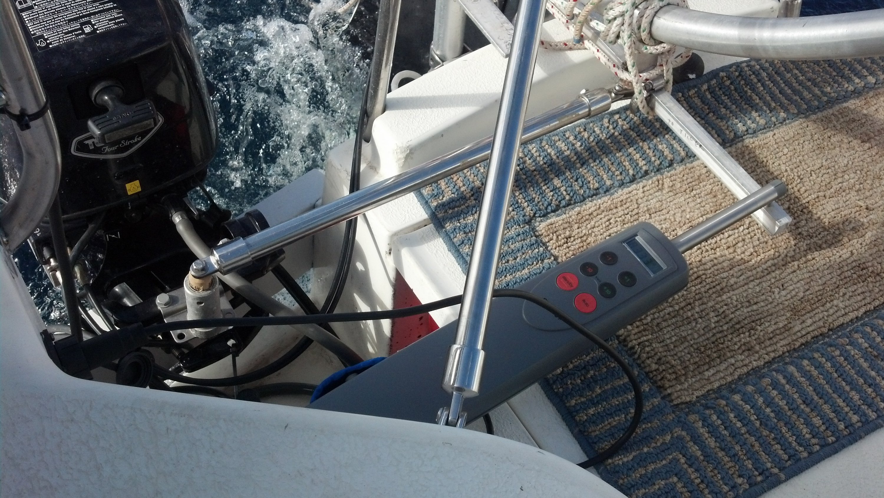

14
Hunter 26 Ventura, CA

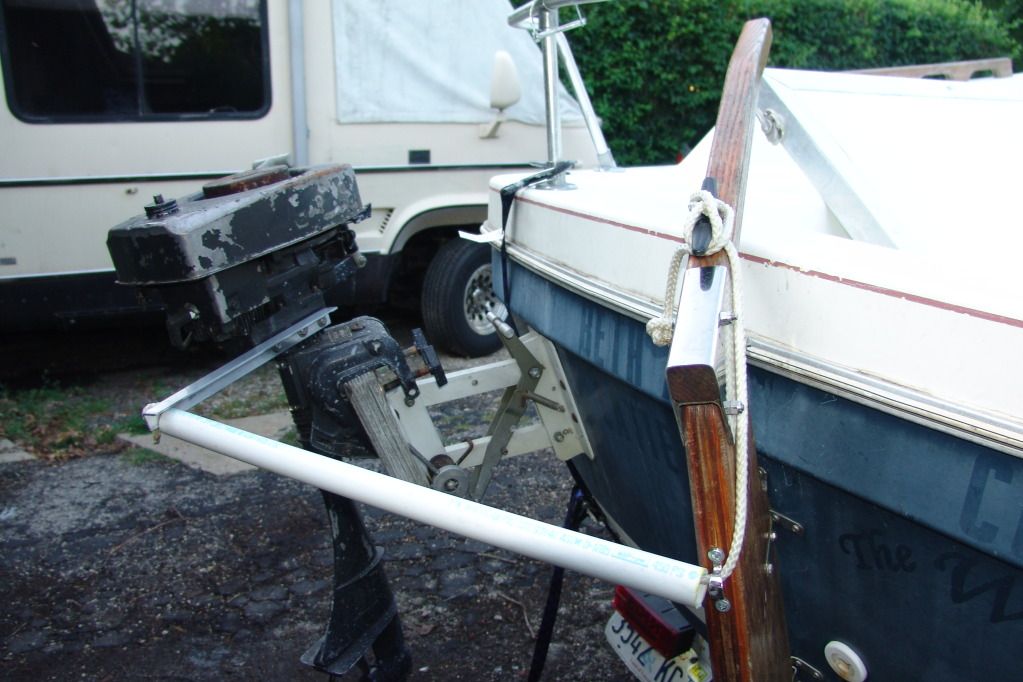

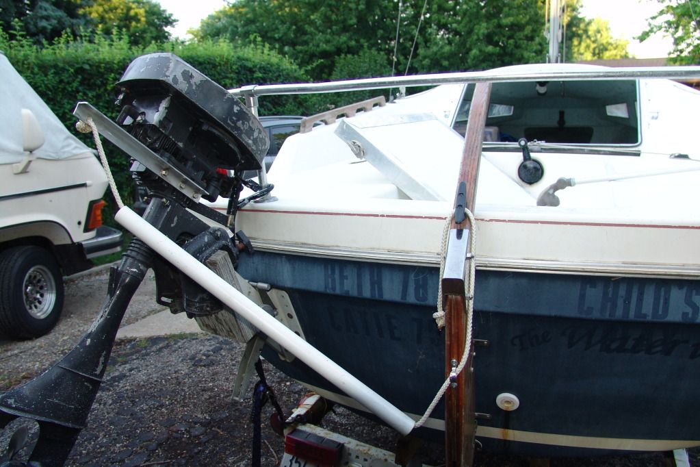

This is how we installed our ST2000 on a Hunter 26. It did require some welding; however, we can now steer the motor if desired. We have since replaced the connection screws and bolts with fast connect pins.

You're welcome. We have also cleaned up the rudder lines mess in the picture with jam cleats.

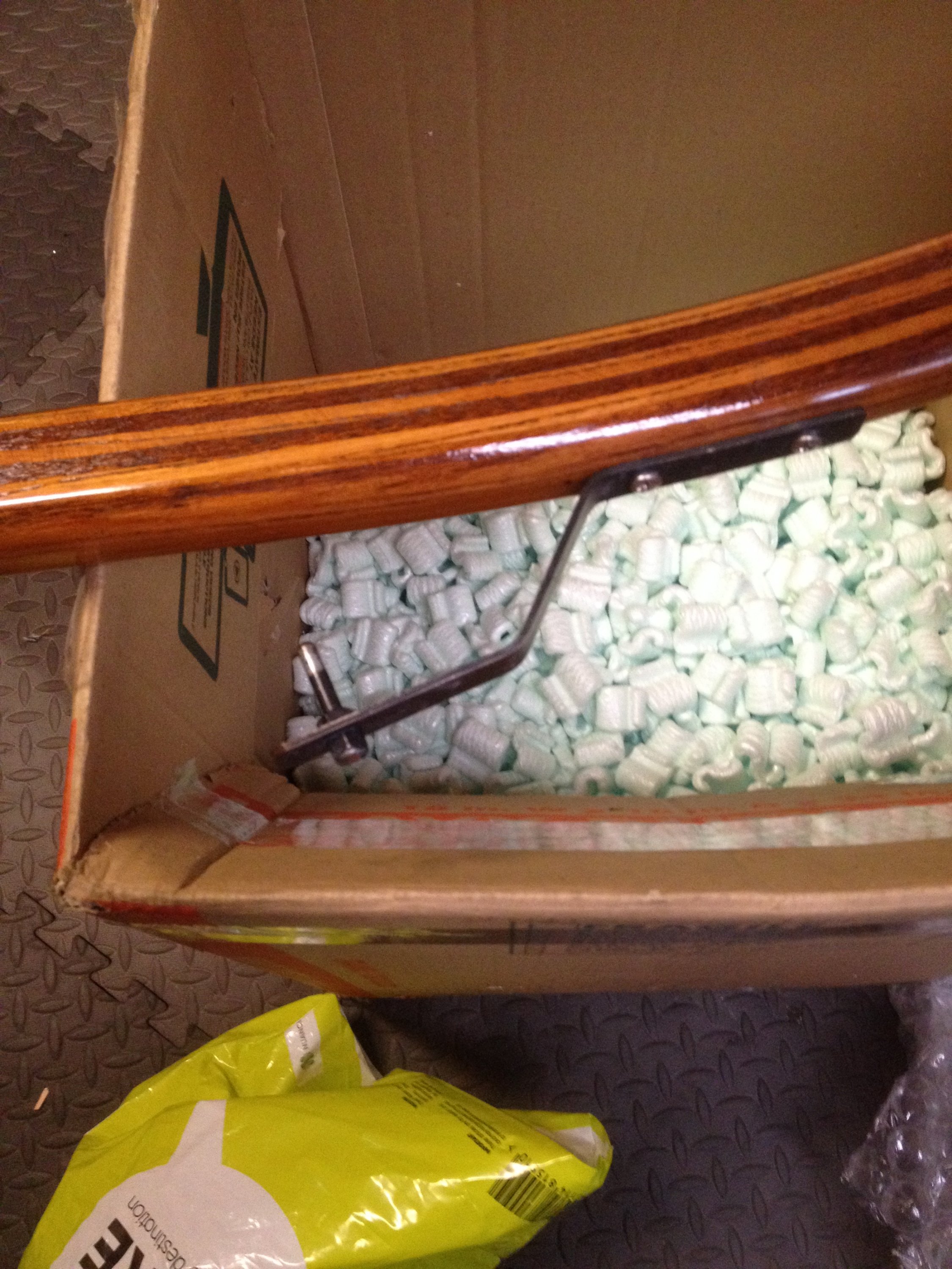

Not sure how different Simrad is, but when I bought my Autohelm from Ebay, it was just a matter of running over to Menards and purchasing a bushing for the mount on the boat. For the tiller, I just bought a stainless shelving bracket and bent it to the right shape. For the pin, I used a bolt. Put it in my drill and ground it down to the right size and also ground a ball on the end. Bolted it to the bracket and I was good to go.

Here's some points which CHSN WND should clarify. What did you get when you purchased your unit? Was the power connection outlet included? I assume the cable was there as it should be hard wired into the unit. The pivot bushing is available at most good supply houses. Next would be the tiller bracket and pin. This would need to be matched to your tiller. Download the instruction manual to see how to match the tiller with the unit. I made my own out of stock aluminum bar, heated, bent it and quick cool for hardening, after doing some calculations and dry fitting. I used a nut and smooth shaft bolt to create my pin. It's worked for me for four years now. Cost me $2.45 for the stock aluminum bar. The hardware and paint I had in my workshop. Saved $45 plus shipping. How ever I think I might like to create a new unit with a heavier/thicker bar.
