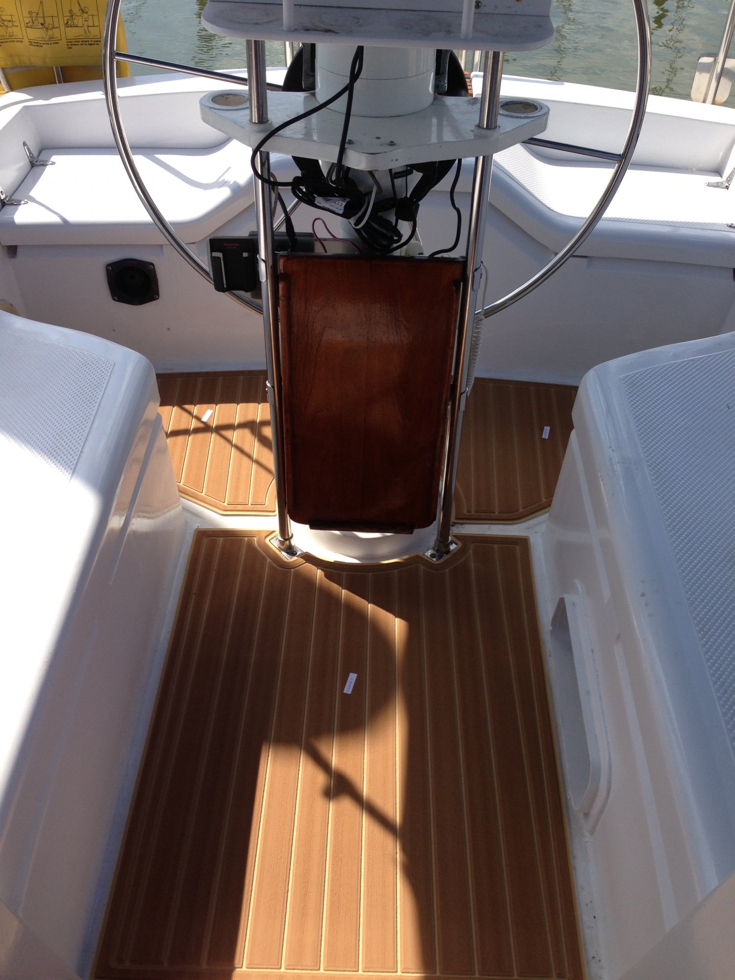

I templeted it myself and put it down myself. SeaDek is really great to work with. They will send you a dry fit template after you have sent the first template in. It is Mylar with a full size print out of how the pads will be cut. It is peel and stick. But the adhesive is excellent. This has been down for five years and no hint of it coming up. Although, I speak from experience if you are putting this down over molded non skid, you need to sand the non skid down and clean it well before applying the pads.
I am in the process of templateing the lazarette tops in the cockpit to put down a matching faux teak on them rather than cockpit cushions. Mostly so my dog will have better traction. I got an estimate from an installer for $2,200. Going direct to SeaDek the lazarette tops will cost $356 plus shipping and another fifty dollars or so cost for sending the templates back and forth. I plan to replace the stuff on the cockpit floor, as well. They still have the old template in their system and will just recut and send those as well, the cost for that will be around $360 as well.

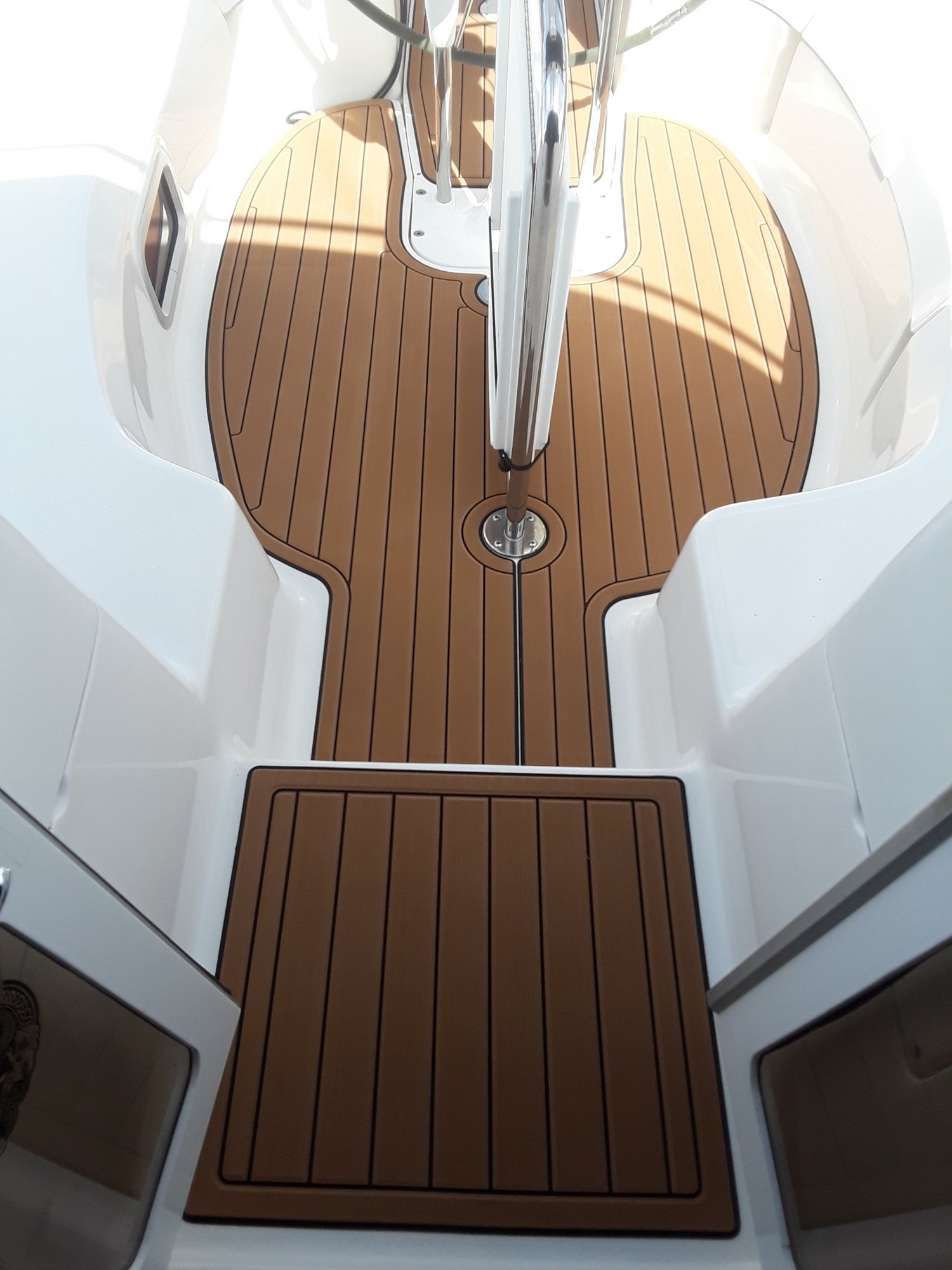

Ditto Seadek. It has a sticky backing. I had an installer scan my cockpit, make the templates and install. Cost was $1337 to cover the cockpit, companionway, swim platform and stern lazarettes.
That’s a good deal! Looks great. I think I’m going with the camel and black. Is that what you have?

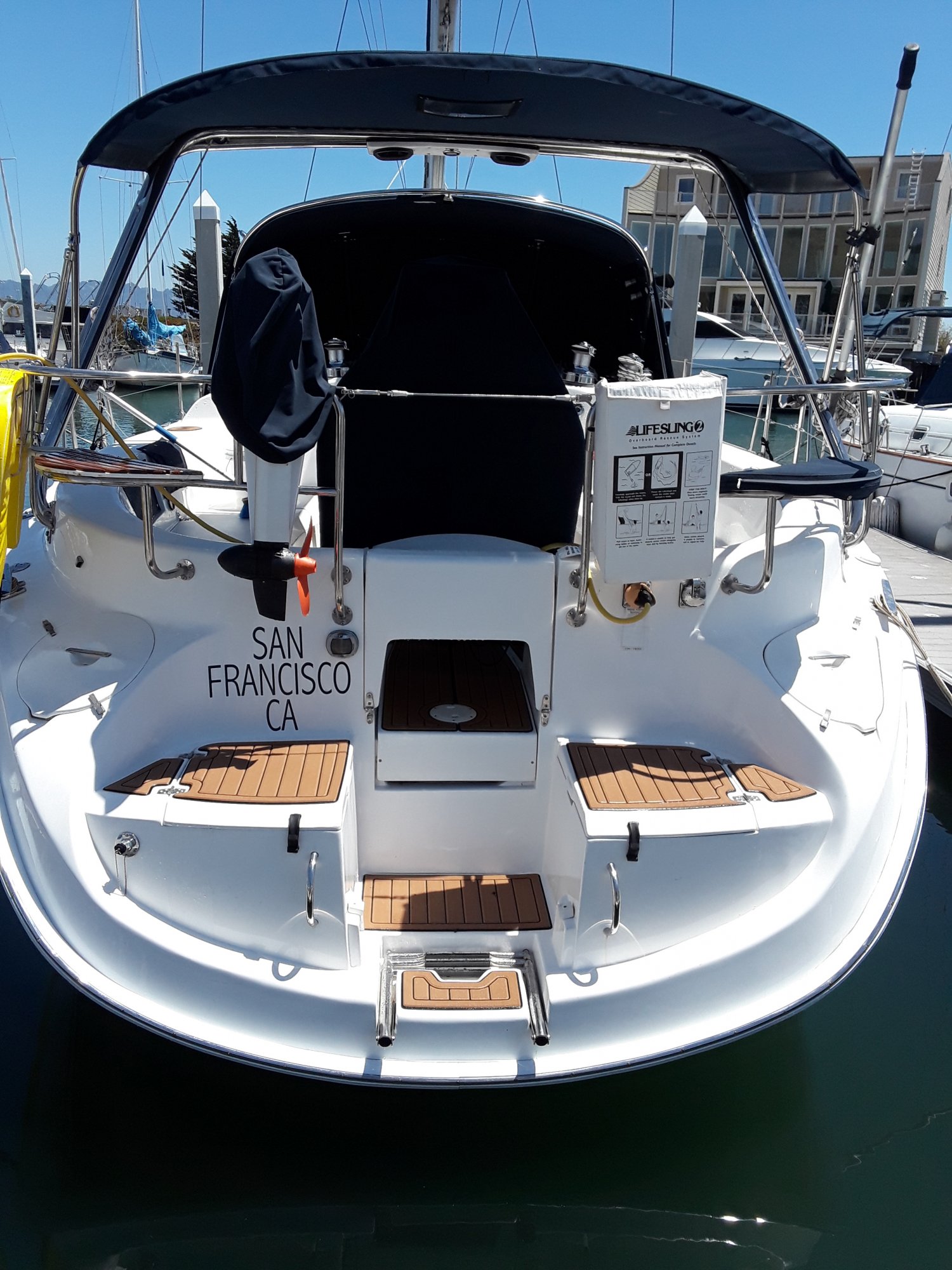

It is Seadek Dual Color Fabricated Sheet (6 mm) Brushed Texture "Mocha Over Black - 2 Inch Teak". I also ordered Seadek for ~2 feet section of the port and starboard gunnels so my dog will not slip and the underside of the stern seat.when the seat is rotated down while docked with stern in.
