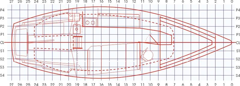

Ultimately you will need to get a tape measure in there for an accurate dimension but this should give you a place to start
Aug 5, 2015
3
Catalina 27 Baltimore
Thanks, that diagram will be a good help! Next time I'm aboard I plan to take detailed measurements but I figured I'd see what I can get while I'm here at work to get some sort of designing started.

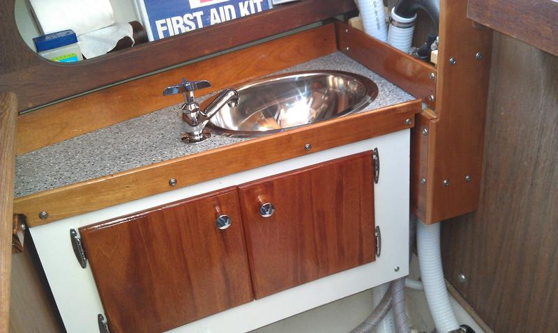

The original config had the head sitting on a ledge angled into the corner. I relocated my new head to face 90deg to center by extending the ledge. Then I built a sliding shelf, cabinet, sink unit that will pull out over the toilet seat area. In real life I rarely use it as intended. I brush my teeth with the cabinet retracted and spit into the toilet...
The angle set up was an attempt to get enough leg room so a door could be installed.... but I'll tell you this..... there is not enough room any way.. With the locker on the opposite side of the head it's better to make it one big space.. I have seen mods where a sliding door was installed between salon and head/locker area... and a shortened bifold door between vee berth and head....
All this said... there is really no privacy per se in this size boat... so I would shoot for comfort. That would suggest simply having partition between salon and the head/locker area.
If you build a shower, I think a wrap around curtain, rather than hard doors would make more sense.
I suggest you go to www.catalina.org and look for owner mods articles. You'll also find some brochures from different years that may help inspire you.
When re designing the head... figuring out the plumbing is the most important thing. Some models had the holding tank under the vee berth, while my dinette model had it under the forward settee... very convenient to the through hulls, etc. I added vented loops to my system and ended up putting them on the inside of the head so the Y valve could be operated from inside the head. It's very functional, but it isn't especially pretty... tho I like it. The pic shows the cabinet pulled out over the toilet. It retracts under the overhead shelf so the toilet seat can be raised.. but the faucet can still be used in the basin. The basin drain line is tee'd into the toilet's water intake line, emptying directly into the bowl.
