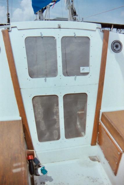

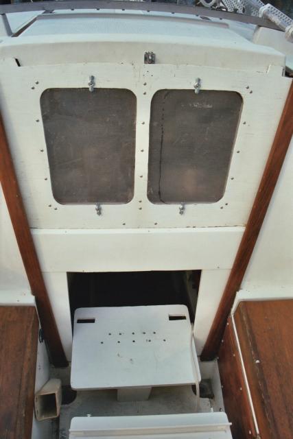

here's what you can do if you're a bit handy with woodworking tools. This was on my previous boat and worked well. The AC was a 5k btu with remote. The hatch assembly was originally just the screen boards, but a new lower panel was created to hold the AC unit.

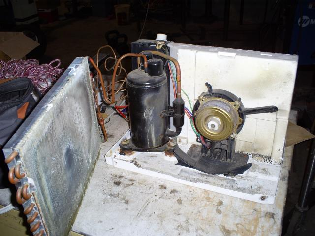

I am doing that to this AC unit. I ordered a 135 cubic feet per minute blower to pull air in through a cowl vent and push it out of another cowl vent. When it got here it had been dropped and was seized, I had to send it back. I got it for $22 including shipping, too bad it was bad. I have marine AC that works great, I was building this partially as an experiment and to have something that will run off of a Honda 2000 generator.
