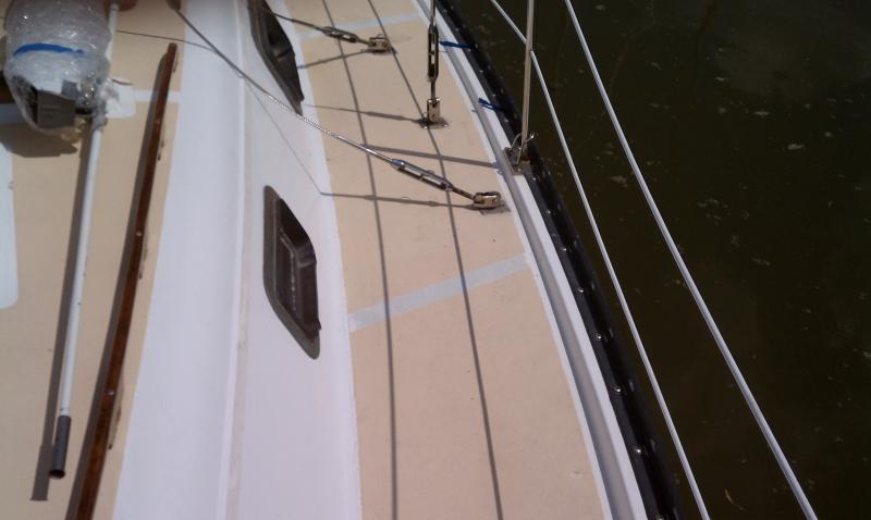

Got up at 0530 to be at the boat by 0800. Figured I had about six more hours of work on the mast after tweny-four the previous Monday and Tuesday. The picture tells the story. How stupid to install and not measure first. But the rigging was made as a copy, I had sent them the original.
The good news is that with a keel-stepped mast and tight uppers, backstay, and forestay that it might not fall on the Swan next to me.
The other good news is that my measurements for the forestay and new Harken furler were right. So after two hours of beating in the mast seal I went home. And I don't plan to return anytime soon.

Calm down Ed you'll get it . They're better to be too long than too short just call your rigger and get him to sell ya new shivs at cost and lend ya there hand crimp-er if ya lived near the Chesapeake I'd loan ya mine .

Fortunately the marina has a real swage machine. But who is going to pay for going up the mast twice? It was a bear getting those cotter pins in the clevis' standing on the ground. Now someone has to remove and reinstall four of those hanging up there.

Sorry to hear, Ed.. A mechanical terminal on the lowers? Supplied by the folks who made the shroud the wrong length from the old?

Consider measure, trim, and install Norseman (or other swageless fitting) at bottom only? That way no need to go aloft. Simple, tough, reliable.

Claude and Charles, I like your thinking. . . . kind of. I have heard the mechanicals are a tough install. And when I made the forestay I was surprised how hard it is to cut 9/32" wire. But I will definitely bring it up with the rigger when he/she calls back.

You arre right, Ed, I have heard that the installation of Norseman or StaLoc or other mechanical fittings is kind of tedious.. http://www.youtube.com/watch?v=2AsEXFr8NrU I have never done one so I can't speak from experience.. Looking at the instructions, it looked do-able,just kinda tedious.. Cutting the wire, it is easiest to use a 4.5" side grinder and cut off wheel or a Dremel or equivalent with a little cut off wheel..

Never installed norseman or swagelocks myself, but Chet P ordered all his new shrouds long, cut them and installed the terminal fittings for what is now our boat. I've had best results cutting wire with a hack saw while the wire was held in a vice.
1,085
Sorry for your tribulations, Ed. I had new lifelines made up out of 1/4" 1 x 19 (essentially shroud wire) last year. Took the rigger less than half an hour to make up four Norseman terminals. Mind you, he had good wire cutters. Anyway, from everything I have read, Norseman or StaLoc terminals are better and more reliable than rolled swages, especially for the lower terminals that can collect water and salt. They can even be opened up for inspection. Maybe the goofs who mis-made your lower shrouds will pay for that solution rather than being on the hook for new shrouds and mast stepping charges (which is what a reputable rigger who makes a mistake like that should pay for!). Keep us posted!

Well now for some better news. The rigging company said I would have four Norseman terminals by next Wednesday or Thursday. So maybe the 90+ weather will abate by then. They were very apologetic and I do like the company.
I have a 4" Ryobi grinder that does not have a cutting wheel option. So I will mount my vise on a piece of 2x6 and take my best hacksaw blades. I cut my 9/32" forestay with a hacksaw and it came out OK. I'll take the grinder for cleaning up the cut.

I have been where you are. I actually made a little jig to cut the wire. What you do is take a 2x4 and a saw and cut the end across the long way to make a slot, the drill a hole that is the diameter of the wire, push the wire through the hole and put the hacksaw in the slot. This keeps the wire bundled together and gives you an easy to hold on. I then used Quick Attach terminals. I have had my rig up 10+ years in a few big blows. The Quick Attach are very easy to use and you can't make a mistake with them like I have about some of the other terminals that require cones or un-laying the wire itself.=
