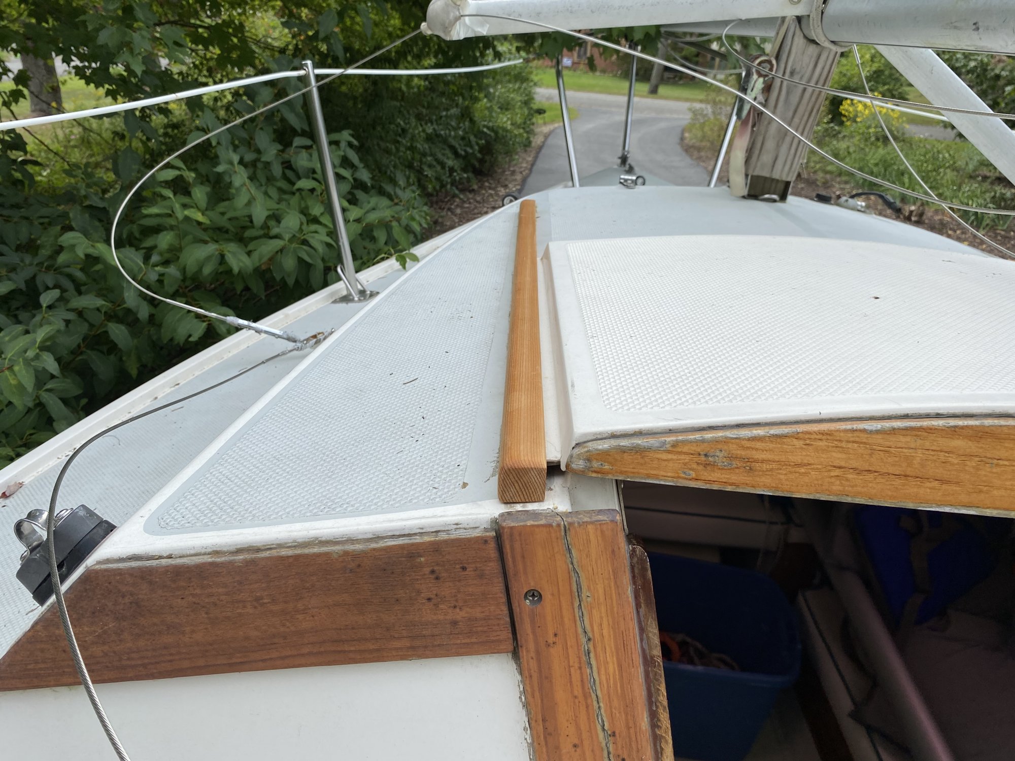

The only reason I could think of to cut it that way, or to glue that in, is to create a kind of “break,” so of you are sliding your hatch forward, you won’t smash it into the mast.
There is no way to know if there was a similar wedge on the other side, because the forward end of the other guide is missing.

Thank you everyone - It's gonna be awhile until I get time to do this, I'm hoping to be done before October 1st - but work has been crazy. I made two blanks out of cedar yesterday, I'm going to start milling them - hopefully next weekend.
I've decided that to do this right, I need to make both sides out of cedar, and then install them - maybe even launch the boat and go sailing with the cedar slides in place, at least open and close the hatch a bunch to check for fit.
I don't think the actual milling will be too difficult - I may invest in a new router table, I've been able to do some good things with my crappy $20, 30 year old sears router table - but this might be a good excuse to buy a nicer one.
