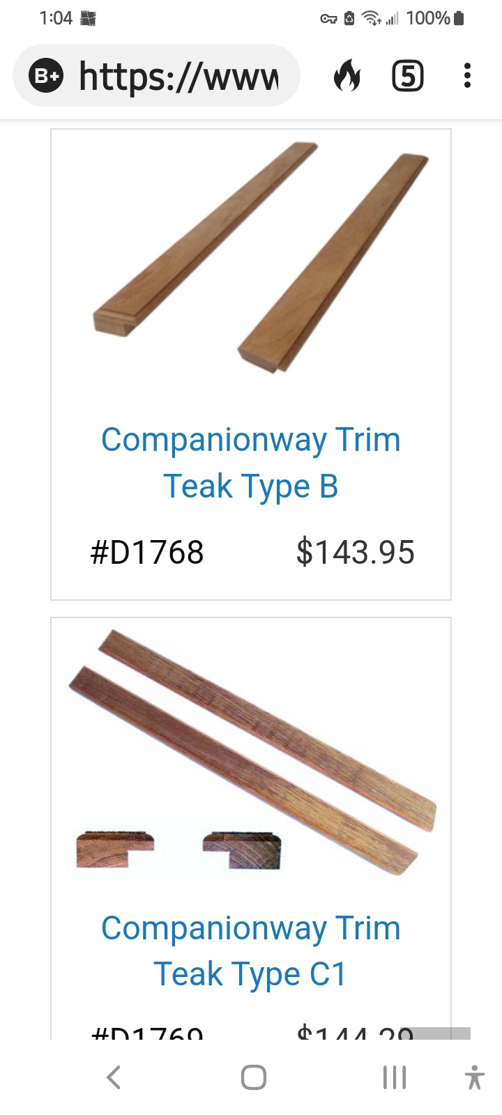

Here's an interesting company not that most of us could afford it but it's always fun to search the internet Sliding Hatch Entry Cover
Here is a picture from Catalina Direct something like that op is trying for?

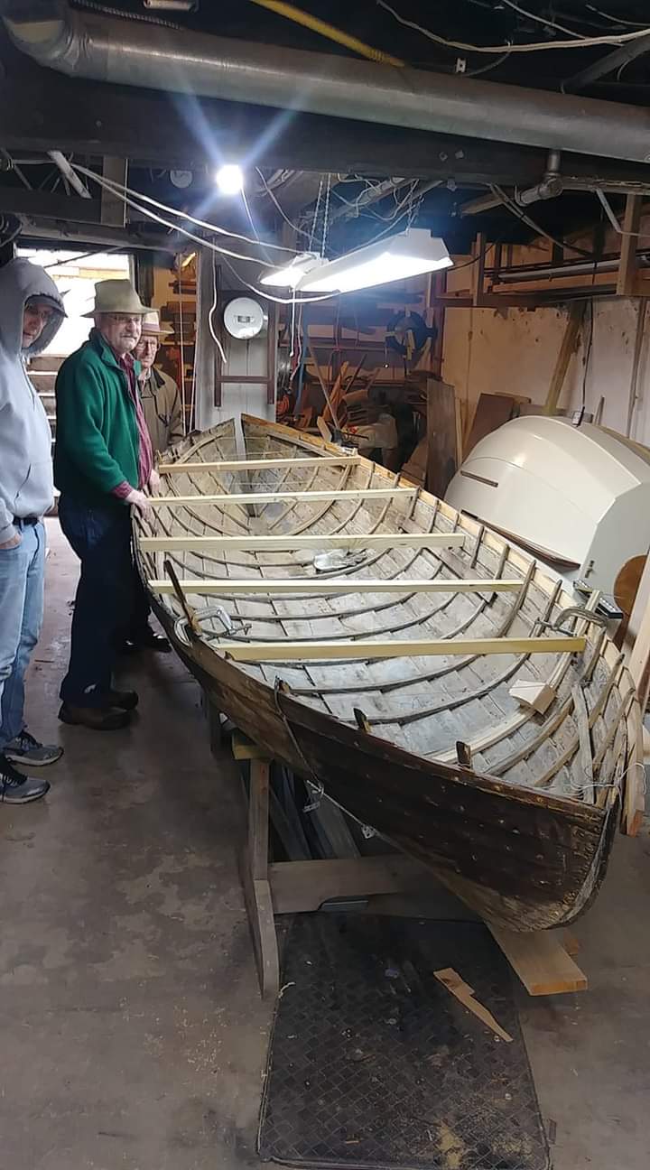

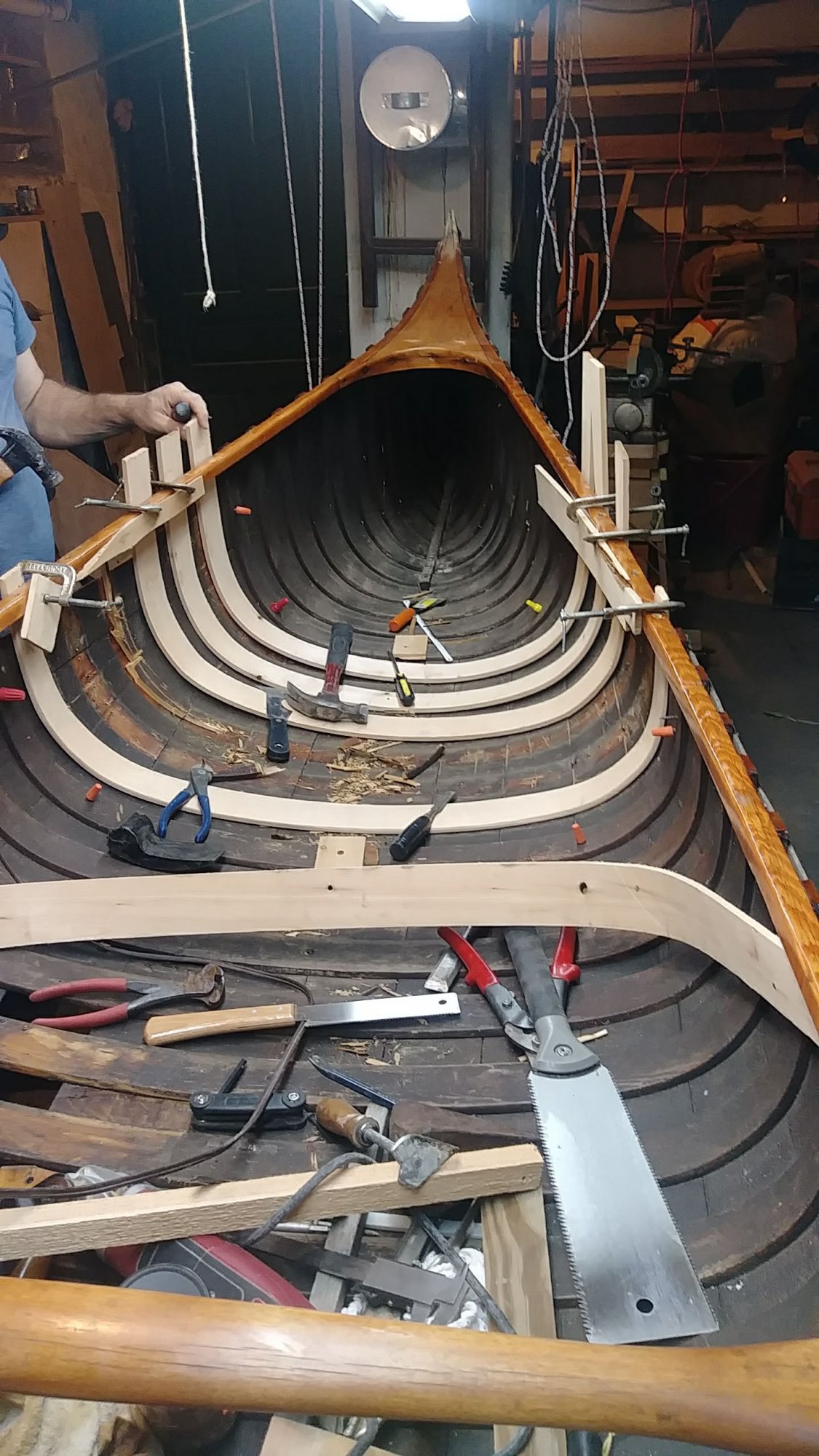

I have done steam bending when I made my canoe, and a couple other projects.
It’s a good idea. I was wondering if teak‘s reputation for being invulnerable to water also makes it invulnerable to steam.
I learned from the boatbuilding course at Mystic Seaport that it is the heat that allows the wood to bend and not the moisture. I think steam is used to convey heat to the wood easily and to avoid drying the wood which can cause it to distort.

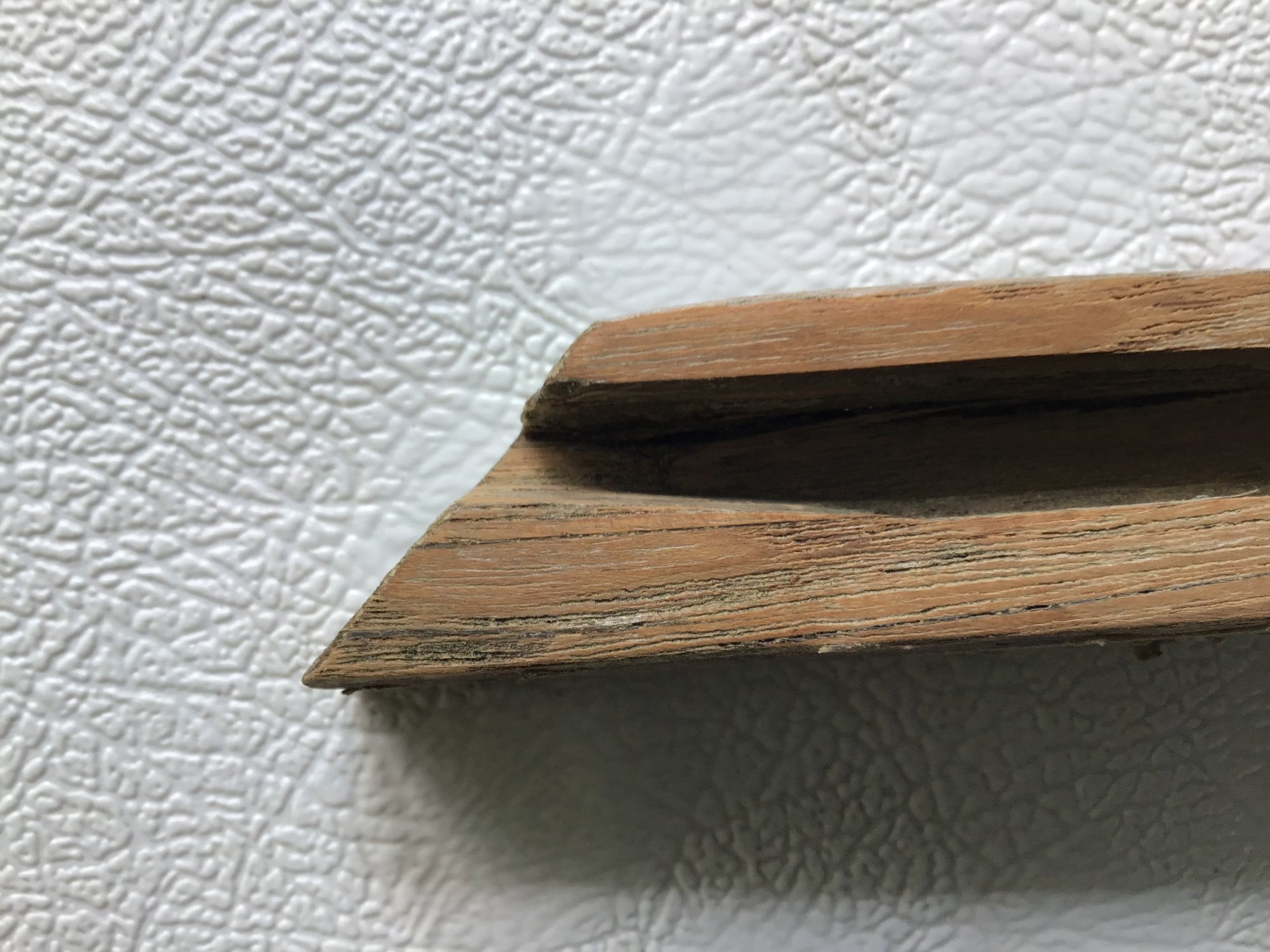

I appreciate your advice on species, but I think I'm going to stick with teak for three reasons: 1. The old ones were teak and lasted 20+ years. #2 There isn't much brightwork on the Capri 18, but it's all teak - I can sand and oil what I don't replace and really freshen up the old boat. #3 I've already bought the expensive sticks.

It's not just how expensive the pre-made ones are - I bet if you click on the "order" button you'll be told that you just can't order them at this time. I checked on 3 or 4 different suppliers.
Well I was just trying to get pictorial representation not necessarily directing anyone to buy anything

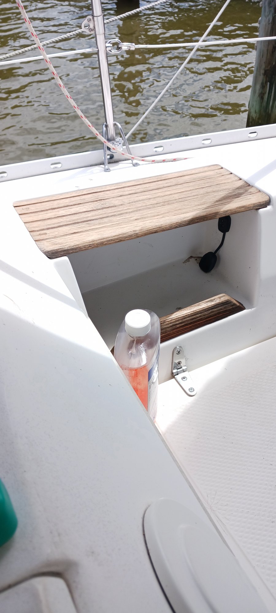

Based on your picture you might try restoring the old rails. Clean it with an oxalic acid wood cleaner, sand down to fresh wood and varnish (or teak oil).

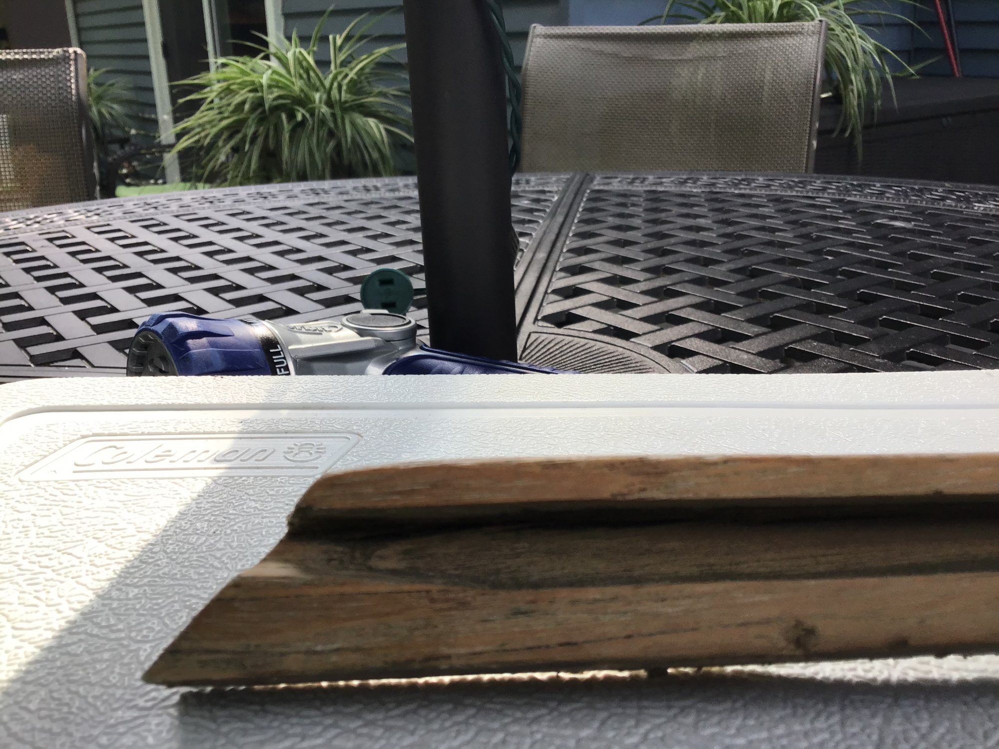

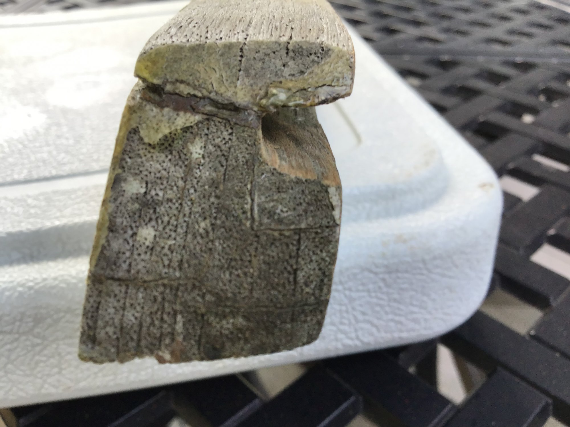

@ambler this was the better of the two, and I might have just refinished it if they were both like this, although there is a pretty good split that you can’t see in the pic. The other one is only about 2/3 there. It’s time.

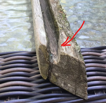

One thing I I did notice is this end seems to have a incline that may be something you should replicate. I don't know how your hatch slides in and out but this could be some kind of stop or something of that nature - I'm pointing to what I'm talking about with the red arrow.

@dLj
good eye! I didn’t notice that, and I’ve been holding it in my hand.
For sure I didn’t see it in the picture!
It’s on the bow end of the guide. Hard to tell if there was a mating one on the opposite side, because the opposite side is mostly gone. My guess is it’s kind of a break, to keep you from opening the hatch too quickly and cracking the hatch on the meat step? The angle might pinch the hatch to slow it down.
On the aft end, the groove on the port slide does not go all the way to the end, but the starboard one does.

I think that little nubbin at the end of the rail is just where the cover has not opened up the slot wider because the cover doesn't slide perfectly to the end of the rail.
