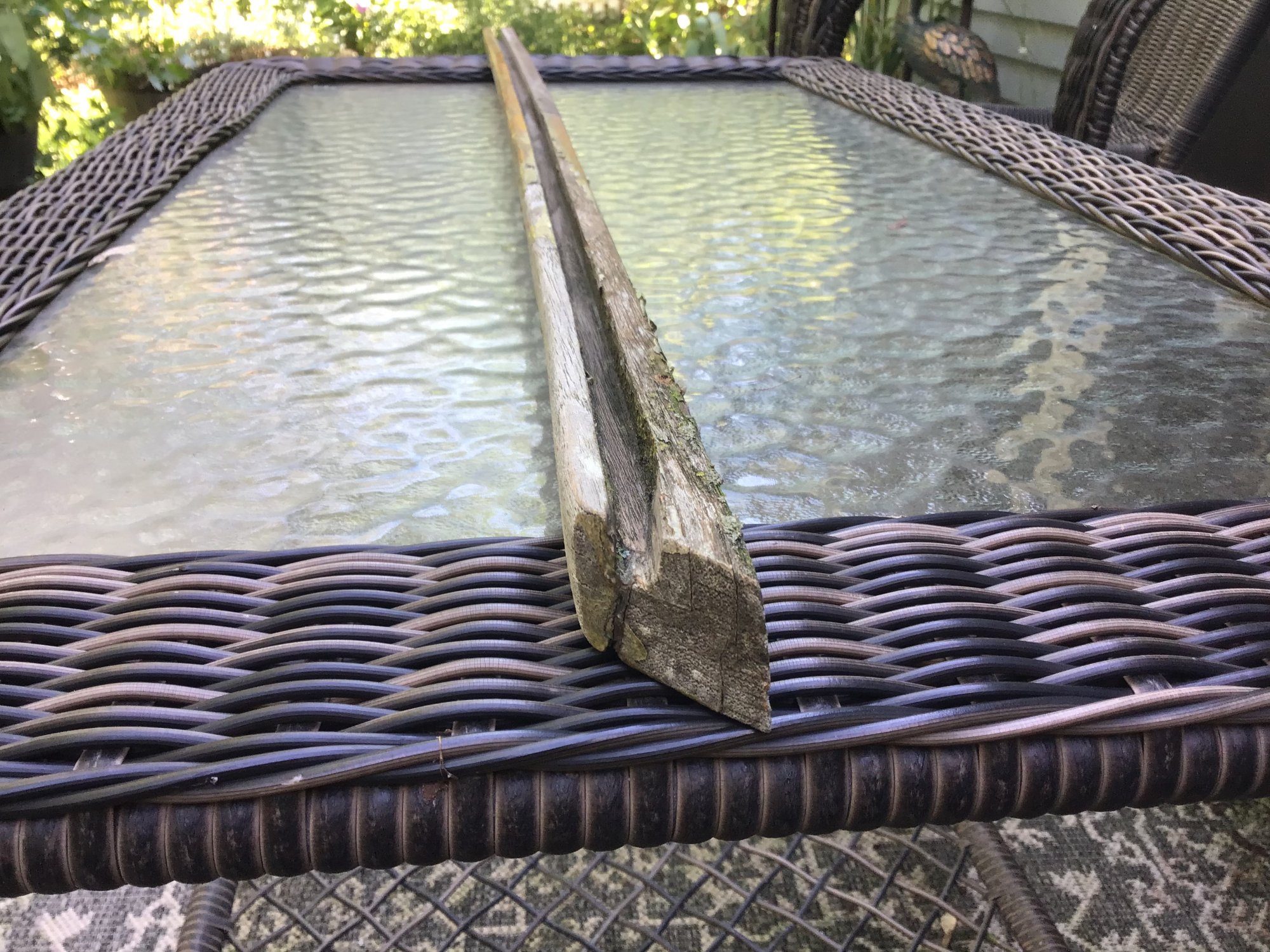

The guide rails for the sliding companionway hatch need to be replaced on my Capri 18. I can’t source replacement parts, so I ordered some teak - the most daunting part of the project is the price of the teak. In other words, I want to get it right the first time if I can. I’m considering making one in pine, then one in oak, before I start with the teak.
here Is my question:
There is a slight camber to the coachroof. When I lay a straightedge on the roof, the center of the line is 1/4“ lower than the ends.
l‘m thinking the idea is to make the piece straight, and draw down the center with the screws? The teak is 1” x 1” x 41.5” but teak Is pretty rigid, isn’t it? Am I going to be able to bend it like that?
Im not sure I could mill it that subtly, maybe with a belt sander? That would be tough to get right.
Any suggestions?

+1 for making a test run / template in pine. My dad just re-made our cockpit table with teak, and templating the complex parts in pine was a really good way to find solutions to surprising complications.
If you can’t safely bend the teak by hand you could steam bend it. I’ve done that with oak and it works out very nicely. For that gentle of a bend I bet you could either bend it manually or steam it and apply it directly onto the boat, without needing to make a bending jig.

Don't quite understand your issue with camber. Generally rails for a sliding hatch run straight fore & aft and ignore any camber of the cabin top. Camber is also generally designed to shed water. Your description makes it sound like the cabintop is bowed down - cupping to catch water instead of shedding it. Teak is notoriously difficult to bend - often splitting instead. Why would you need to bend it?

1/4" in 3.5' is barely perceptible. There is no need to steam the wood. It will very readily adapt to the curve. I will suggest that if you want to avoid the headache of finishing the wood, use an alternate material. There is a reason why your original pieces look the way they do ... hardly anybody wants to deal with wood for those rail slides. I bought a Timberteck plank to shape new rails for my Starwind. They were an improvement, though some would say otherwise.

If you bend the wood after the track is cut into it, the track will not be straight. You will end up with a dip in the track groove.

Cut the slot (track) with a guided router bit or table saw with stacked dado blade before you cut the shape of the rail it will be easier to work with when it's still a square or rectangle I wouldn't wouldn't worry about slight Bend unless you want to try and rework the whole coach roof

Can you tell if the slots were perfectly straight when the original rails were in place, or do the slots just follow the curve? My guess is the slots just follow the curve, and it’s a gentle enough bend that the companionway doesn’t bind.
