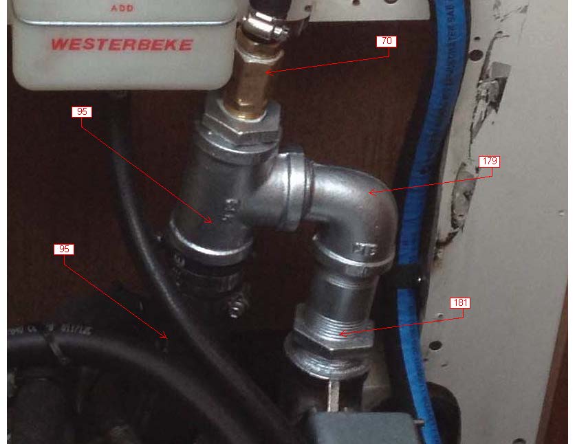

FWIW, I use aluminum foil as an outer wrap over the muffler insulating tape. It is cheap and readily available and helps protect the wrapping as well as keeping a little more heat inside the elbow. I have my original elbow and it is still working great :biggrin:, most likely because I am in fresh water 98% of the time. I did not notice it, but you should have a loop going into the top of the elbow that supplies cooling raw water from the raw water circuit that comes off of the heat exchanger after it has cooled the coolant. That water is sprayed into the elbow to cool it and the exhaust so it can pass through the rubber exhaust hose and go overboard. One common caution is if you are cranking your engine more than 30 seconds you do not have exhaust gases pushing the water overboard through the exhaust and it can fill up the muffler and back up into the elbow and then back to the exhaust valve and the engine :yikes: at which point you need to drain the exhaust or risk locking up your engine. :poop:
Here is the link to the discussion that Jesse, one of our 310 superstars, started on a replacement "do-it-yourself" exhaust elbow from ordinary parts. Custom Exhaust Riser/Mixing Elbow
Yes, we did discuss this issue. The hose from the HE runs forward and thru a bulkhead before returning and terminating at the downstream end of the elbow (on the front side - hidden from view). I'm supposing that there is a vented loop on the other side of the bulkhead. I'll be climbing in there from the lazerette and exploring soon enough!

Insulation also reduces corrosion. It seems to be related to both condensation and heat flux, and the exact mechanisms are hard to track down. But it always helps. We see this in refineries and boiler systems all the time.
