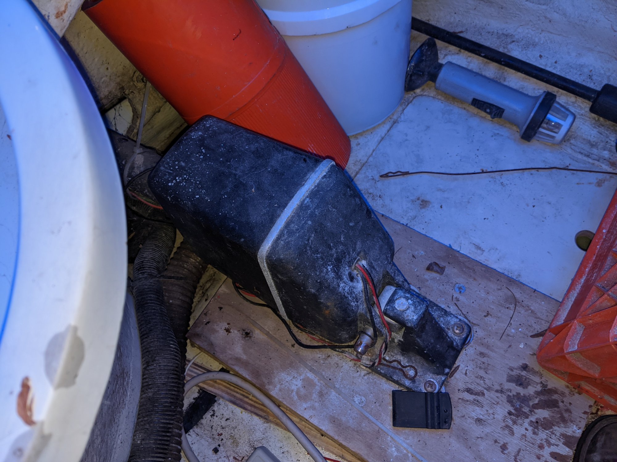

Hi all,
I'm going through our pictures that we took of our new (to us) boat after we closed last weekend (it's currently winterized in Michigan, we're in Minnesota). I snapped a picture of this, but forgot to ask the seller what exactly it is/does. This is mounted in the rear port side locker under the cockpit seat. The boat is a Hunter 376, but I don't think this was OEM. At first I thought it was a part of the manual bilge system (the pump is mounted to the wall to the left), but upon second look it wouldn't make sense that the manual bilge pump would have wiring (or maybe it does?)
I'm pretty sure this board is screwed down, so I don't believe it is something that's removed for it's intended function.
Does this device look familiar to anyone?
Thanks!

It looks like the ram for a below-deck auto pilot. There should be an arm coming out of the left side connected to a tiller arm on the rudder post.

Indeed. I missed that it didn't have the ring on the wheel for the wheel drive. Something new to learn about. Thanks, everyone!

I snapped a picture
Did you notice you suction cup, stick on dingy,...
Stern Light
On the top of you picture?;)
Jim...
PS: I have the same type, plus the Green/Red Running Light too.:)

From what I understand the autopilot works just fine (PO said that the compass heading vs. autopilot indicated heading is off by about 10 degrees, but that doesn't worry me too much as I anticipate our trip mostly being "point the bow and turn it on.")
But, if we find different, it will definitely be something to fix before we leave. 700 miles is a long ways to hand steer a boat. I'll keep Rob in mind.
We sailed our Catalina sans autopilot for the first few years, I added an EV100 package last season, it makes SO much difference. But, of course, that was wheel drive, hence my lack of familiarity with the linear drive hardware.
There is an easy calibration procedure. It looks like Raymarine Drive.
Check the manual on the model for procedure. You can do it at berth.
