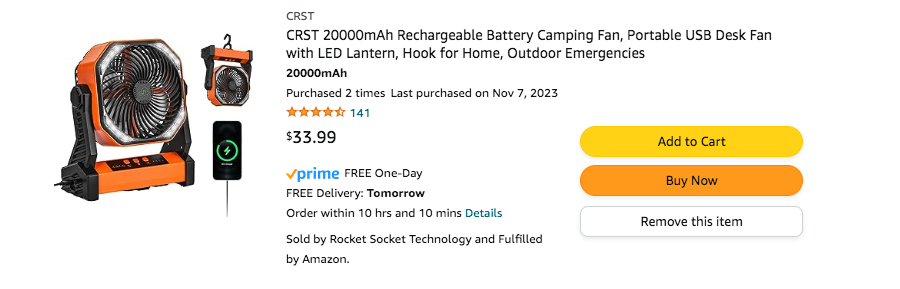

My thoughts...
1) Rechargeable fans, I have 2 for galley, can be hung or placed anywhere, move air & can be used as lights, recharge devices, ect.
2) Light a candle, I usually leave one in sink, in case I forget, works very well in small areas like salon.
3) Open all hatches and do as above.
4) Yes, absolutely check/replace head hoses, make sure bilge is dry/clean. Less ye move shiite air.
5) Look under engine, make sure it's dry & there is no diesel/water below, before/after sail. Sometimes drip seal is drippy.
6) Make sure head is always pumped out when you leave boat, rinse with fresh water & deodorize (I use Raritan K.O.) Don't sail on a floating port-a-potty.
Good luck.
