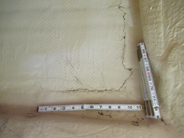

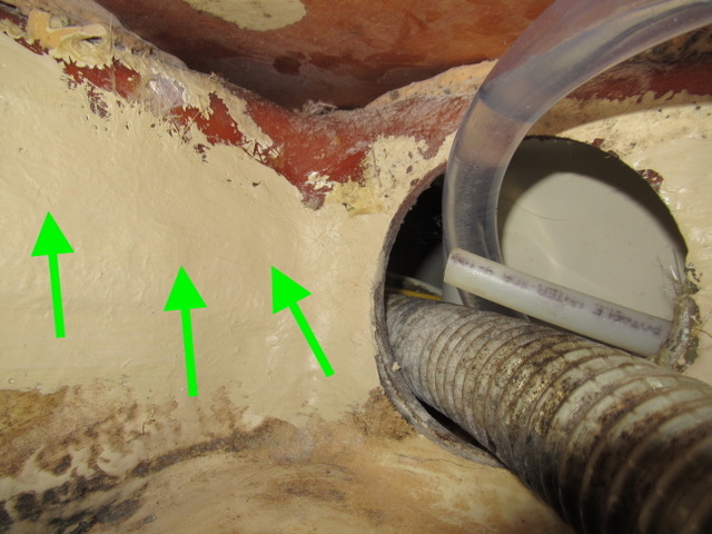

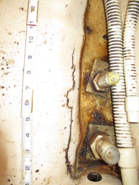

Hi there. I'm hoping someone can provide me additional guidance on a survey on a 2000 Hunter 340 I'm looking to purchase. I'm new to the sailing world so any help would be greatly appreciated. I have 3 pictures sent to me from my surveyor and hoping you kind folks can tell me 1) they'd walk away or 2) it's no big deal.
Thanks for your help!
Here's the list of main issues, see attachments for pics.
  • some damage to the bulkhead tabbing noted under the port settee
  • Crack noted in fiberglass in the aft section of the keel sump/ bilge
  • Obvious repair work noted in the main bilge sump

Hard to state a judgment based only on a few pictures.
Many of us have gone aground. Few result in damage and then, the repair can be better than the original construction. However, we can’t tell from pictures.
Absent additional evidence, we are just expressing uninformed opinion. The fundamental question is whether you want to take internet advice from strangers on which to base a purchase decision. I know what I would (not) do...

Yeah - defnitely hit something with the keel. Look at the forward tip of the keel for evidence of hitting something. If those two keel bolts in the picture are the stern-most, that is evidence of hitting the tip of the keel and it trying to "hinge" fore and aft at the keel hull joint. Generally, this can all be fixed so it's just a matter of money.

Thanks for the quick reply dmax. Yes, it is stern-most. I did not complete the full survey, which included the short haul to look at the exterior of the keel, yet. With that said, the current owner is getting a repair estimate for the crack next to the keel bolts. I'm just unsure if it's reasonable to buy a boat knowing it has these cracks and potentially needing repairs pre-purchase. I understand it's a decision I need to make--I'm just collecting opinions from everyone at this point to help me make a more informed decision.

It all depends on who does the work. I once had an O'Day 302, which had a flaw in the keel shoe implementation where the design called for six layers of fiberglass and the builder only put in two (O'Day was farming out the hull build). A soft grounding resulted in the keel breaking the shoe and falling off. The guys that fixed it did an excellent job and it was much stronger than the original - I sailed it for many years after that. It is a lot for your first boat but if you can make sure it is fixed by someone who has done it before then it shouldn't be a problem.

My first inclination is to walk. YMMV. However I have a friend with a Hunter 44 that suffered a hard grounding a couple years ago and just last year found tabs separating from the bulkheads. There were no cracks in the hull or near the keel bolts. All is repaired now and I was told it looks like first class work. Bottom line was cost north of 6K. Fortunately insurance covered a big chunk of the cost.
I would pay close attention to your surveyor, assuming you have good confidence in him/her. Any opinions you read here are, well, just opinions.

I don't like the look of all the rust around the keel bolts. The strain put on the bolts during the grounding could have caused some tiny stress cracks in the bolts that have led to crevice corrosion.

All that said, this will be a serious repair. I suspect the boat was damaged. The owner did not think it was too bad. So he sailed. The rust on the keel bolts says it has been a while since the damage occurred, and water has been leaking in there and elsewhere (water always travels well beyond the immediate damage).

I don't know what is going on in the third photo of the keel bolts. There are areas similar to the first photo in the bilge of my boat, but my guess it's just gelcoat cracking from sloppy application. I have peeled up the cracks and the layup underneath is sound, the gel coat was surface applied over molded on and it's different thicknesses.
I've never liked that there's only five keel bolts on the 340. Sort of relevant is an interesting old thread about keel stubs by Maine Sail, compares Hunter 340 layup thickness to failed Oday's.
