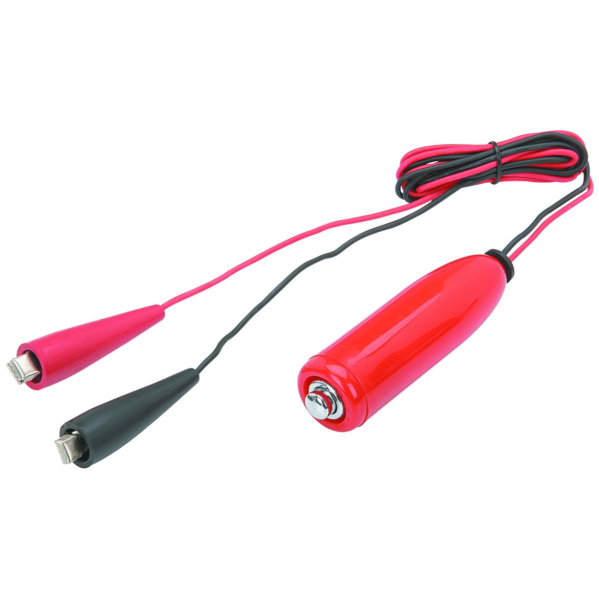

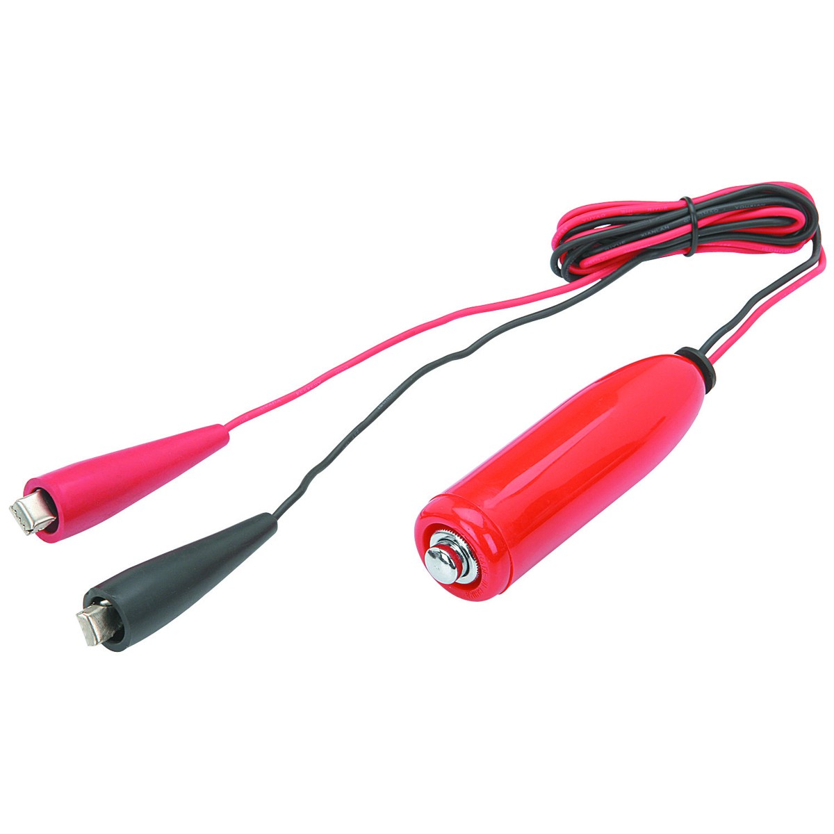

Have you run a remote starter (see below) to try to turn the engine over? Sometimes unrelated things can go wrong and you are chasing your own tail, not considering that it is unrelated.
Likes: Rick486

Have you run a remote starter (see below) to try to turn the engine over? Sometimes unrelated things can go wrong and you are chasing your own tail, not considering that it is unrelated.View attachment 195105
I've used plyers handles to jumper across the starter solenoid. It works great. The button tool shown only works if the solenoid is good. I have one somewhere but unlikely to use it.
