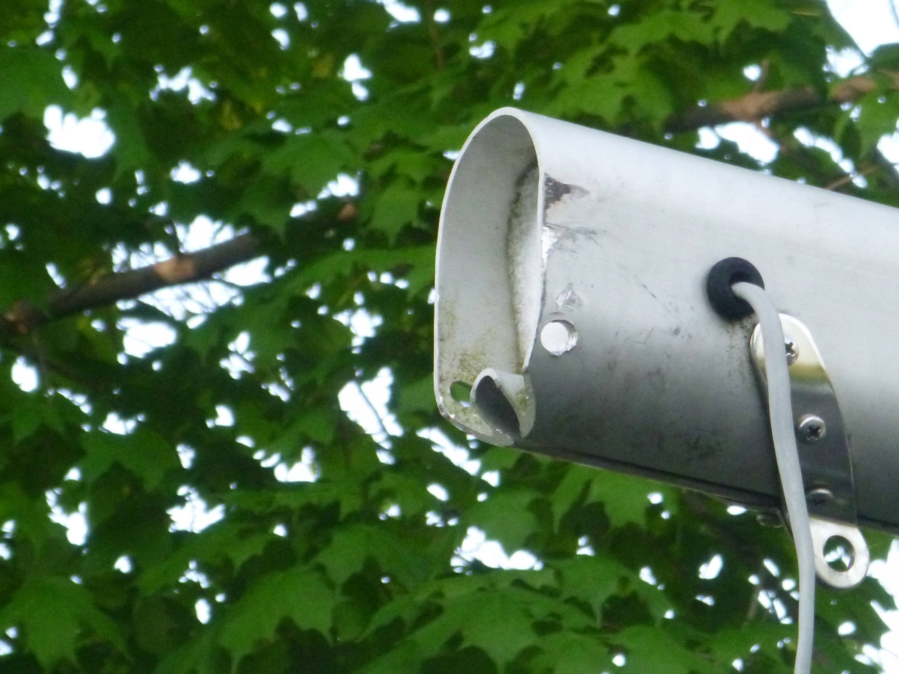

Mast foot: Take a gander at the pics of the foot of the mast...the bolt holes are extremely close to the end of the mast. I did step/unstep the mast with the PO, no problem but did not pay attention to the proximity of the holes to the mast end. Seems to me this is very weak point as there is only ~ 1/4-3/8" of metal from holes to end (actually less on port side). Is this normal, or has the mast been cut??? If cut and weak there, I suspect the fix would be to cut just beyond the holes and drill new in proper location...opinions????

Those photos of that "73" sure don't look like a Catalina-22. Never seen a keel cable on a C-22 come into the cockpit. But your cockpit floor is plywood cored, all versions are. Your mast is the typical C-22 mast with the hole at the bottom. Looks in pretty good shape also.

Whew, comforting on the mast holes/condition...thanks for that!
