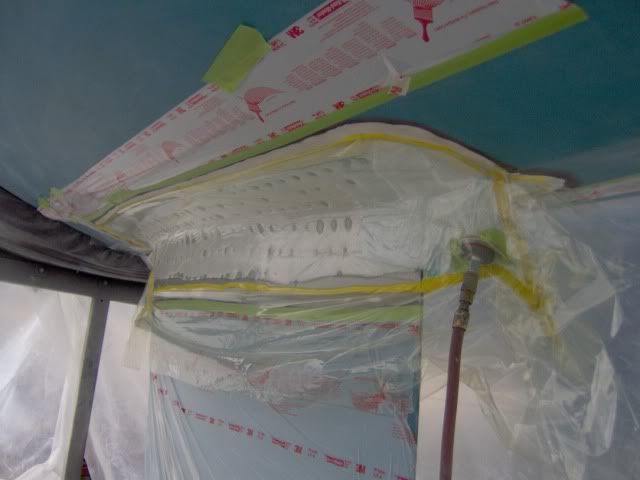

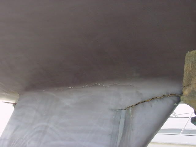

I found these Jboat keels pretty easy on SA
J105
J120
keel being beefed up
NONE of these keels fell off but they were sure getting close
All of these boats were RACED hard and they guys i have raced with think nothing of punching through most anything you could think of to the point it freaking hurts just to be sitting on the rail :eek:
