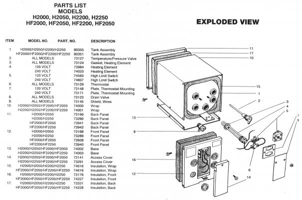

I did an RTFM
Don't see any anode listed anywhere. Here is the drawing. Have I missed something :eek: or am I correct? :dance:

Your correct, maybe there isn't one. Would seem silly to design without, but if there was it should be on the side with all the other fittings?

From the second link in post #4 above "...attach [anode] in place of the drain plug and it will help inhibit such corrosion." My heater has a gate valve with a garden hose fitting for the drain, but I suppose you could exchange for a zinc.

Valcour wins the prize!
First I am surprised PaulJ wasn't all over that. I guess if you are worried about your heater you replace the drain with the anode.
