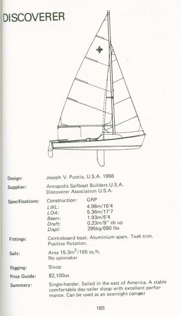

I would say that none of hte O'DAY DAY SAILER parts would be interchangable with those of your DISCOVERER, or at least not without modifications to boat or parts. Unfortunately, Annapolis Sailboat Builders most likely didn't have someone like our Rudy Nickerson (former Parts Dept. Manager at O'DAY) who stocks replacement parts for the older boats. I had a great description of the DISCOVERER that I copied from an owner, he was a former employee of Annapolis Sailboat Builders and still owns a DISCOVERER, but unfortunately.... no contact info for him (would have been a great person for you to contact!) He would be able to give you dimensions of the original Centerboard (it's not a swing-keel). I'll post a scan of a listing that I found in a book from my library.
Here is what that owner had to say:
"I worked for the Annapolis Sailboat Builders Inc. around 1973 and I also own a Discoverer sailboat (number 115). It was made in 1968. I have a Discoverer brochure that has all the dimensions for this boat. Here is some of the info regarding original construction and equipment that came with the boat.
LOA 17' 7"; Beam 6' 4"; Weight 650# approx; Draft board up 9", board down 4' 6"; sail area 165 sq. ft; Mast above deck 22' 6"
Original Price $1,975.00 with Dacron main and jib sails.
Construction
Fiberglass reinforced plastic throughout
Teak coamings
Fiberglass rudder and centerboard, both kick-up
Vinyl rub rail
Aluminum mast and boom, both anodized
Stainless steel rigging and hardware
Self-bailing cockpit
Built in foam flotation for self rescue
Molded non-skid surfaces
Standard Equipment
Roller reefing "
