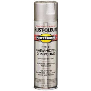

I see no advantage of the stainless steel option over the galvanized steel option for these anchors. They set equally well, the galvanized may actually be a bit stronger. Carry a can of galvanizing paint and if some spots look thin or scratched, touch it up. Done - no rust to worry about.

I use this on my trailer with great results

A bit off-topic, but I use this or the Ace brand on my prop each year for anti-fouling. Works exactly like the $30 stuff and it is a larger can. I get two year's application from one $7 can. I've used this for 15+ years.
Wait! What?
Galvanizing will antifoul protect? How did I not know that?
