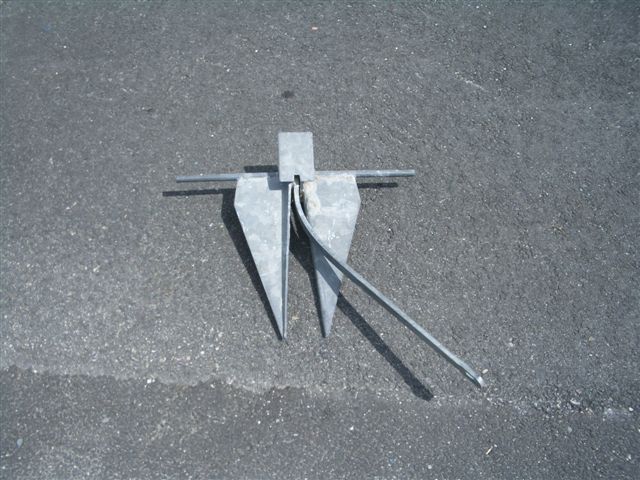

Attached is a pic of my Tradition Danforth which held on a very wind (Gusts to 45) night but was damaged. This anchor did better than the Delta by far.

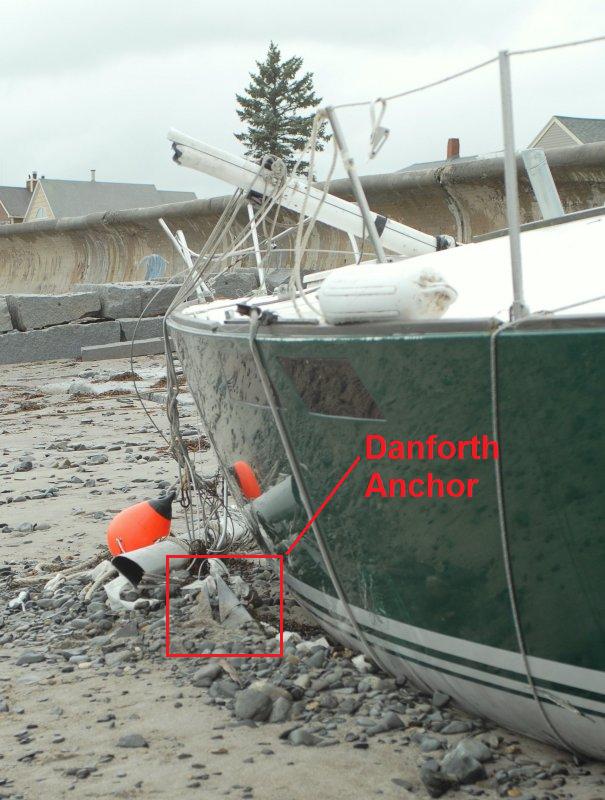

Perhaps you missed a post I made from this past fall where a Pearson Flyer dragged a decent sized Danforth onto the beach when he tried to anchor it off Plaice Cove (pictured above).
