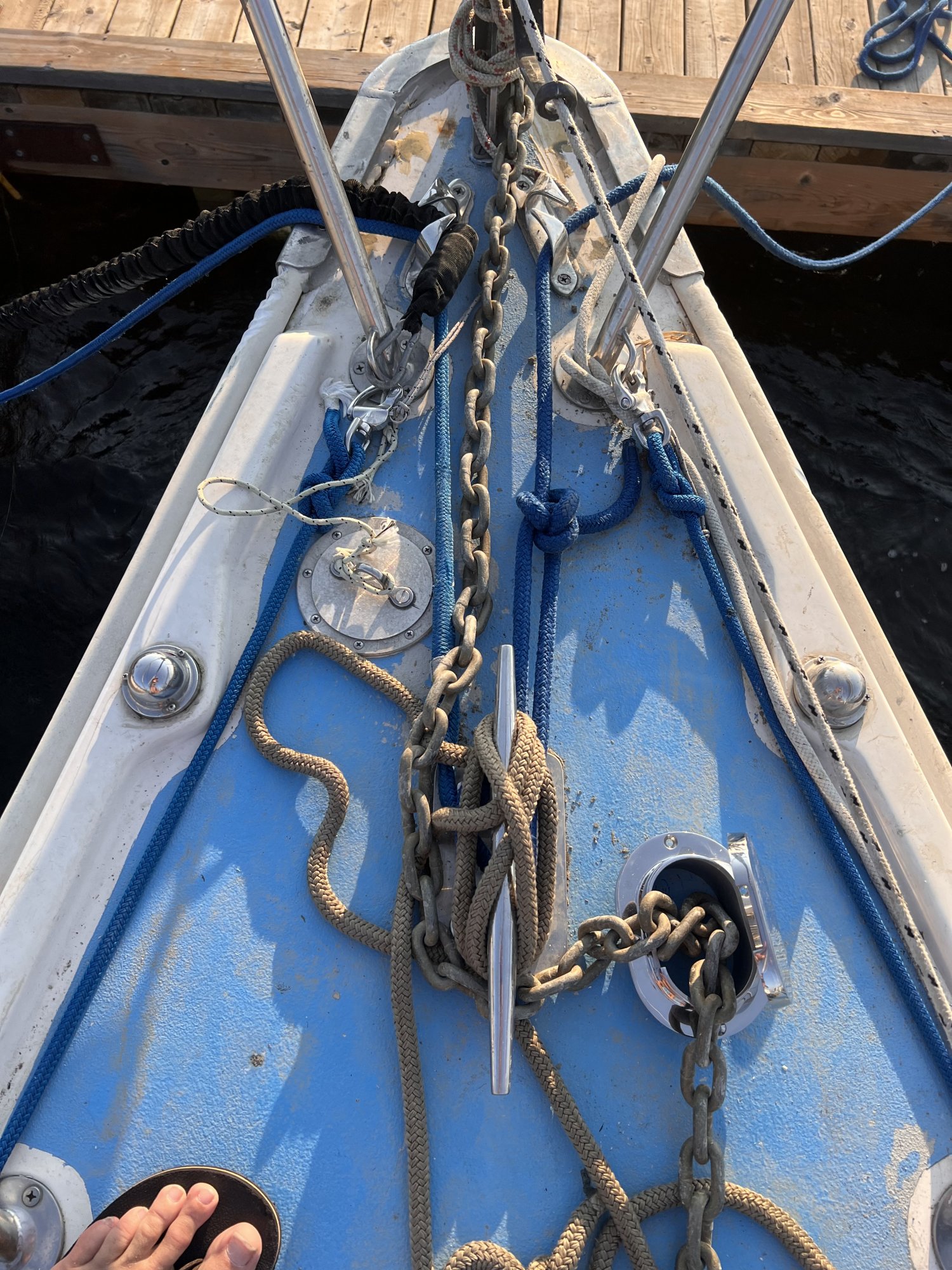

With the admiral helping out more on the boat, we need to find a better solution to help anchoring.
At the moment we are about to cut a big hole on the fore deck to install a deck pipe to easy with the chain and rode. I plan to install it close to the main cleat to have an easy time clearing the rode in place.

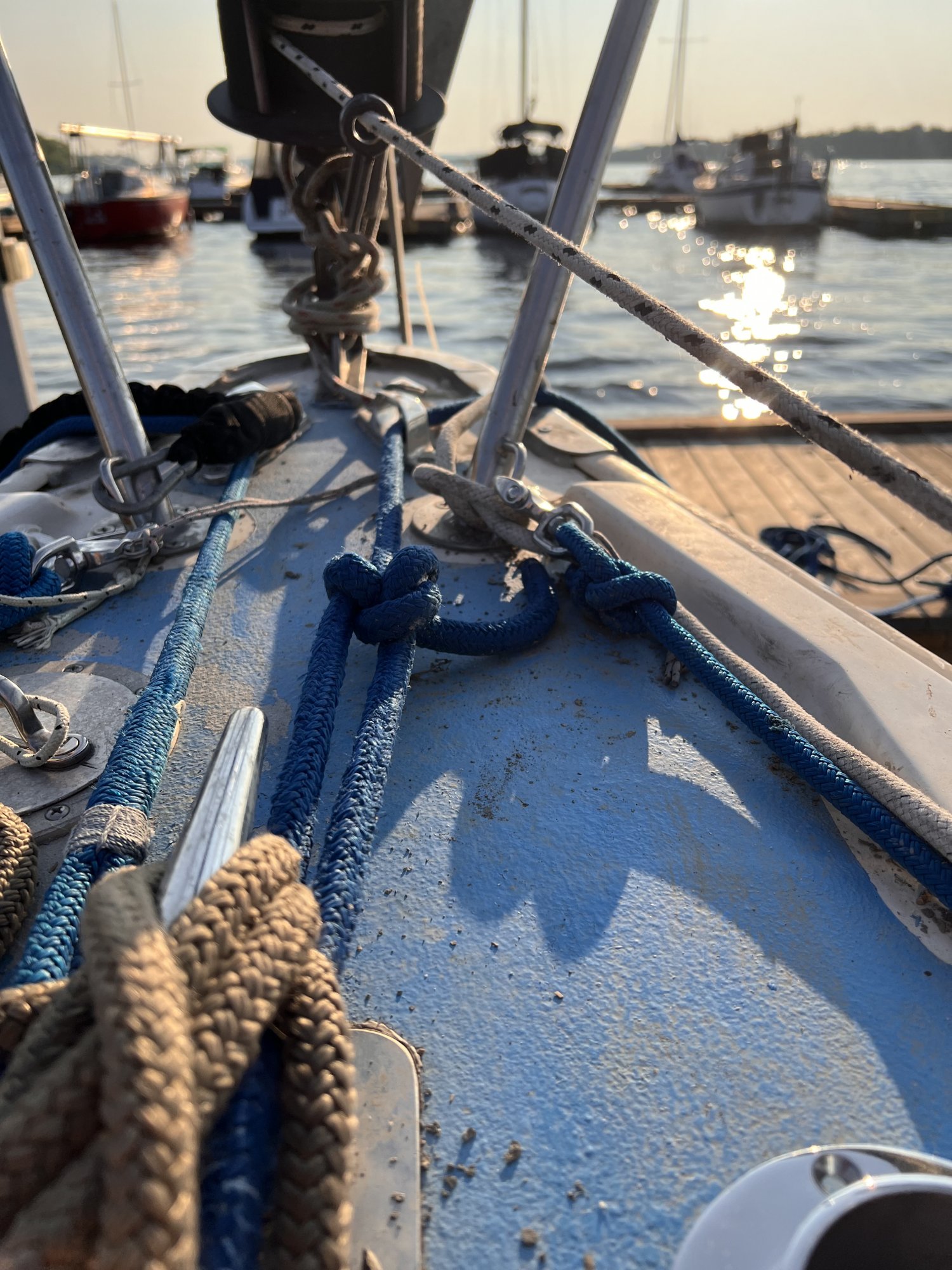

My admiral’s concern is that the anchor rode can move port or starboard from between the pulpit and it bothers her, so I’m looking for a solution to get the rode to stay near the center.
My chocks are too small to allow the chain to go through, let alone the chain to rode connection.
I was thinking about simply installing an anchor retrieval ring near the bow, to the furler/forestay chain plate/fitting.
What do you all think, am I overthinking this, is this a good solution or should I look for something else?

Sounds like you need a new chock or bitt on the bow that is big enough to handle your chain. Make sure it's placed so that the anchor rode leads fairly to the cleat. It looks like putting it a touch off to port will allow the rode to miss the forestay and the port chock. The existing starboard chock is closer to the forestay so there's less room on that side.
Or maybe downsize your chain & rode so it fits in the chocks you already have. What do you have now? What you show in the pictures looks pretty hefty.

Looking at your bow, I'm wondering if using a bridle might work. How much chain do you have and how much rode? Are you usually running with all your chain out and then the ride is left on deck and into the water?
I don't see a bow roller. That might be a good addition. But from the looks of your bow, that would be a big job. I'm not sure what an anchor retrieval ring is.
I'm not seeing how putting the deck pipe is going to help with keeping the rode from moving side to side. It seems to me you either need a bridle or a point of fixation at the bow - bow roller for example.

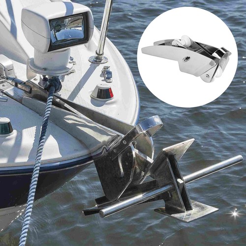

Would something like this work?

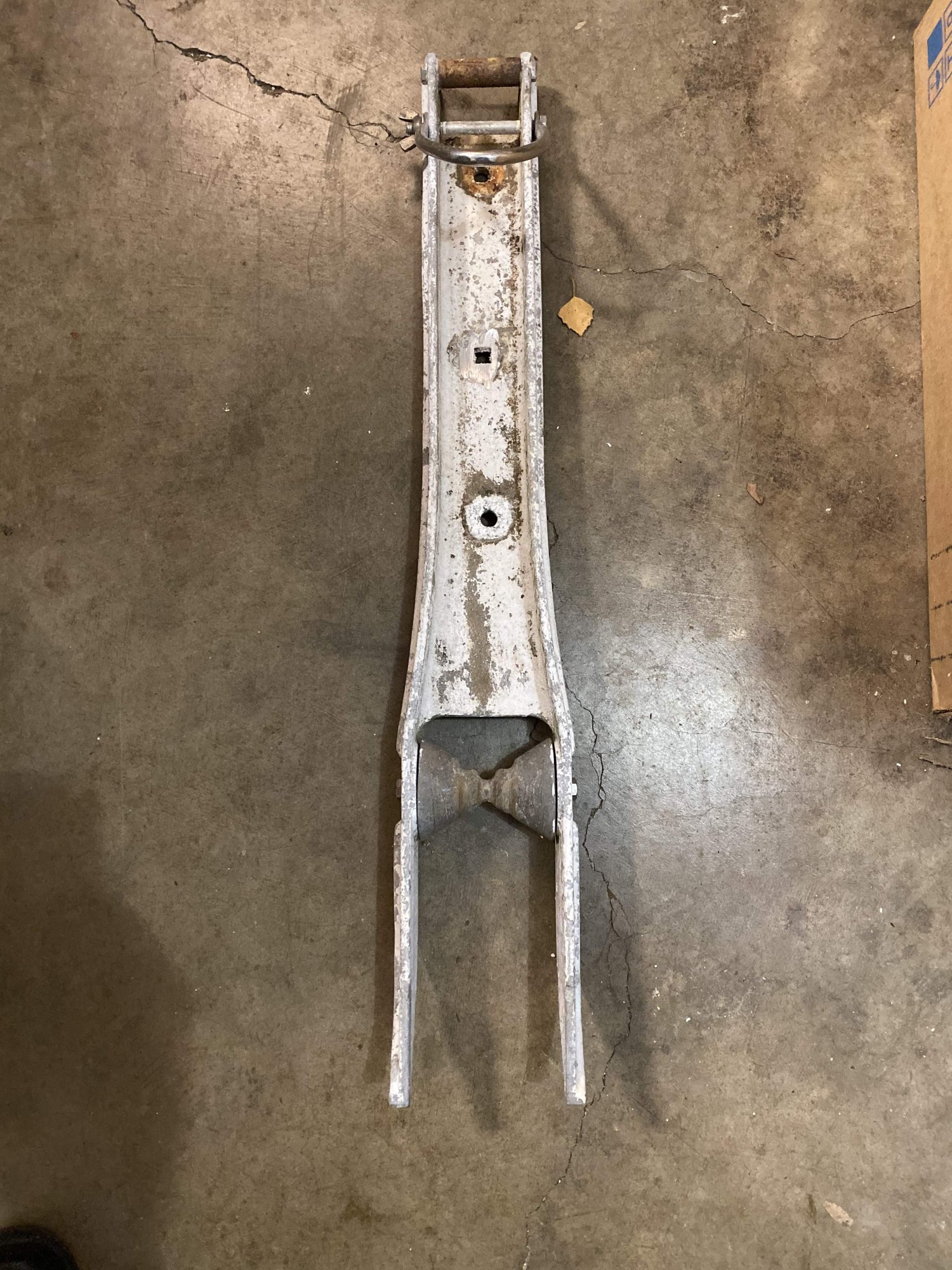

I had this on my bow. It is narrow and might slip to the side of your forestay. Needs a new roller.

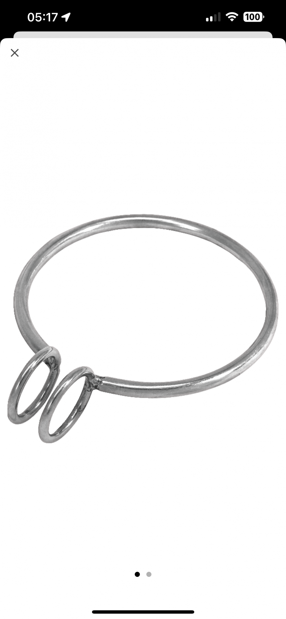

An anchor ring is used to help pull up the anchor, it basically works a bit like a pulley, you slip it on the rode and attach a fender or float then back up the boat to help raise the anchor

That anchor ring isn't going to do the trick. You need a way to keep the rode from working back and forth at the bow. The original design was clearly using your fairleads in the bow but they aren't working for your current anchor setup.
You should take a good look at the piece John showed above. If it fits and your chain can go through it - that would be a good fix.
