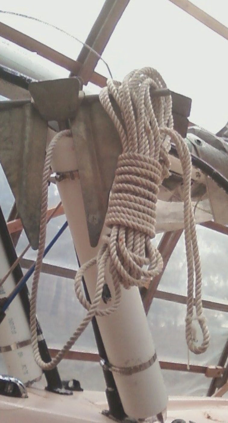

Here is how I used to store my anchors on my McGregor 22. It would look better if I had used black PVC pipe. Later, I modified this by putting an endcap on the bottom with a weep
hole drilled in it and I would store 10 feet of chain inside the pipe already attached to the anchor. It’s a much better set up with the chain already attached and stored inside the pipe.

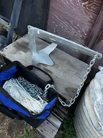

We simply tried loading the anchor to get prepared. I was surprised at how arduous it was. Just getting the Bruce inside to the storage area was a task. Then it didn’t fit. A pail, not a chance. Way too large to store underneath where we wanted it. The pic below is our current setup. We’re going to focus on the Danforth mounted like rgranger’s above.
I was asked, “are you going to be ok with a wet anchor line on board”. No, especially sitting in a pail. Once it gets used, it will definitely come out to be dried. We are now using an inexpensive heavy tool bag. It’s less arduous and fits.
8,189
That anchor is really meant to live on a bow roller. It’s an awkward shape to store anywhere else.
