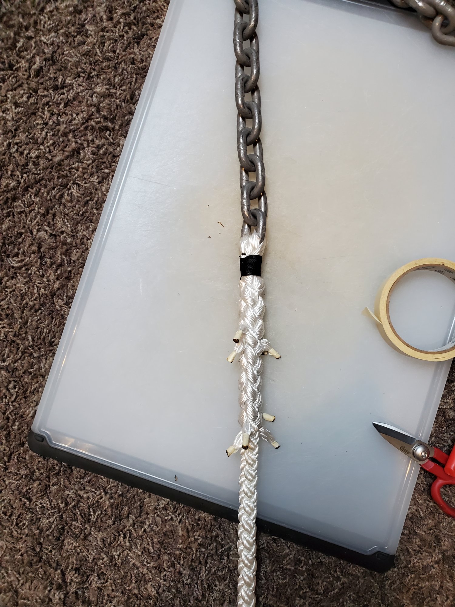

I used a mixed rode with a windlass in my last boat for about 13 years, the only issue is to make sure your splice is gradually tapered - otherwise it can hang up a bit when transitioning from the capstan to the chain locker. The capstan has an inner groove with ridges to grip the rope and it didn’t cause excessive wear. I used a Lewmar Ocean series 1 - not in production anymore but the capstans are probably unchanged over the years and models.
Edit: I’ve seen YouTube videos about spicing and would suggest making the taper longer and more gradual by adding an extra tuck with reduced (partial) strands. e.g. (with 3-strand rope) use 2 tucks with 1 strand removed then 2 tucks with 2 strands removed.

- We have a mix of chain and nylon 3 strand. The splice probably wasn’t made with the care Captain Larry-DH recommends. I do need to help the splice into the anchor locker to keep it from bunching up.

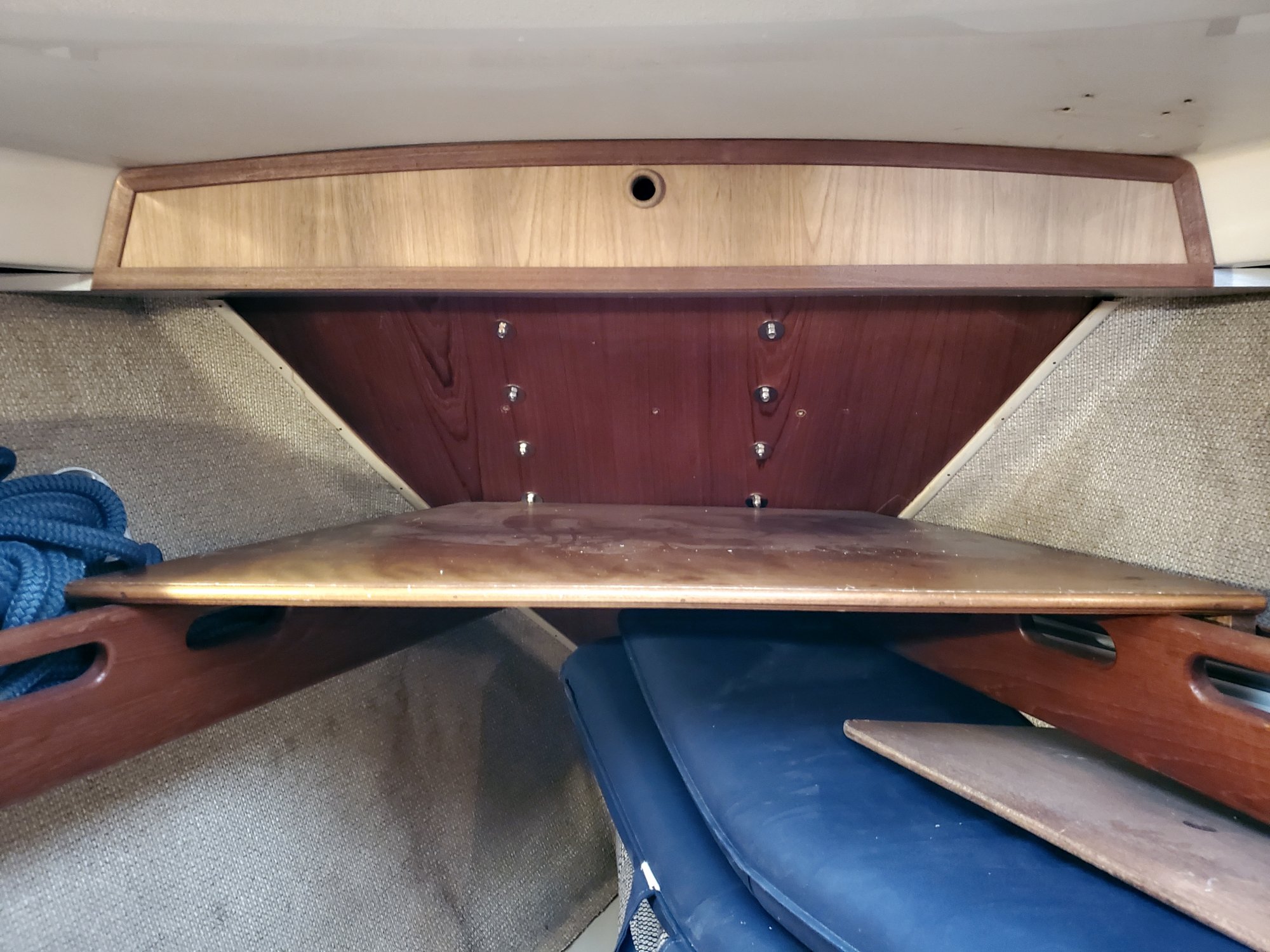

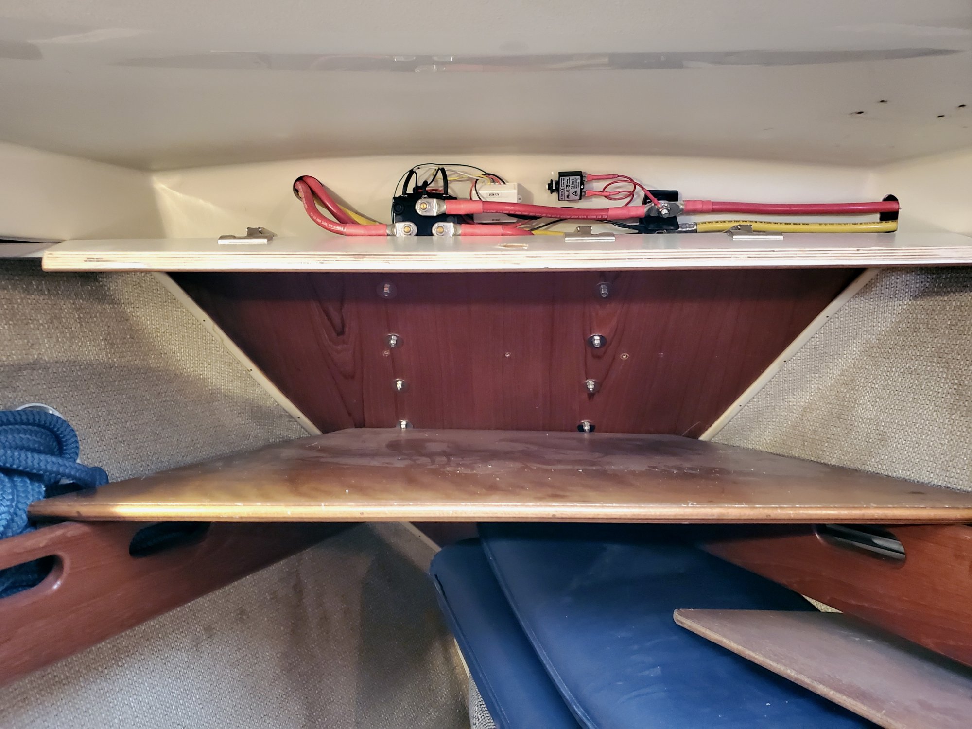

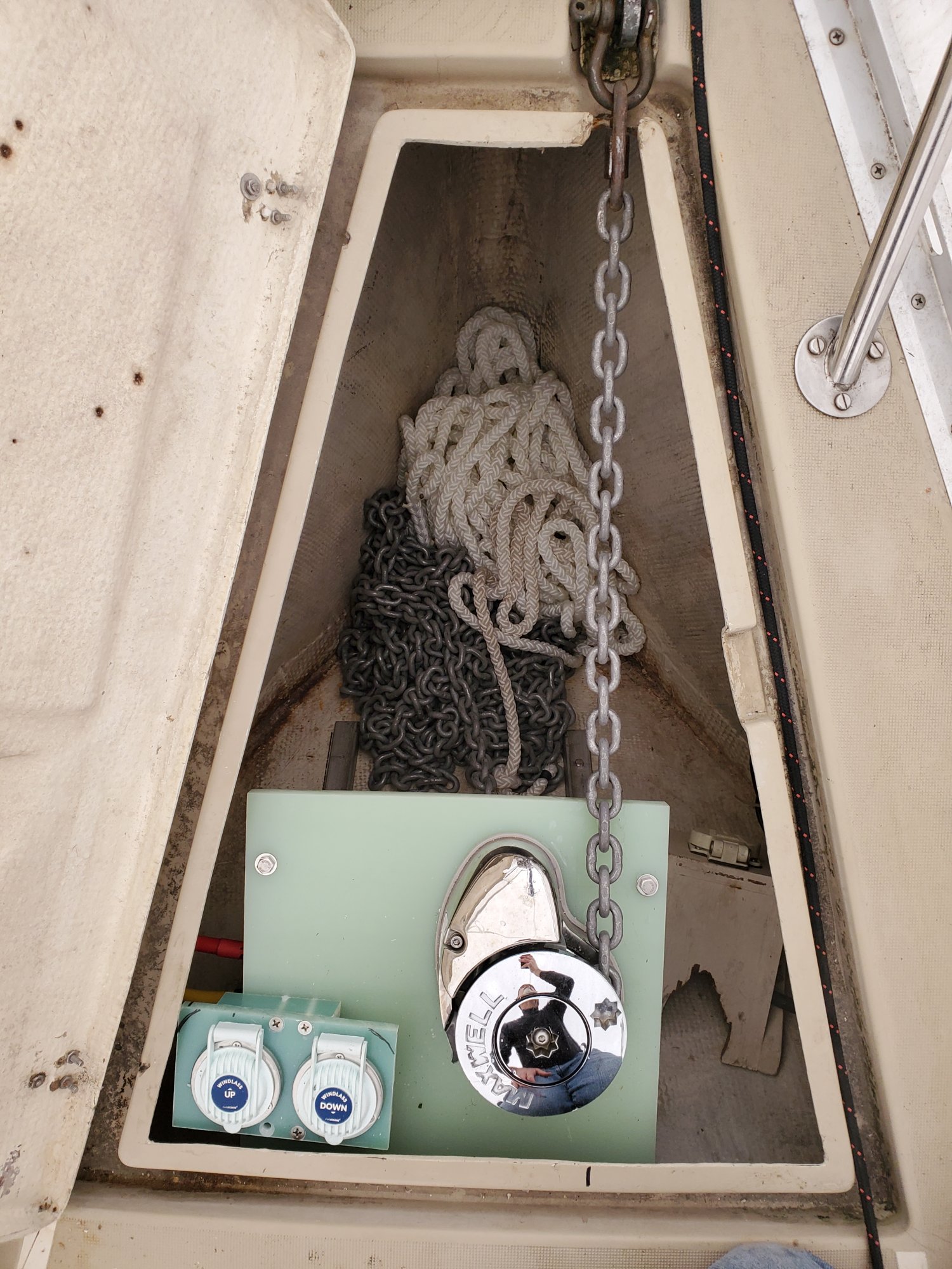

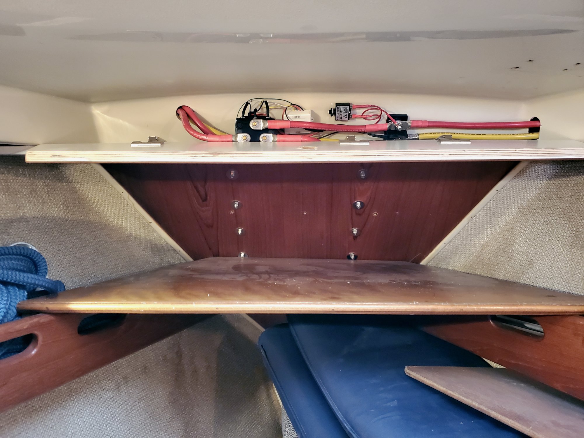

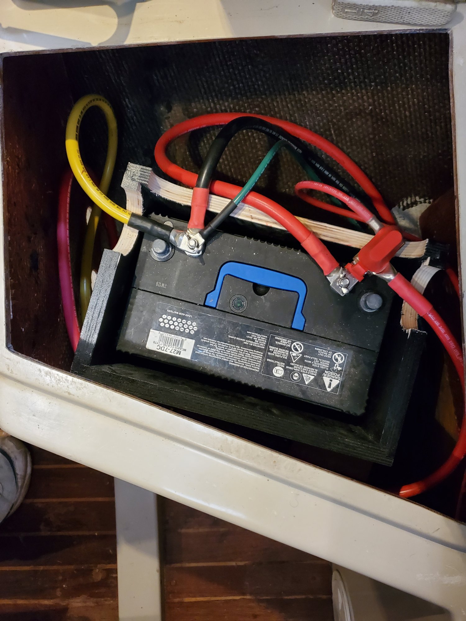

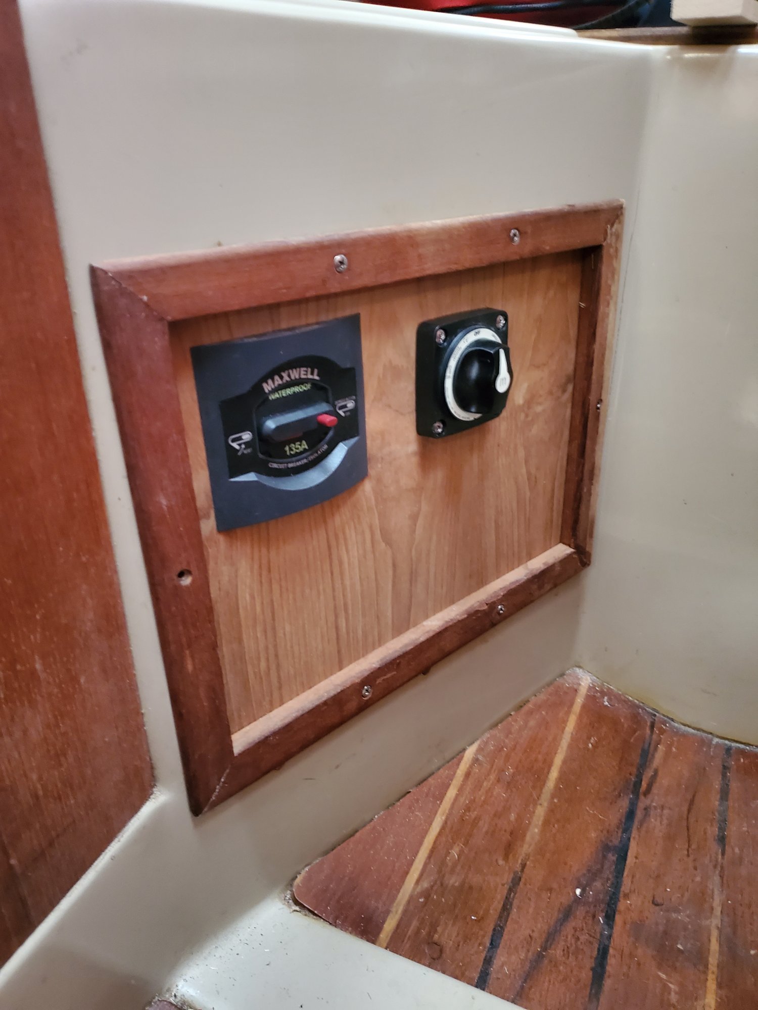

I installed a windlass on our boat over the last winter and having just completed a two week cruise where we anchored 11 nights, I can say it is one of the best improvements I have done. I purchased our windlass used on Ebay and replaced the seals and fluid in it. I also replaced our anchor rode with 60 feet of chain and 250 feet of rope. The Lewmar windlass handles the rope and chain very well and we had no problems deploying or retrieving the anchor. Lots of our anchoring is in water less than 10 feet deep in protected bays, so I also made a bridle for when we are only on the chain portion of the rode. Photos were pre-launch when there were still a few wiring tasks left. I plan to partition the anchor locker to separate the chain from the rope after this season.

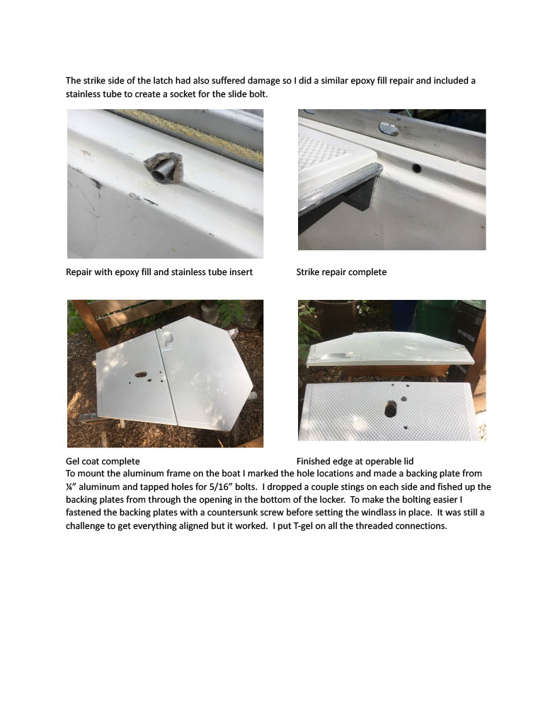

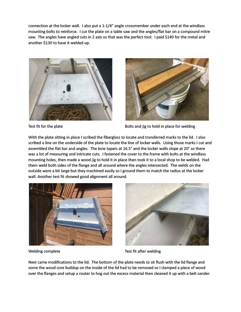

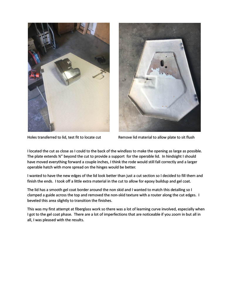

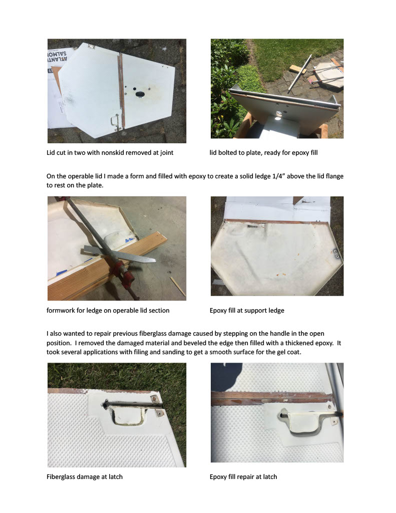

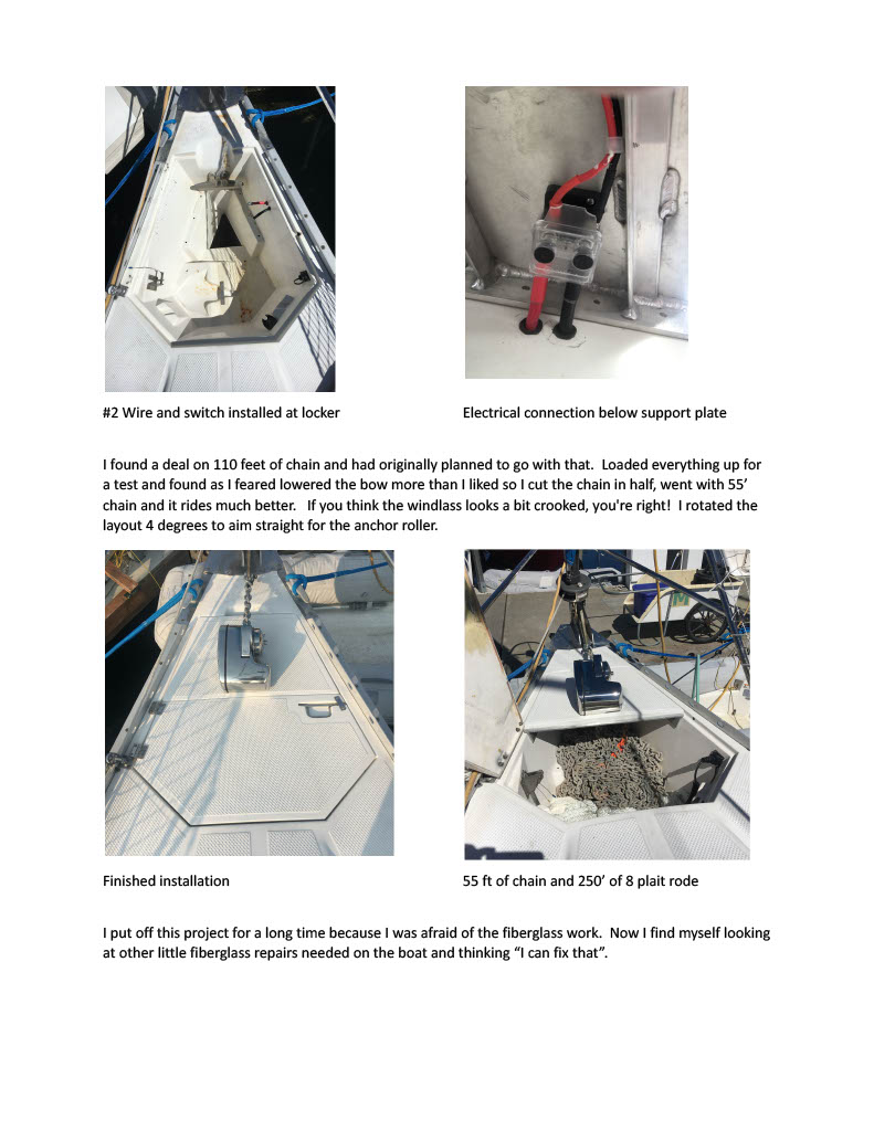

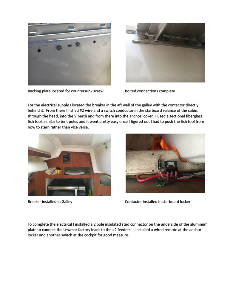

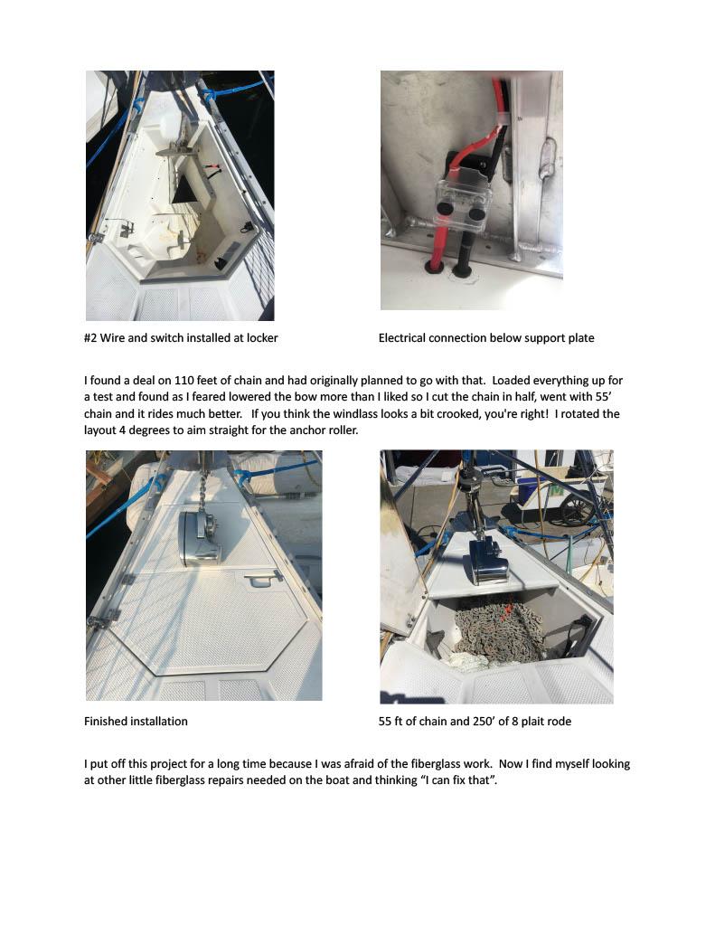

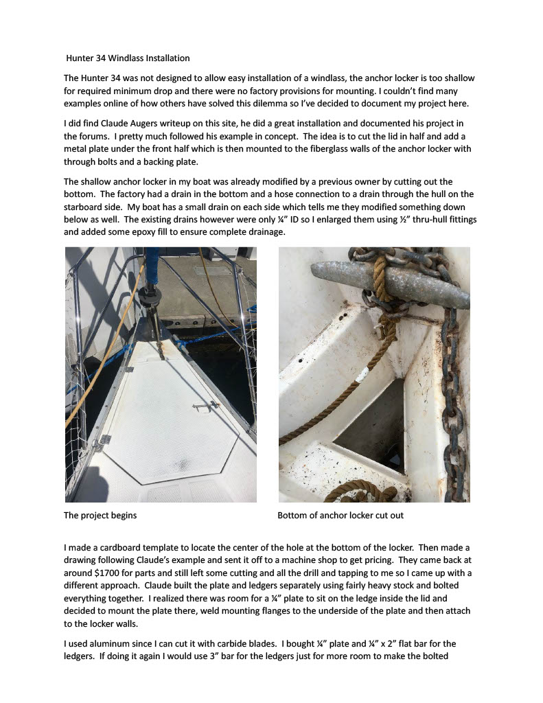

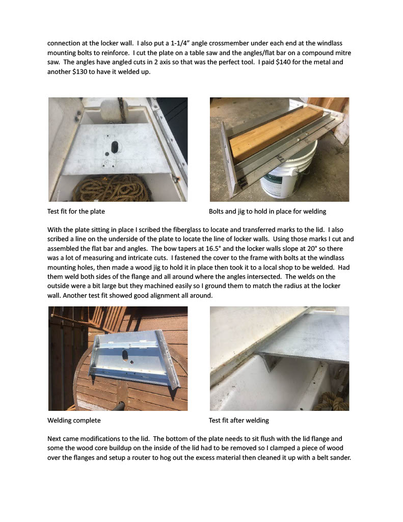

Hi Jerry: I installed a windlass on my H34 which I believe has a similar anchor locker to the H31. They are shallow but the PO on my boat cut a hole in the bottom and revised the locker drain to be direct discharge from the cavity below. I also decided on the horizontal model to gain a few extra inches of fall. It was a big project considering the fiberglass work to modify the locker lid and getting a support plate fabricated. I put together a pdf that shows the direction I took but it is too large to download here, I found a program to convert to jpegs but it split into individual pages.
great info. Thanks for sharing. I’ll download the images and if any problems will send u a PM. Yes we have similar anchor locker hatches and will have to do the split, glass and support work. Can you tell me what brand windlass you went with and how’s it performin? Also all chain or chain/rope combo?

Windlass is a Lewmar 1000 w/ 55 ft of 5/16”chain and 250’ of 5/8” 8 plait rope and 35# mantus anchor. It has been working out great so far. 8 plait is amazing, falls like limp spaghetti.
1 tried 110’ of chain at first and didn’t like the waterline on the boot stripe.
