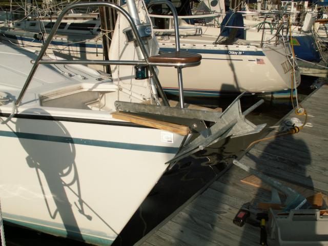

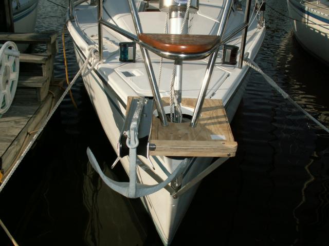

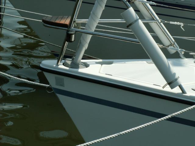

I have looked at lots of boats and pictures trying to come up with a design for a bow roller, on deck anchor storage and a windlass. I contacted Hunter and was told that my boat was "never designed to have one"; end of story. I hate to say it but my design effort was abysmal. My design called for a SS platform extending off the bow, keeping the anchor locker and door intact and installation of two rollers. To me it looked like a kludge. See attached pics.
I have turned the design/mfg job over to a local marine builder/fabricator. He does great work but I'm sure it won't be cheap. I'm in his work queue and hopefully will see "his" design ideas this week. He has promised I will be on my way south on Nov 1 as planned. I just hope it is with an anchoring system that won't require another rotor cuff surgery.

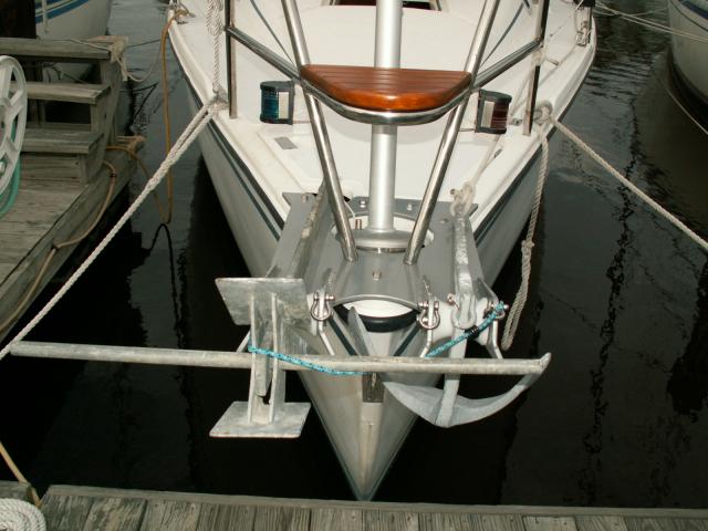

Roman,
Here's a picture of the bowsprit on my recently purchased '89 V32. If you have one made up, I can highly reccomend this style- it works great.

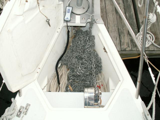

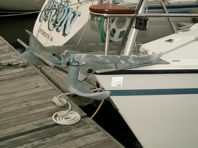

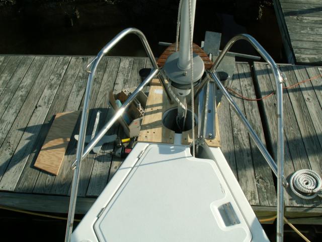

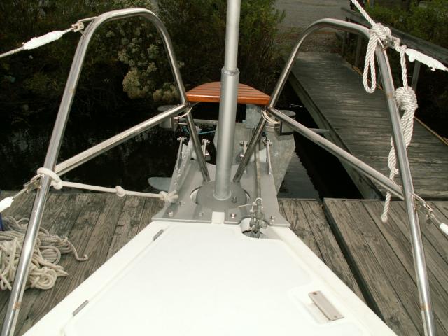

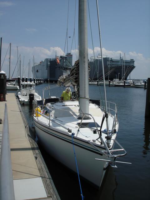

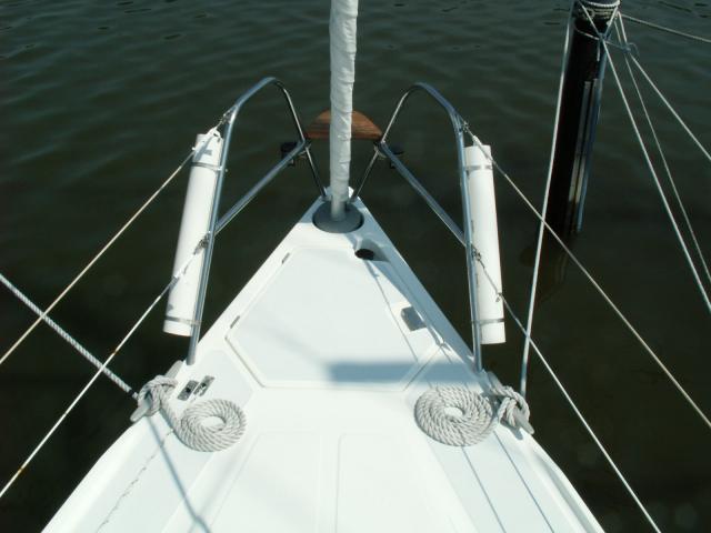

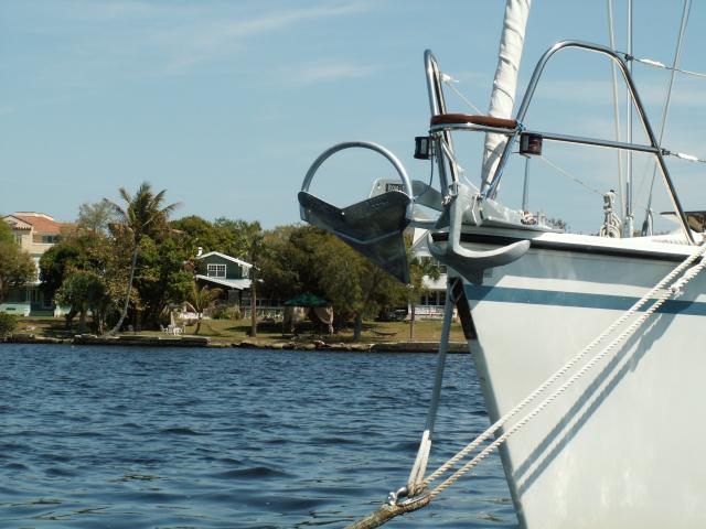

Holy cow...forgot all about my previous post until now. Attached are photos of the project nearing completion over a year ago. The last photo shows the addition of the Rocna anchor in March 2010. The Danforth moved to the the aft lazarette for stern/emergency anchoring.
The windlass has been a great addition to the boat. It works great, with one minor drawback. The chain must be hand fed forward to keep it from piling up and jamming the windlass. A deeper anchor well or a chain chute through the vberth into the compartment below may be the answer in the form of another project.
