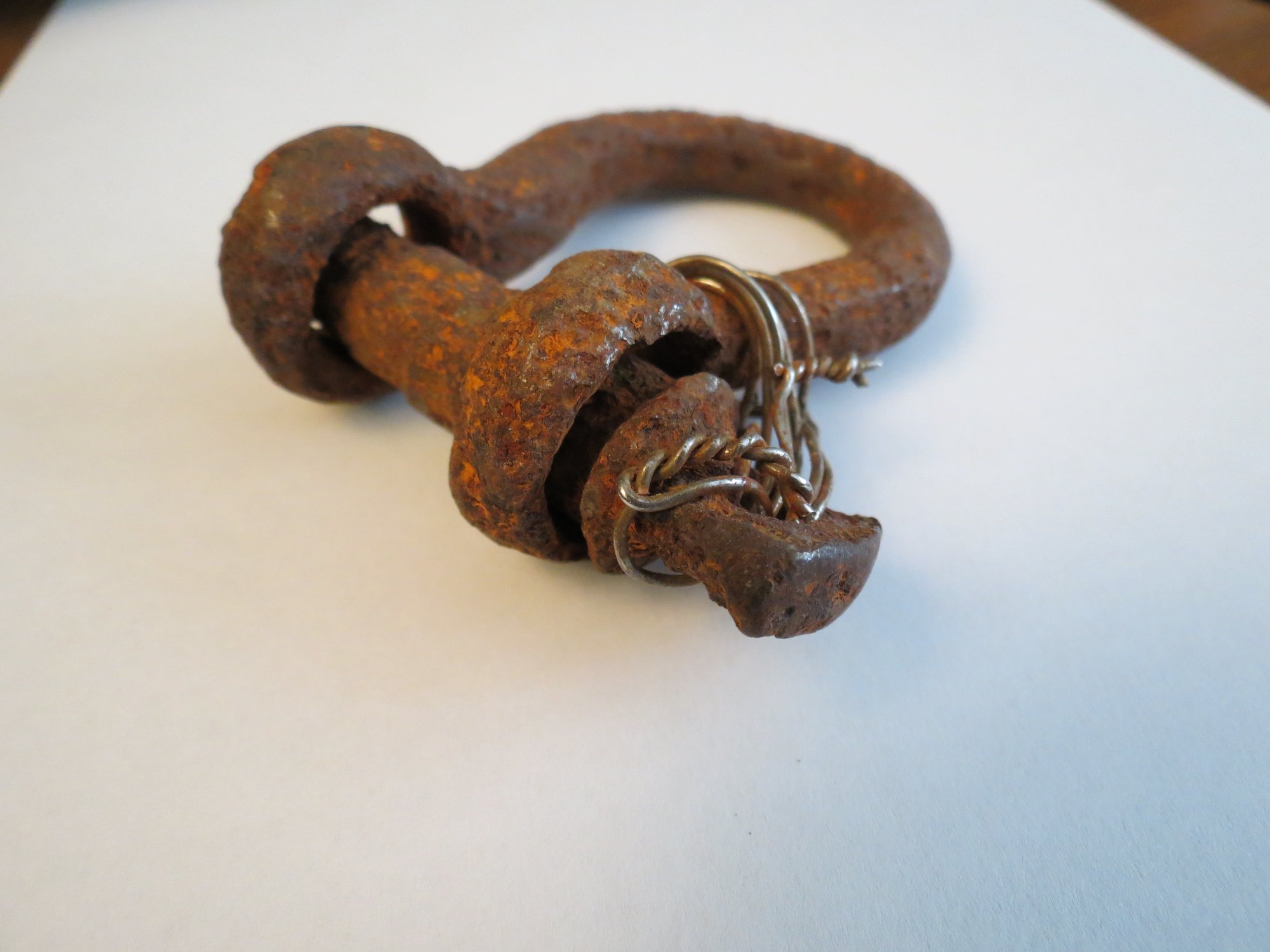

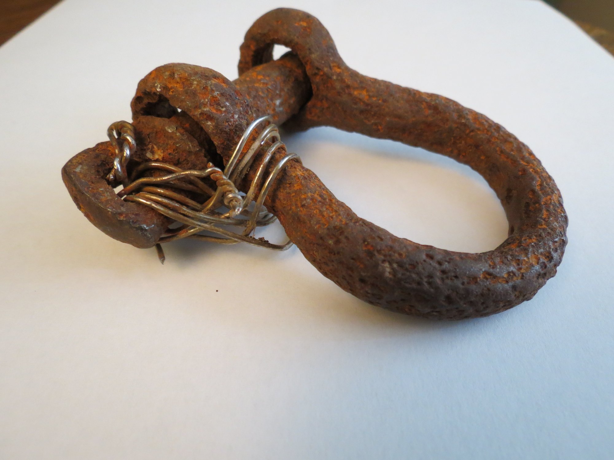

Always buy American made forged shackles like Crosby brand.
DO NOT BUY CHINESE SHACKLES!!
And always use two loops of safety wire.
This one was in service on a mooring for about 3 years.

Yea though I had a photo but guess not. After 7 years the only signs of rust are on the pin….. and it’s not flaking or anything like the one Rich has a picture of. The rest looks fine. It’s a wll 2.6t….. I am a “why not change it” guy especially when it’s only a couple of bucks. And we always anchor. Just thought thought I’d see what others are using…..
