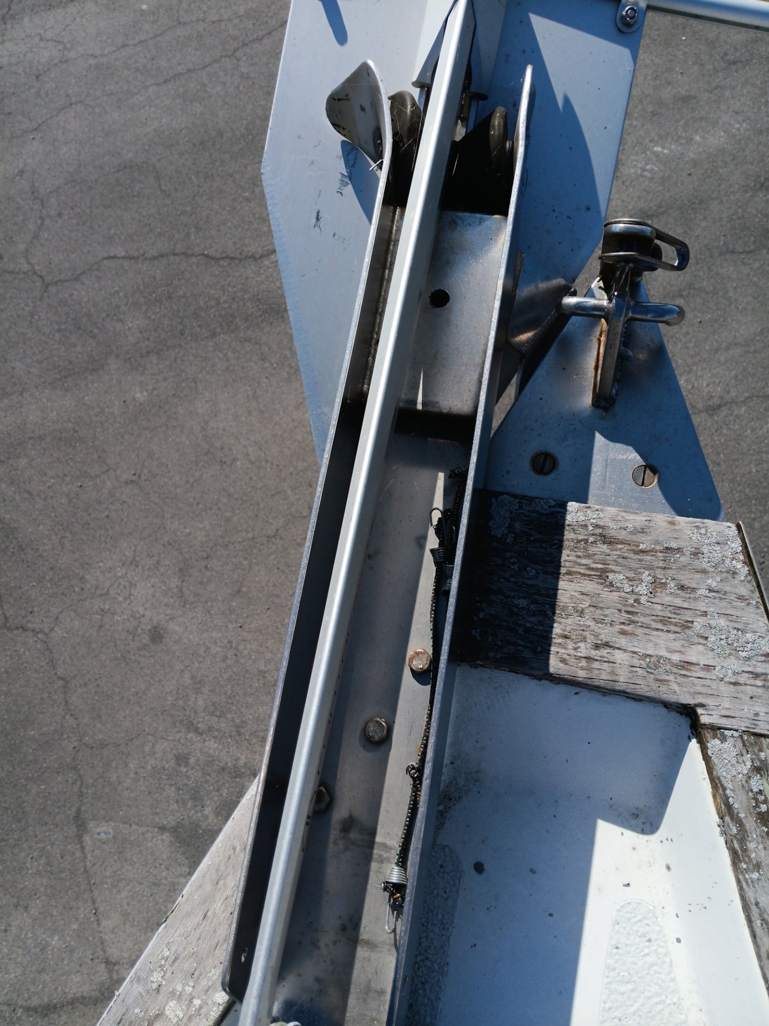

Hate to be in a rush but I was reading some past threads here and elsewhere on anchoring last weekend and decided I wanted to check out my options again. I know I need a new anchor roller and anchor. I was planning on putting that project off for another year or so since I'll be marina-hopping here on Lake Ontario for at least another year but I'm still leery of my existing setup. I have no experience anchoring and how the boat will behave at anchor other than all I've read over the years.
Here's my dilemma. I went to Mantus' web site and found that they have their anchors on sale right now for considerable savings over all the anchors I've been considering. My problem is how I'll need to modify the bow area to allow it to fit and also be sturdy enough for anchoring in foul weather. The second issue is do I buy the Mantus M1 or M2? I've decided the 35 lb. anchor should work for me. I prefer the straighter shank of the M1 but am concerned about the rollbar interfering with the forestay/furler. The M2 might mitigate that but the high curve of the shank may make it harder to position the roller to get a clear path forward of the bow and still keep the tip away from the hull. I also am a little concerned with the M2's soft mud performance that I've seen discussed several times.
I've attached the best pictures I have right now of my bow layout. I can't create a template and go check it since the boat is buried under about 3 ft. of snow and I don't think I can even get into the marina. Sorry for what I do have. I thought I had taken some more detailed photos of the whole layout but I can't find them on my phone or computer so I'm stuck with these.
I know someone is going to ask so I'll mention it all up front even though it's not my intention to get into all these other details. I have a Morgan 321 (11,000 lbs displacement), I plan to sail around Lake Ontario for at least the next year or so. Intentions, once the upgrades are mostly done, is to check out LI sound and the shore of Connecticut/Rhode Island. Longer term into the Caribbean. Currently have a Fortress FX-16 on 20 ft of 3/8" chain and 120 ft of 1/2" 3-strand. Planning on 100 ft (min) of 5/16" HT chain and 200 ft of 5/8" 3-strand.
What are your thoughts and concerns? I plan to get my order in for the anchor ASAP as the price reduction would really help with all the other work I plan on doing this year. Even if I don't get it fitted yet, at least I would have it handy.

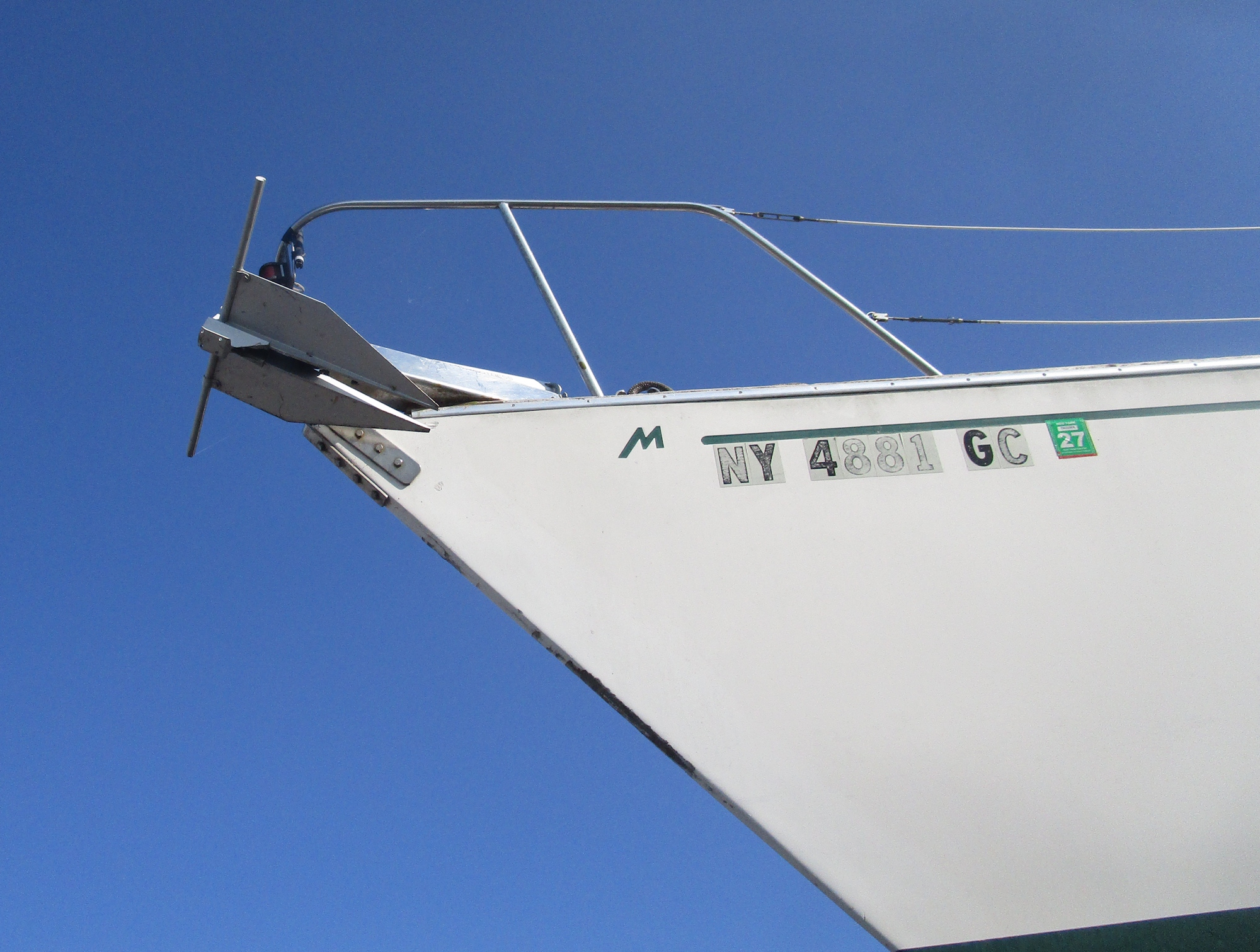

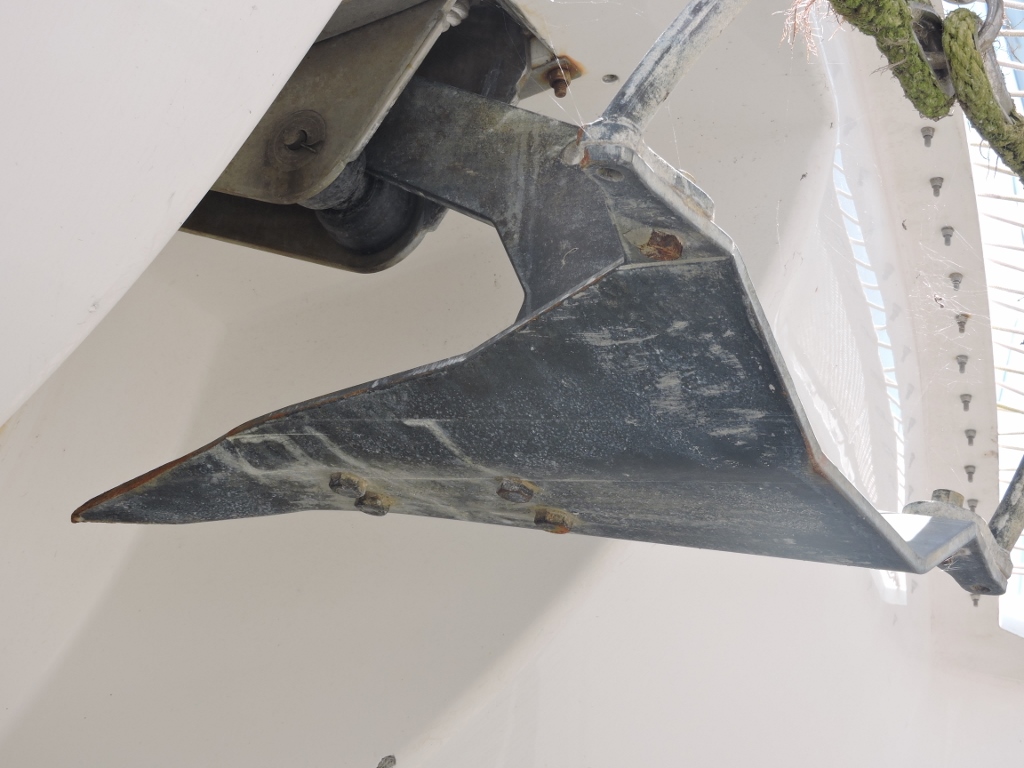

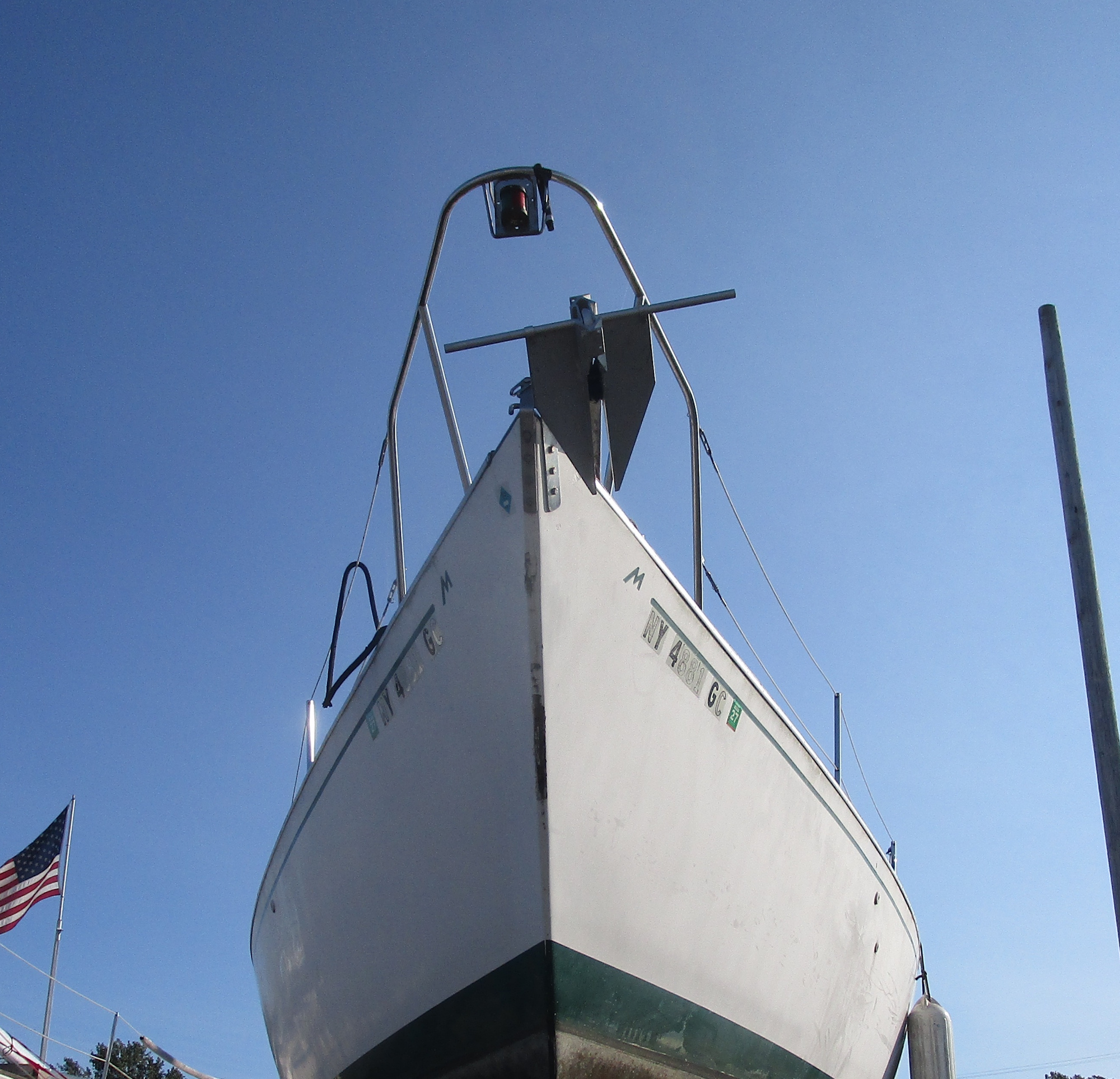

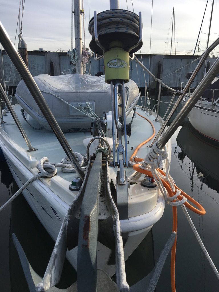

Here are images and videos of how I solved the problem of the anchor shank coming in contact with the furler. The anchor is for a 44 ft sail boat that was installed on now my Catalina 36 sailboat. But I am sure glad that I have the added comfort knowing it's holding power with 50 feet of 5/16 chain and 250 feet of 4 strand 3/4" rode. I use a weight that I slide down the rode about 10 feet to avoid keel wrap with the rode.
If you have never anchored, ask an experienced neighbor to go out with you and show you how.
After 3 times of anchoring, you can perform flawlessly and with confidence. It is important to learn to anchor in case of emergency.

That Fortress is quite a bit forward of the stem. I gotta think the Mantus will fit.
Joe is right. The trick is to avoid contact. On my boat I installed long link plates on the furler to raise the drum of my ProFurl LCI32.
Your photos do not show your furler, so impossible to tell about your setup. But both Joe and I have identified a possible issue for you to deal with. Good luck.

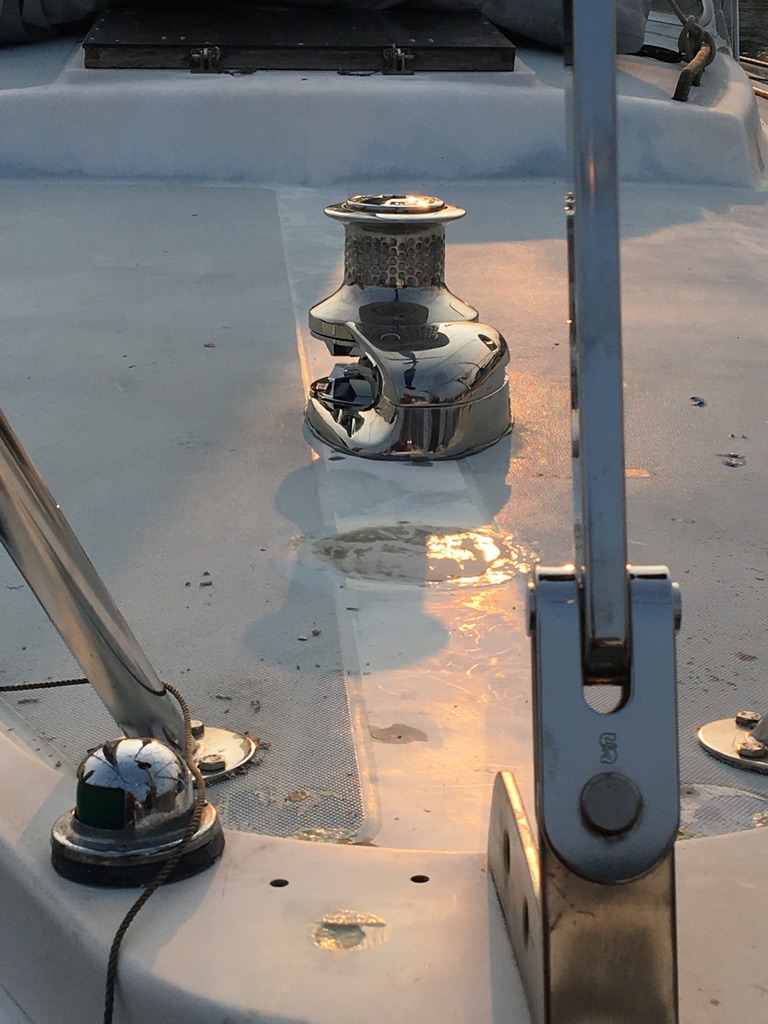

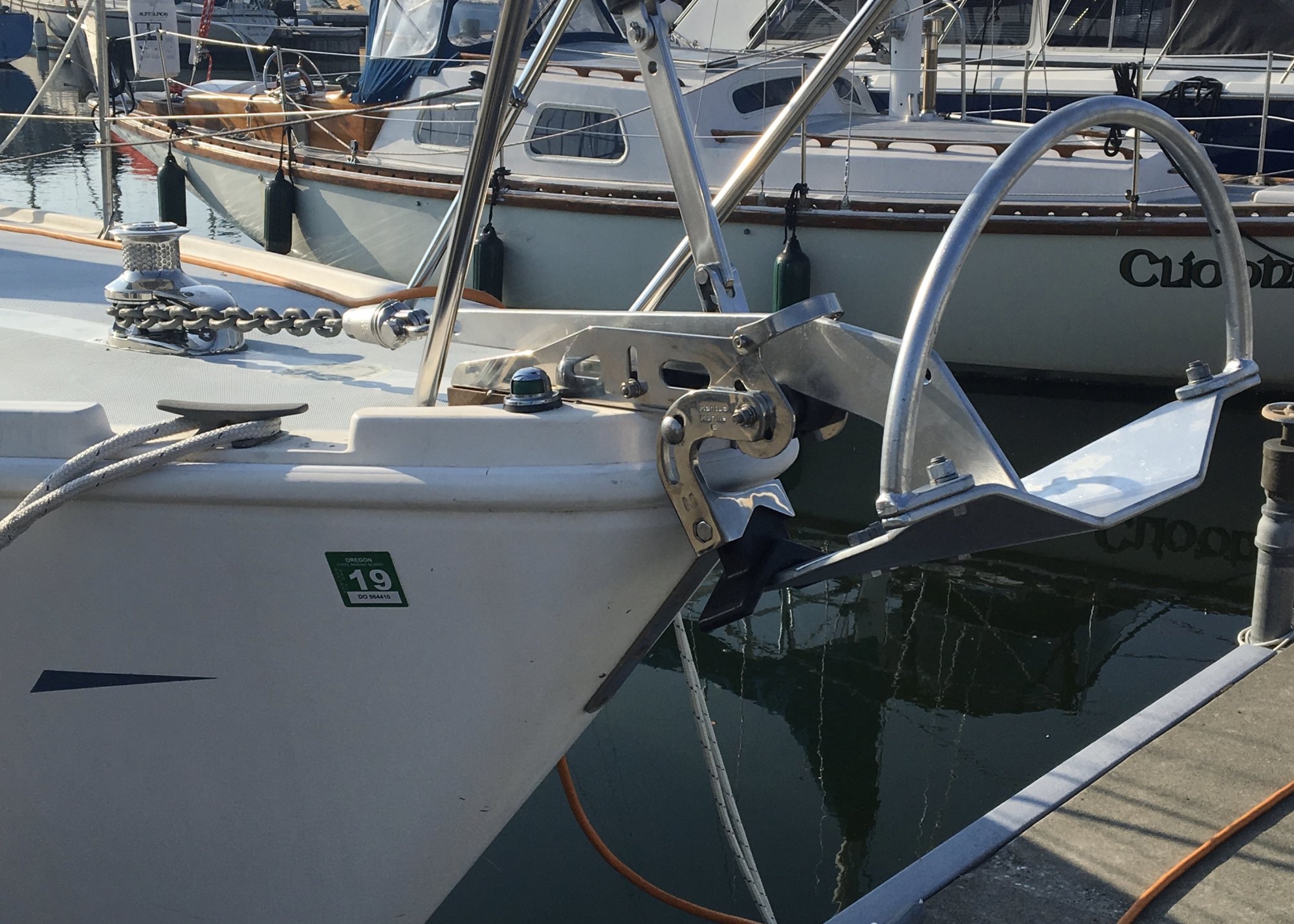

I was where you are, Trapper, once. I met Greg (owner of Mantus) at the Seattle Boatshow. He was sharing his ideas on the Mantus anchor system. I liked the ideas, and I bought the M1 at 35lbs, the bow roller, and the swivel in Jan 2018. I acquired a Lewmar V3 windlass from SBO, along with 115ft of chain and 250 ft of 8-plait rode.
They replaced the 33lb Bruce and manual windlass that came with the boat. I tried using the system on the boat, but I found the manual windlass slipped, and it was a lot of work. When the windlass failed, the 33lb Bruce and 40ft of chain required back-breaking effort to pull up from the sea floor.
My Original Bruce anchor setup.
The Mantus/Lewmar upgrade. I aligned the windlass with the location of the new bowroller.
The bowroller with anchor guard is terrific at holding the anchor off the bow.
In a sand/mud bottom 20ft depth plus a 9ft tide, I deployed the Mantus with a 7-1 scope and held firm for the night when 60mph winds blew in over the sheltered bay at Port Ludlow, WA. I have confidence in my anchor system.

JoeWhite and jssailem, thanks for the pictures and encouragement. It gave me some things to think about and clues to how I want to proceed. I know I need to move my hawse pipe further back from the stem so the rode can fall closer to the center of the chain locker. I also planned to change out the centerline cleat to a 12" over the 10" that's already there. I also have two bow cleats and chocks that I can run snubbers through, if needed. I think I can avoid hitting the furler drum once I choose a replacement roller. I don't know if you noticed it in my crappy picture but the current one is bent up and the roller itself is in chunks. I don't know how both the surveyor and myself missed that pre-purchase.
Stu Jackson, thank you for the tip on re-positioning the furler a little higher. Let's see once I get the mast back up. Sorry for the uninformative pictures. I wish I knew where the one's I really wanted/needed went to.
