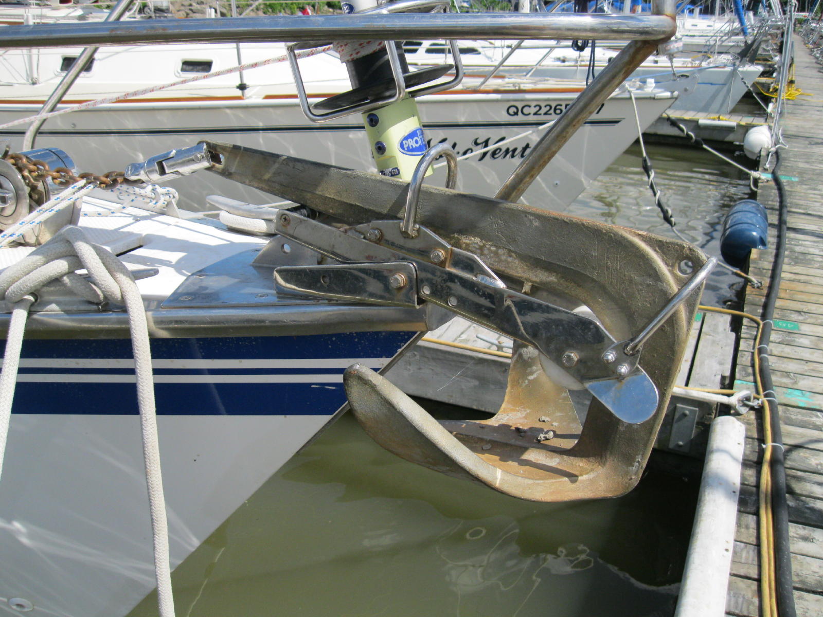

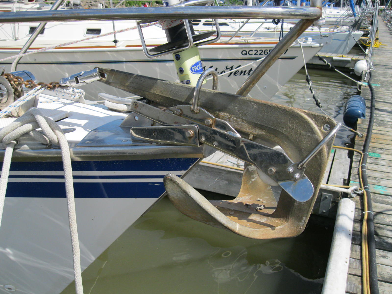

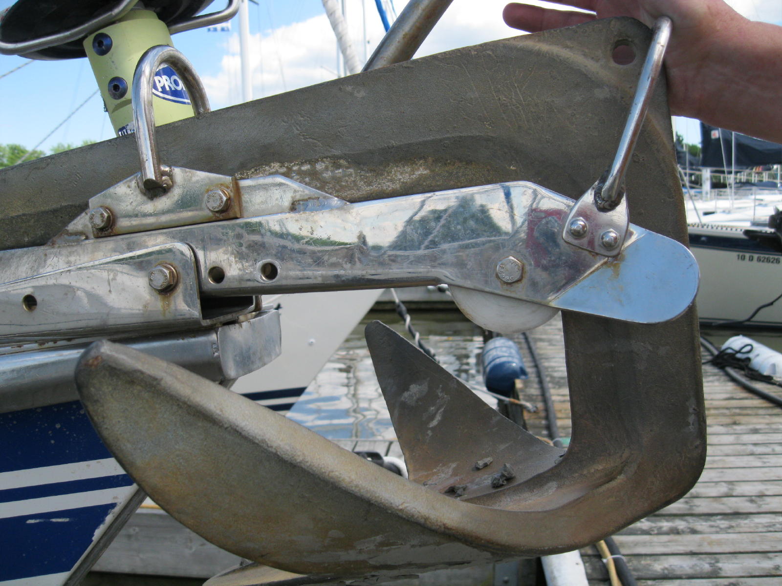

My solution was to make the anchor roller swivel up and down and add another bail close to the furler. The swivel helps deploy the anchor by carrying its weight down as soon as I hit the down button of the windlass, and the 2nd bail close to the furler prevents the chain and the shank from hitting the furler. Been working great for several years.
24,494
Nice solution Claude.
