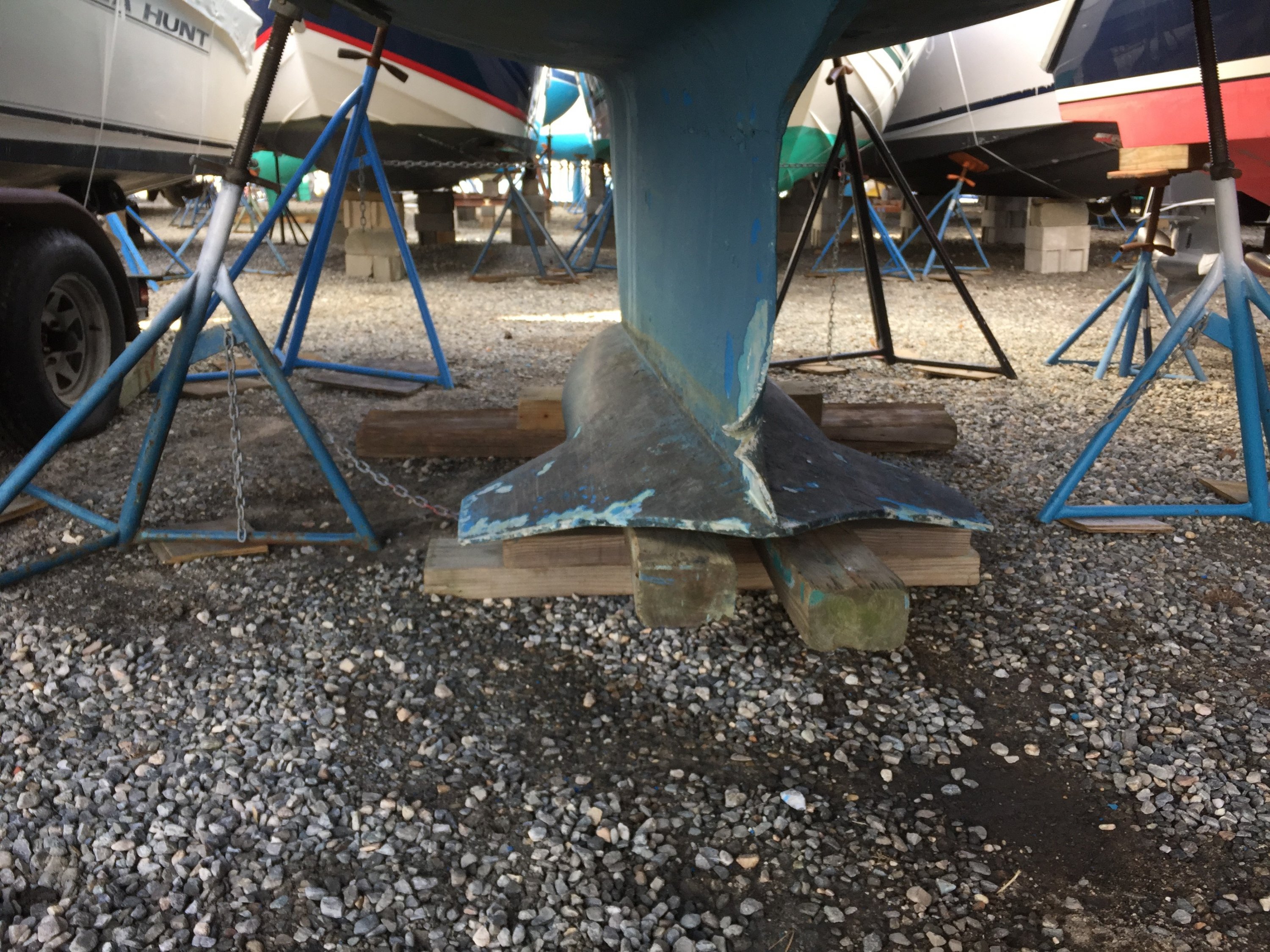

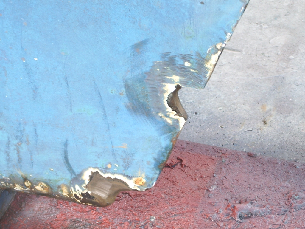

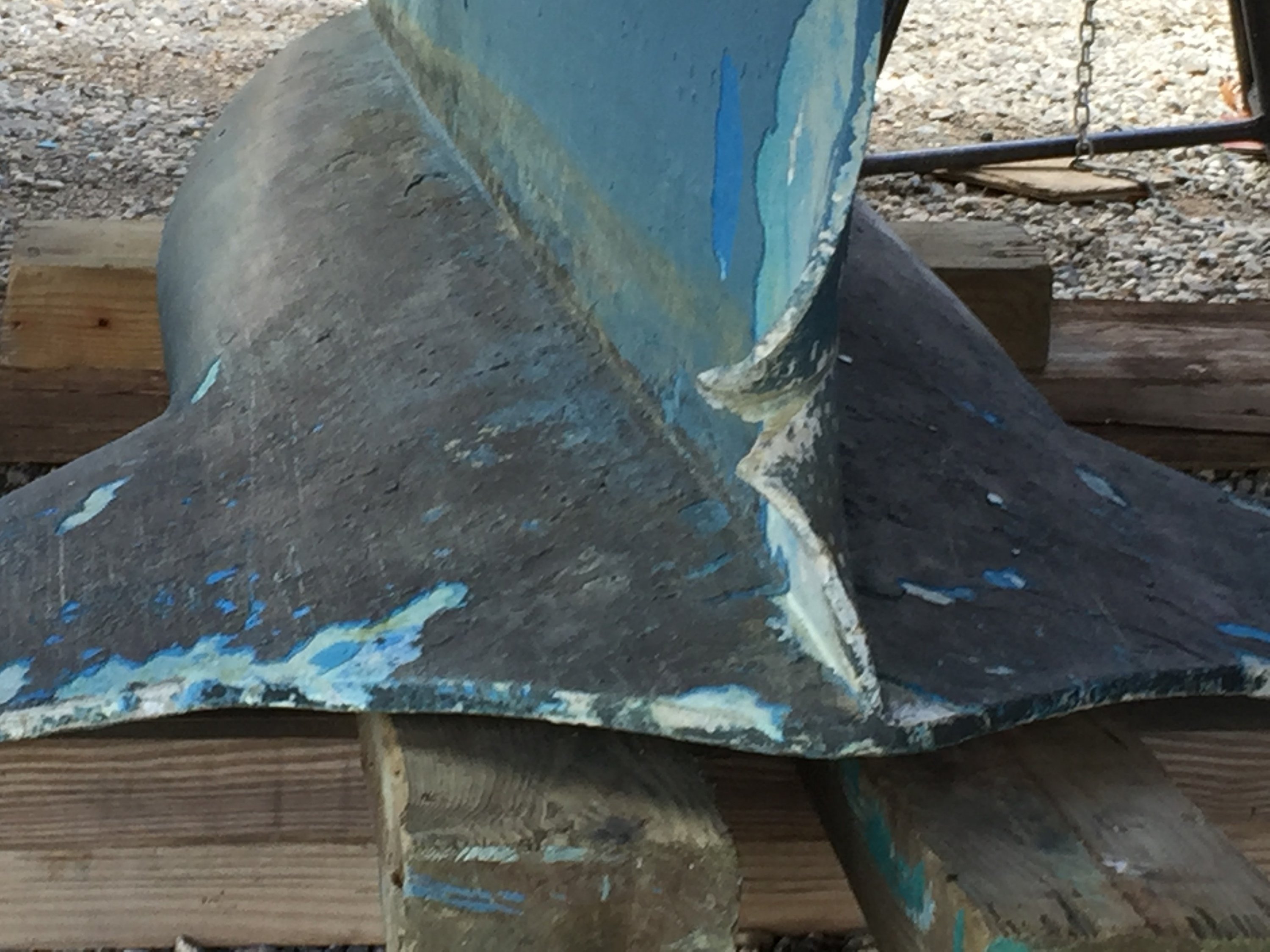

Wing-Keel Boat Sailors, I have had a couple of incidents when anchoring my Hunter 37.5 in tidal waters. This was when the tide changed but, due to the combination of wind and current, the boat's heading didn't, and the anchor rode wrapped around the wing keel. In each case, I had a scope of about 7:1 and the bar-tight rode turned immediately aft from the bowsprit and disappeared from view into the water amidships on the starboard side. Once hauled, I saw that the line had led to the trailing edge of the keel, bending around it towards the anchor off to the port side of the boat, and causing damage to the trailing edge of the keel. The last time, the damage was significant, (see attached photos) as it occurred during an astronomically extreme tidal current and the anchor was well dug in, with the boat broadside to the 4.2 knot current and the anchor plowing its way out the channel before I cut the rode. Other times this happened, the anchor held and there was less damage to the keel.

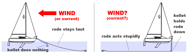

Do a search on kellet or sentinel.
Although I don't have a wing keel, I have had the same issue with my boat. Too much lift on the keel I guess. There is a place here called China Camp/McNears Beach where when the tide shifts to a flood and the wind continues to blow in the opposite direction, we turn completely backwards to the anchor. Bow into the current and stern into the wind when a light breeze. I did use a sentinel the last time I was there (2007). Mine is a foldable 8 pound grapnel type anchor that I attached to a carabiner with a length of line. After snapping the carabiner over the anchor rode, I let it down 8 feet along the rode and cleated it off. Theoretically, the weight was to pull the rode down vertically when it went slack and allow the keel to cross over the rode without wrapping the keel. During the day, it worked perfectly. By the next ebb we were pointed back towards the anchor. Then we went to bed. At 6:30 the next morning someone was banging on the hull. "Your anchor is dragging"! I got up and saw we were nowhere near where we had been. I pulled the rode in and 22 feet out was a frayed end. The grapnel had actually deployed and was covered with mud. It must have held us in 8 feet of water until the tide came back in and off we went again before the good Samaritan woke us up. So, That was the only time that ever happened to us. So, I decided my sentinel probably wasn't heavy enough. I also ordered an Anchor Riding Sail from Sailrite. They are pro-ported to keep the boat pointed to the wind and reduce swinging. But I've not had the opportunity to try either of these measures. My wife sees no need to go back to China Camp ever again. And we never did get our anchor back after dragging that grapnel all over the place.

Wow, 4.2 kts. That is a killer current. The sentinel should have kept your rode below the keel. It doesn't need a great weight as it is only functional when the rode is slack. I have a mark on the sentinel line so the weight falls below the keel when the rode is slack. That way, it doesn't get caught in the bottom.

As others have stated you need a kellet. I use a 10 pound mushroom type anchor as a kellet and that cured the problem completely. Mine is on 10 foot 1/8" nylon line with a snap clip that fits over the anchor rode and is stored in the anchor locker. You just need to have something to hold the nylon anchor rode straight down below your keel when it goes slack during current or wind changes. Up in Maine in most anchorages at least half the boats have them and most of the others have all chain rodes. Simple solution to big problem.
