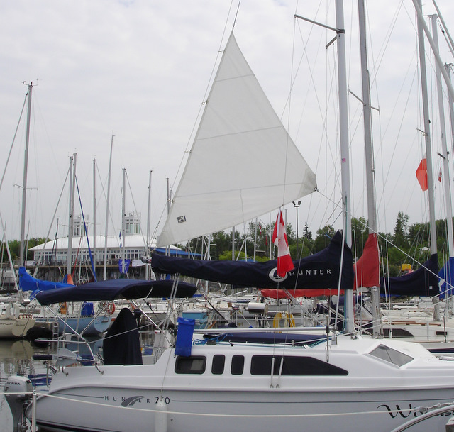

I just made an anchor riding sail for my 260. I had an old hank-on jib for my Mac that had been in tha garage for a long time. It measured 9ft across the foot so I measured 9 ft from the luff to the clew and cut it across there then sewed a seam along this edge. I replaced the hanks with brass snaps to go over the topping lift and sewed a piece of webbing at the top for the halyard. I don't know if it will help the sailing at anchor or not, if it does it will be a good hour invested. I just tried it on while in the slip this afternoon to see how it fits.
