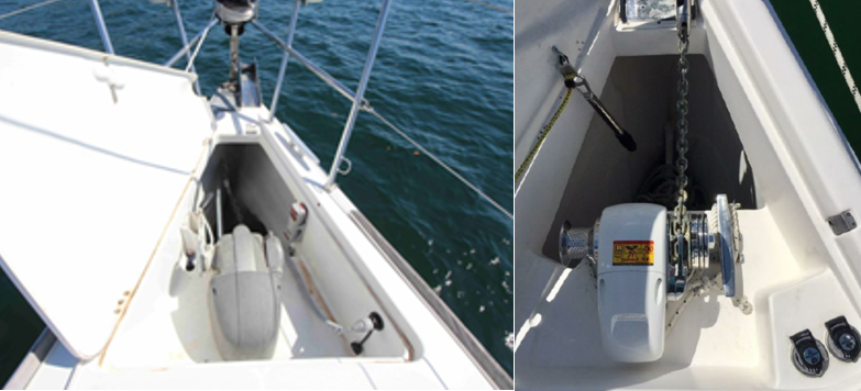

An internet search came up with this photo on the left of a windlass on a Beneteau 40.7. Does you anchor look like this with a shelf? The photo on the right is my horizontal Lewmar dual action horizontal windlass with 5/16” chain gypsy and capstan – activated by up/down foot switches.

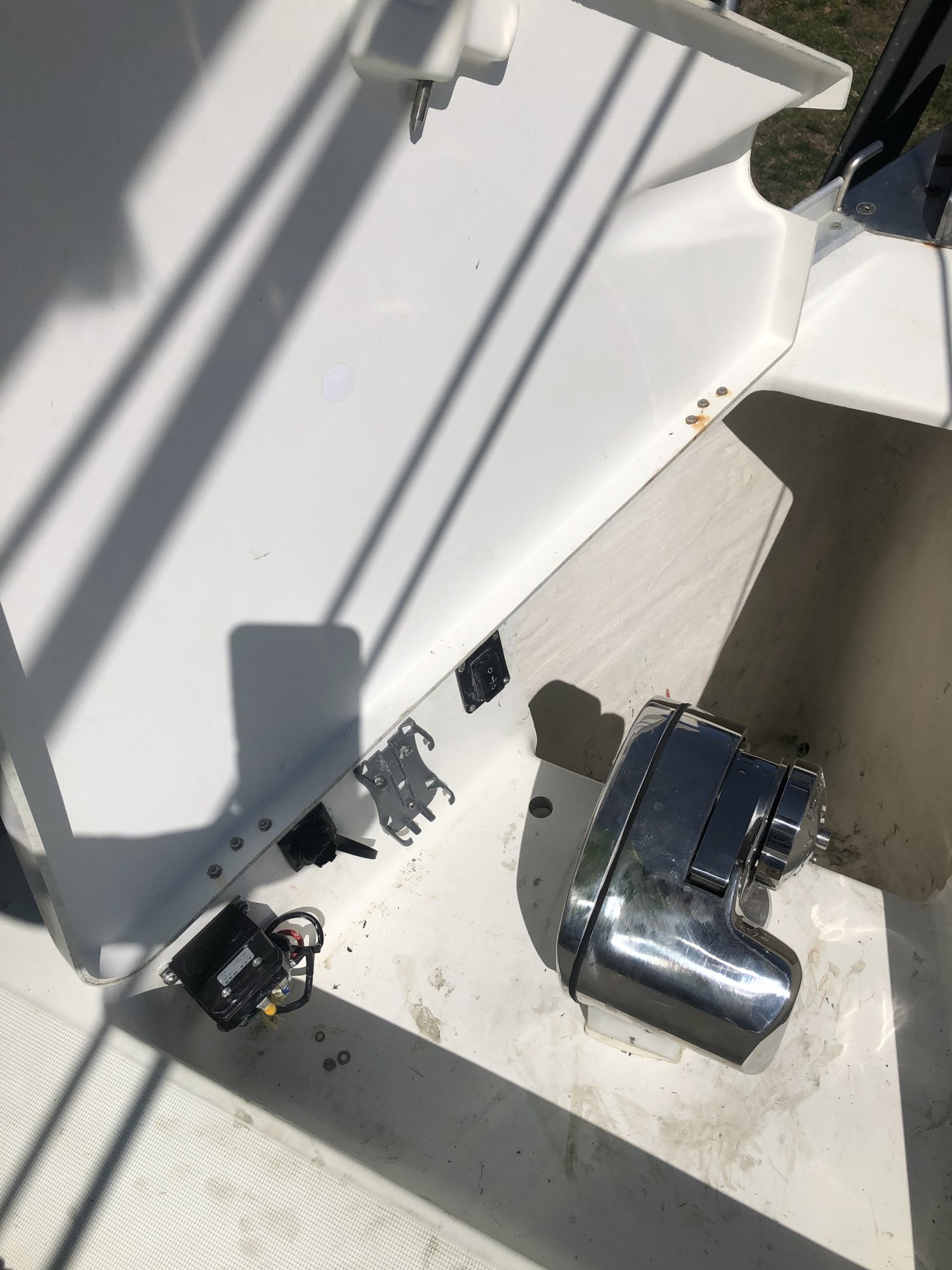

I had a piece of plastic cut to match the outline of the windless
For my B323 I used a Lewmar ProFish 700
You may be able to use the Lewmar 800 series
When Lewmar outlines length of vessel I believe that is for powerboats
Just remember when choosing the gauge wire you calculate the full circuit up and back

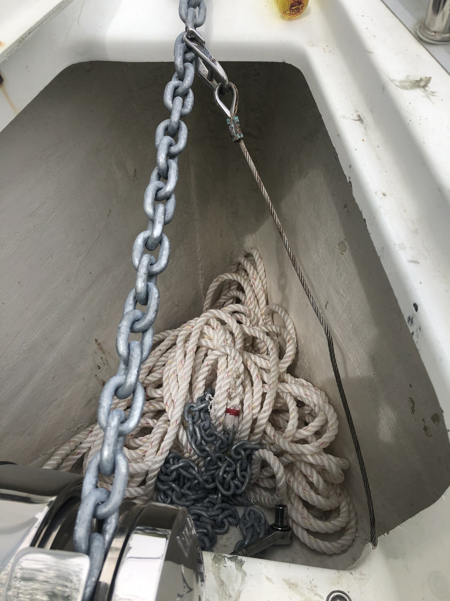

Also you can see I have a wire and the shackle tacked to the locker to hold the chain and take the stress off the windless we’re not in use
