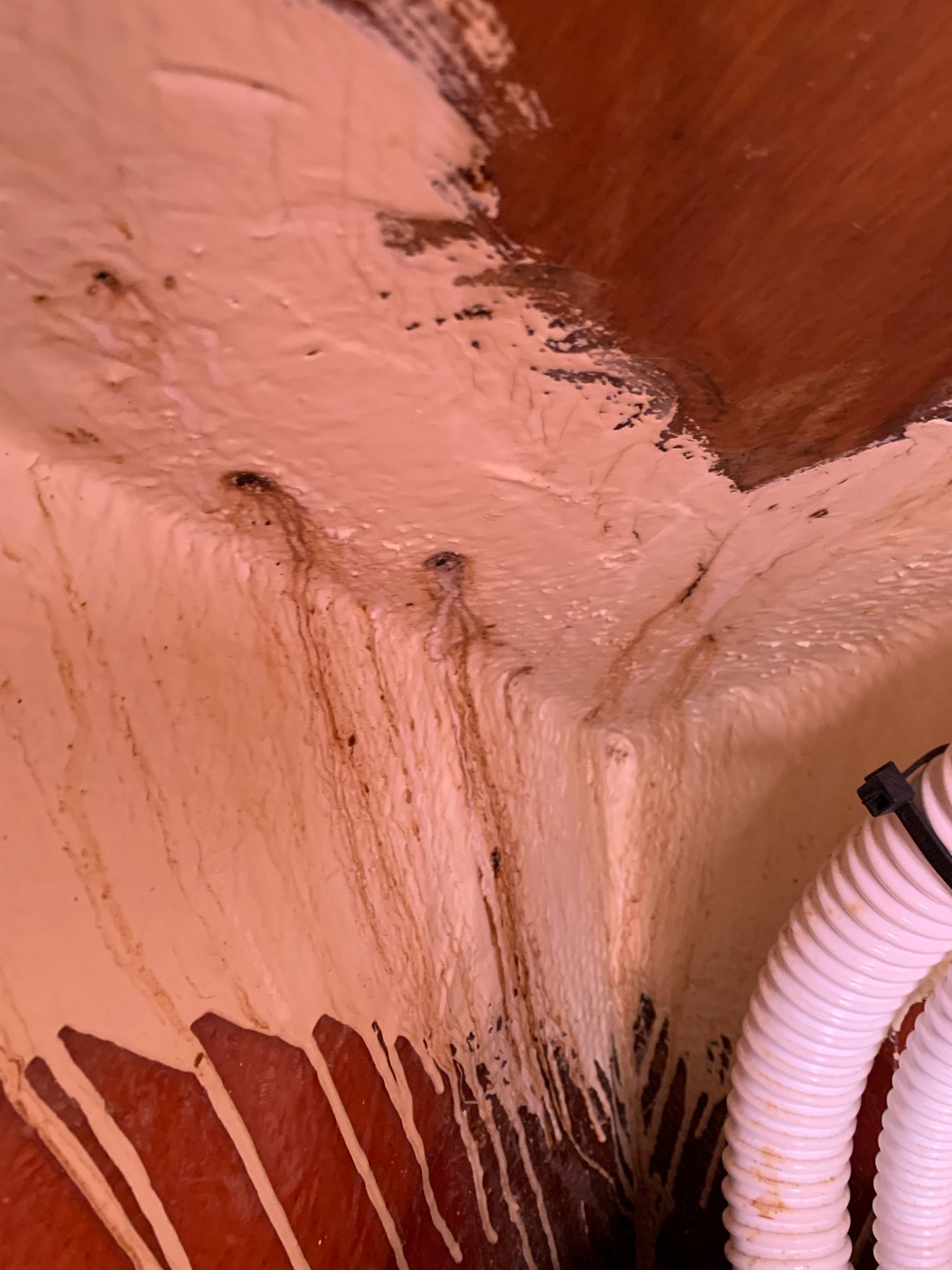

Like making sausage, you probably don't want to know what your anchor locker really looks like:
Mine has been leaking around a gallon of water into the boat in a heavy rain while on the hard, which collects under the V-berth between the water tank and the anchor locker. The big leak seems to be behind the water fill/vent hoses in the first picture:
It's hard to tell, but this is at the joint between the sloped glassed-in triangular plywood piece that forms the back wall of the anchor locker, and the vertical piece that goes from the top of the plywood up to the deck. So my thought is that the drain must have been at least partially plugged up with gook, so that the leak happens when the locker fills up with water. I've cleaned out the locker (mud and a few leaves), but even if it doesn't fill up with water anymore (haven't tested this yet), I think I need to address the leak. Here's another picture:
You can see the horizontal seam up at the top, so the leak is really up there on the outside, but it only comes through to the inside after running underneath the fiberglass. So what's the best way to fix this? If I cut away the fiberglass on the inside and re-do it, I'm probably just sealing the water against the plywood. There's a small place on the outside where I think I can see where the water gets into this joint, but it has really bad access. I could probably sand it down and put some layers of 2-part epoxy barrier coat over it. I don't think there's enough access there to do fiberglass on the outside.
I also have a few other places where it looks like there are pinhole leaks:
Again: patching these on the inside seems pointless. They are easy to get at from the outside, though. What do you all think?

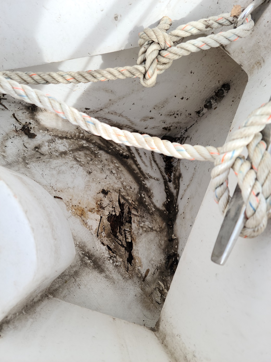

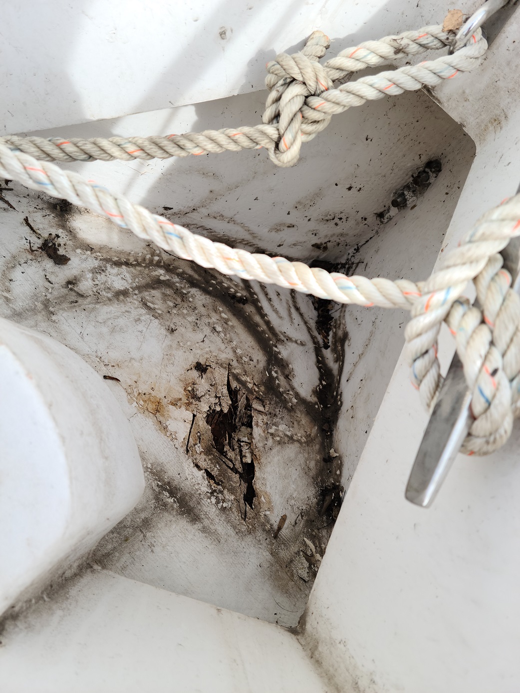

The leak in my H-306 chain locker didn't take as much investigation. The photo below was taken looking down from above the deck. The previous owner had the problem fixed with new fiberglass prior to my purchase and it looks good as new (for now - I haven't looked yet this spring). But I always find accumulated and pooled rainwater on the windlass platform and the deck fill shelf which lay just below the locker hatch lid, not to mention pooled up in 120 ft. of nylon rode. It's strange that such designs make no attempt to prevent rainwater entry. Seems like it wouldn't take too many snow/rain/freeze/thaw cycles to build up in the locker and cause trouble.

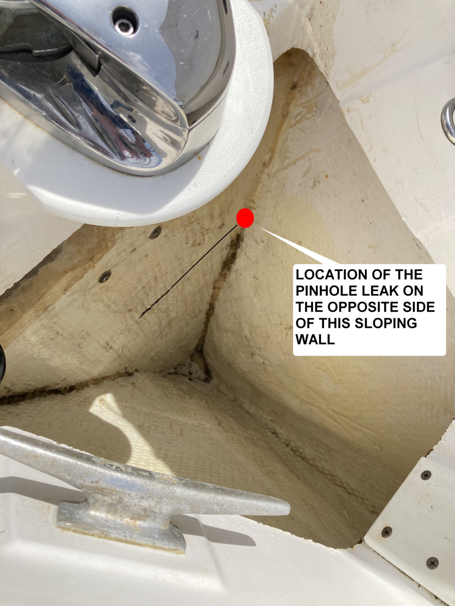

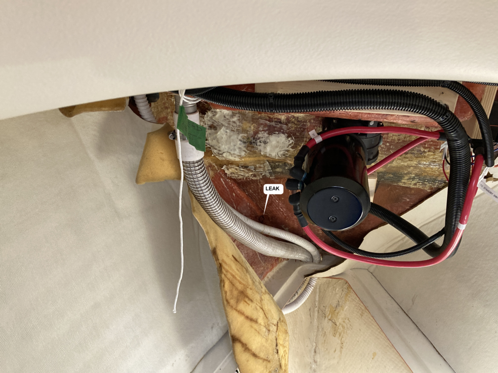

My apologies @jaysweet for not replying sooner after heading out to the boat for ANOTHER look for the leak leading from my anchor locker to my V-berth. Needless to say, I didn't find a damned thing which even remotely indicated from where the leak might originate in the locker. My marina partner @BC Bernie can attest that he witnessed me cursing and swearing into my empty chain locker like a madman that afternoon.

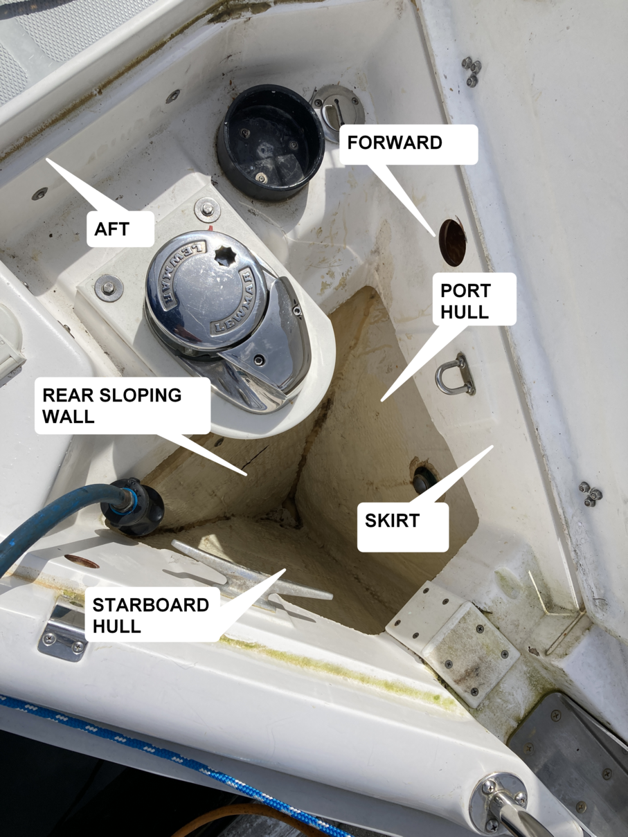

Just to clarify some of my obscure labelling of parts in the locker, this shot was taken on that Saturday afternoon:
One of my first attempted remedies was to paint the interior of the locker with a high organic volatile epoxy, the name of which now belongs to the ages. There wasn't too much available in epoxies back in 1999 in these parts. I might add, this epoxy (or imitation thereof) still appears to be tightly adherent to the underlying FG. At any rate, the success of this endeavour was zero, naught, and nada :cuss:.

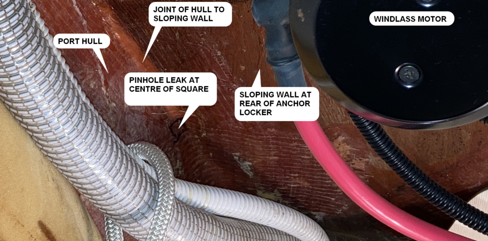

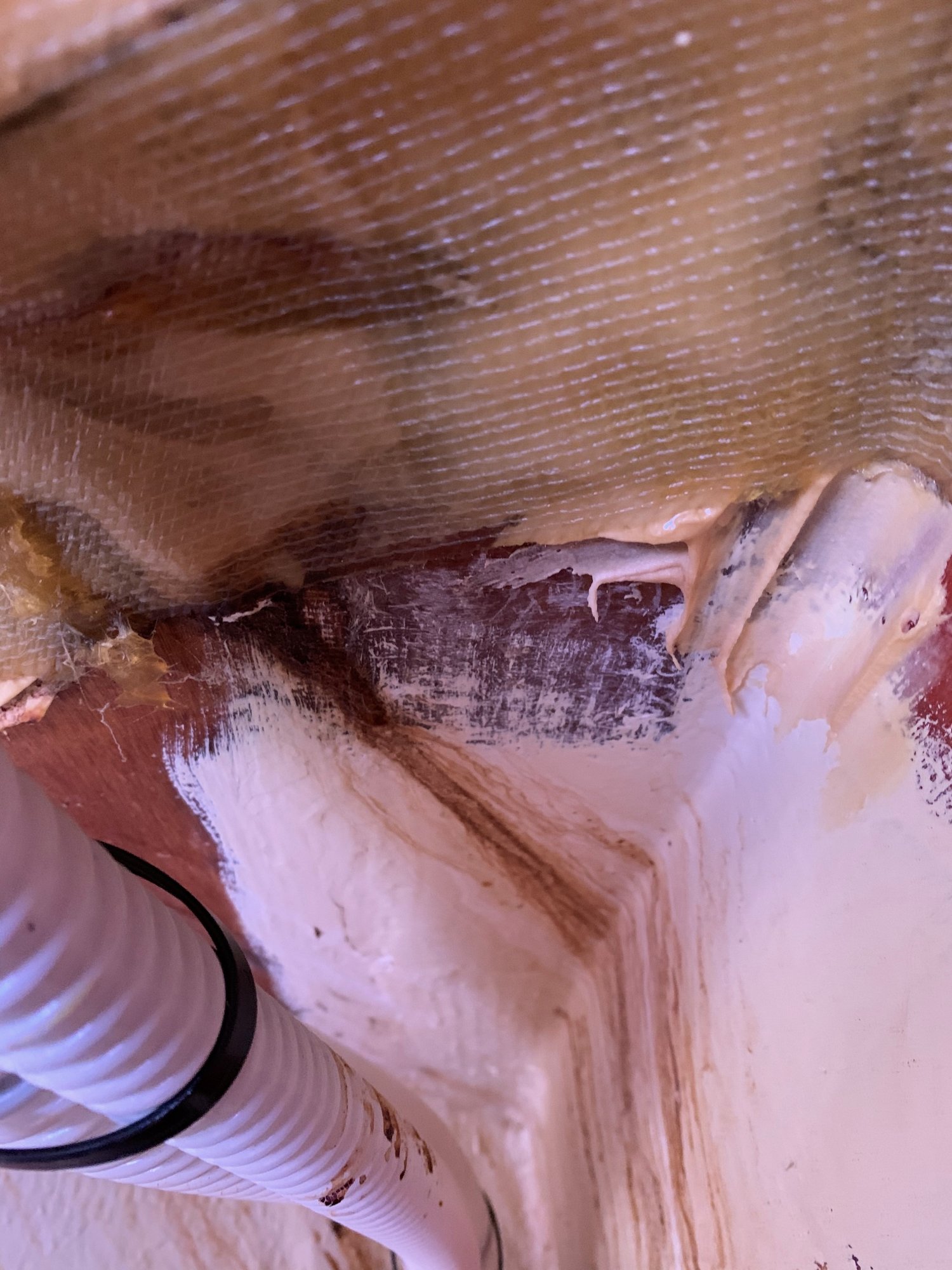

This shot shows the one, single, pinhole sized source of water ingress into the V-berth:

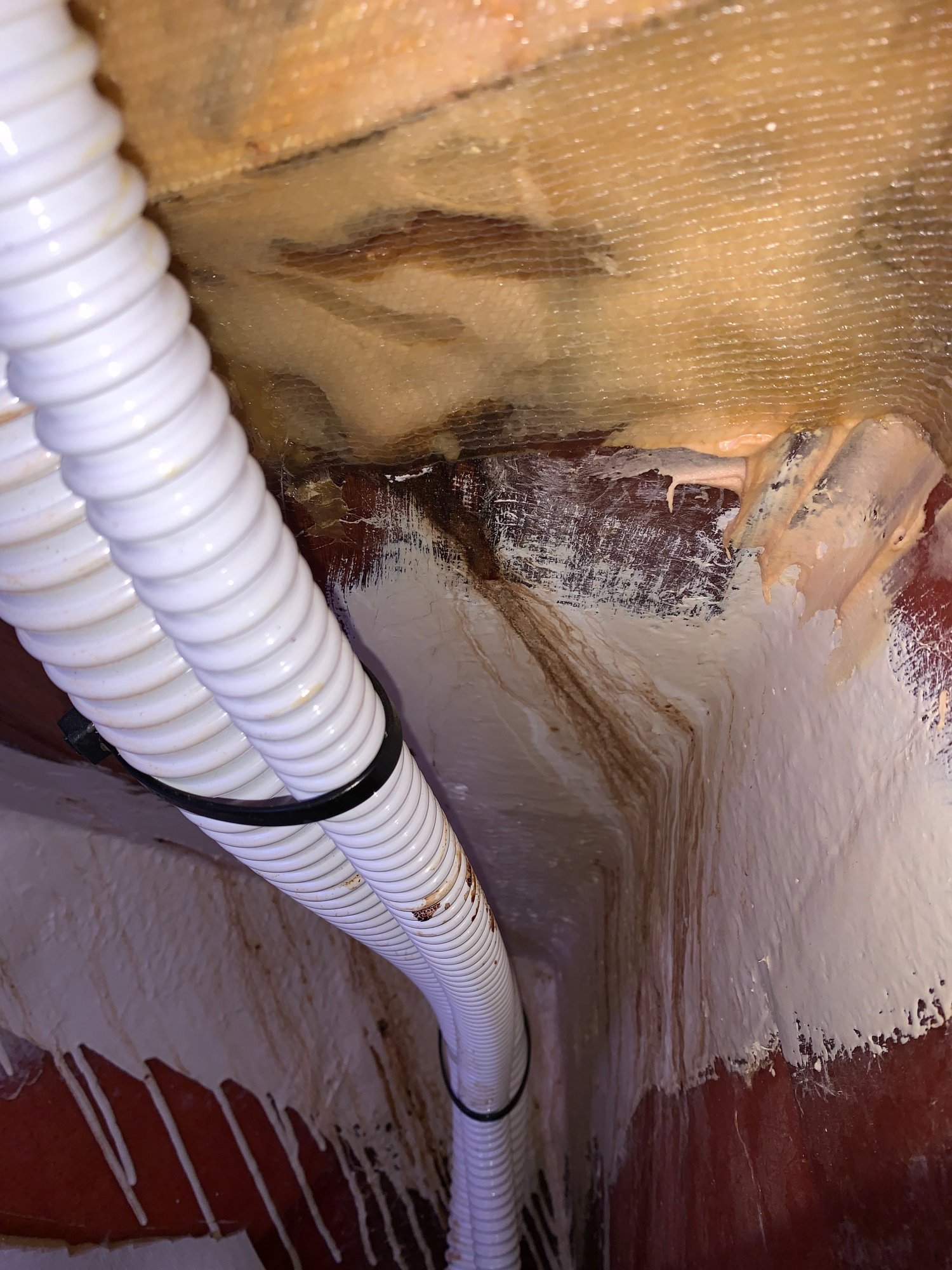

And this shot, a little closer:

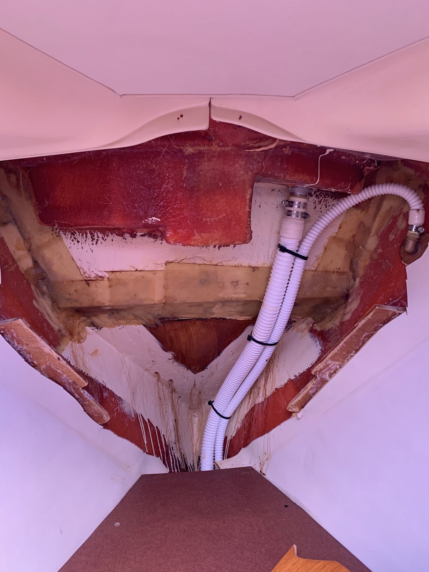

This shot shows the location of the leak inside the V-berth as seen from the anchor locker side.
Moving on from there, I then focused on the possibility that a hole from the locker was located somewhere up↑ under the rear of the skirt which covers the location where the sloping wall is FG'ed to the port hull. This would mean that water would have to run uphill to get to that hole but what the hell, desperate times ... desperate measures, you know the drill. The area under the skirt was repeatedly coated with about five coats of System Three Silvertip epoxy in the hopes of finding and filling the hole. The first few coats were thinned with lacquer thinner to ensure the epoxy would follow the course of water and then coated with epoxy which had been allowed to slightly set for greater viscosity. A paint brush on an aluminum 1" X 1/8" flat bar was inserted through the cut out hole in the skirt as well as from under the skirt at that point. Hard to imagine but still NOTHING :cuss: ! ! ! !
On the port side, numerous coats of epoxy were applied top ;to bottom to the joint where the port hull meets the rear sloping wall. You guessed it, still leaked :cuss:.
Wow! I've got nothing like that. My leaks seem to be a couple of small pinhole leaks on the sloping surface forming the aft wall of the locker (where your huge hole is), and one that's just under the drip-lip for the windlass platform. (I also have no windlass.) Unfortunately, my theory about "the locker was filling up with water and leaking at the top" was proven incorrect. We had a good rain on Monday. I had nothing in the anchor locker, and the drain was not plugged up, but I still got a goodly amount of water forward of the tank, in the v-berth. The problem is that the place where the really big leak is located is probably under that drip-lip for the windlass platform. Hard to see and access.
And yes: I agree that designing it to puddle water where the windlass is supposed to be, as well as where the water tank fill is, makes no sense. It's in no way the cause of my leak, but it's annoying and a bother.

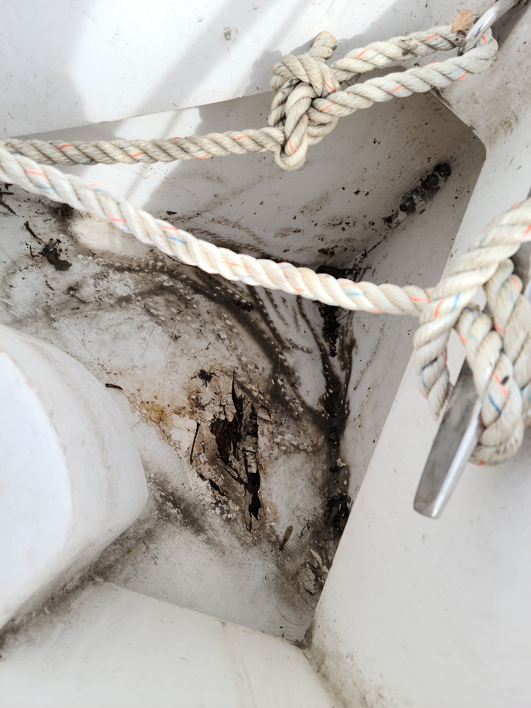

I was out yesterday to do some work on my rudder and took a quick look at the locker. I had removed the winter cover before a fair bit of rain this last week, and arrived to find at least a half gallon of water in the bilge and a wet forepeak. Before removing the cover there was zero water in the bilge. So, @Ralph Johnstone , if you've got any System Three left, I may need to borrow some. :huh:
