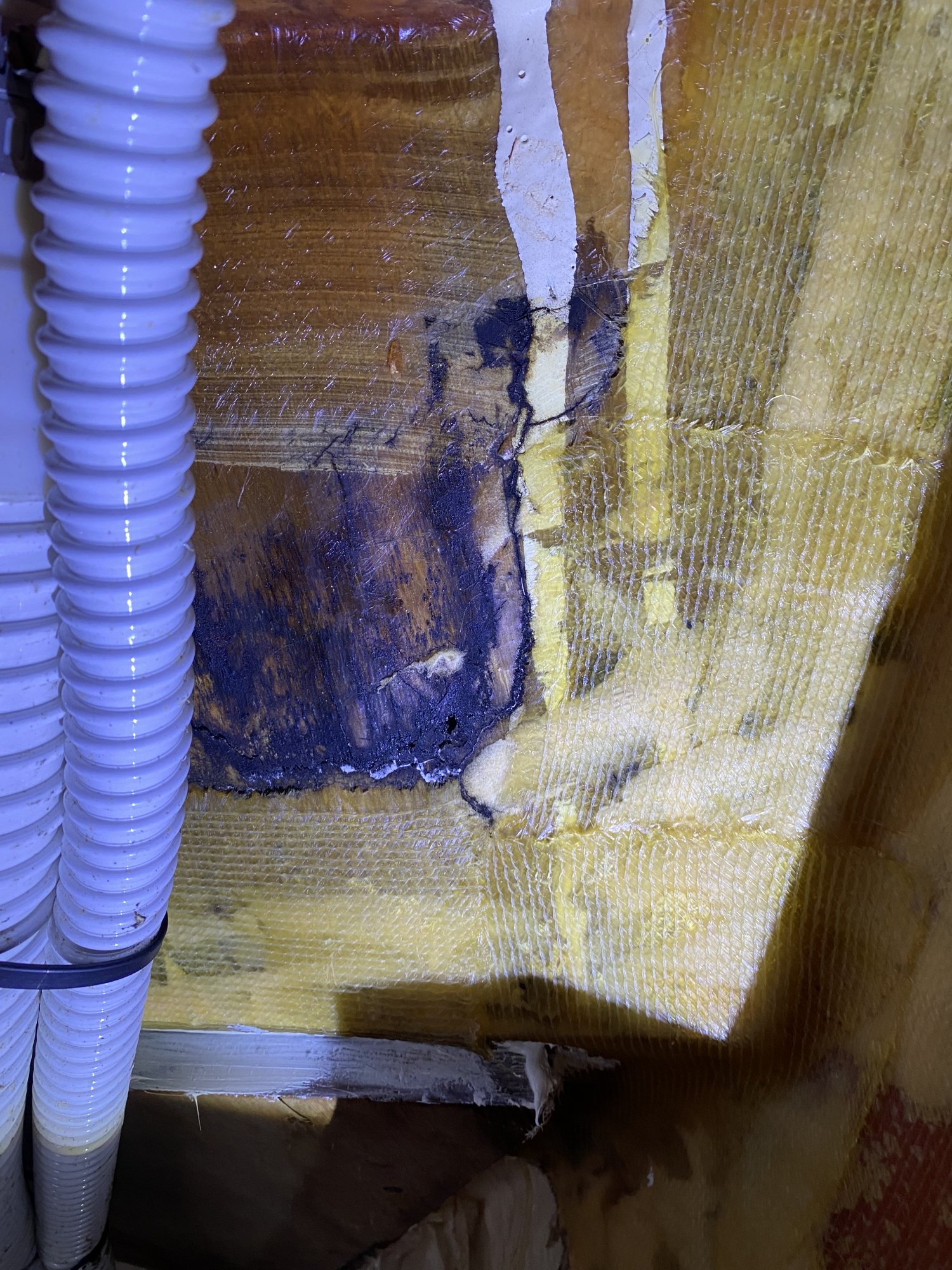

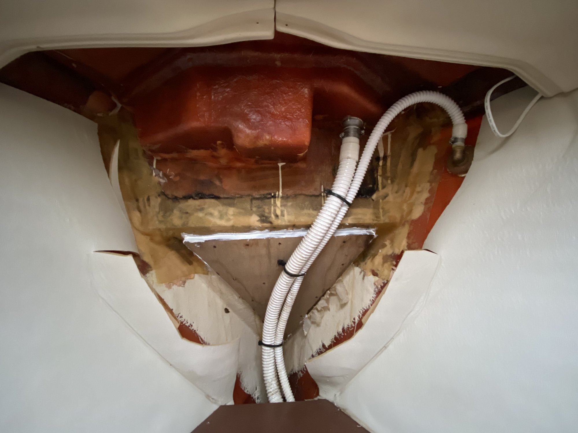

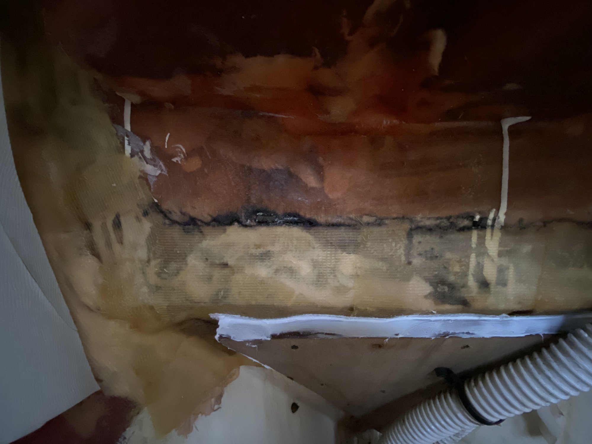

Well, you showed me yours, so I’ll show you mine.
11905635-E60E-4A41-B290-F78CF20F9C42.jpeg06D28227-3AA5-4863-A1DB-14362A8BBDBF.jpeg40089775-313A-451F-884D-2D96E14A401E.jpeg
Looks like similar construction to yours, but I’ve had a previous repair done with that triangular sheet of 1” plywood. There’s rot all over, but most significantly on the upper plate. Bummer.
