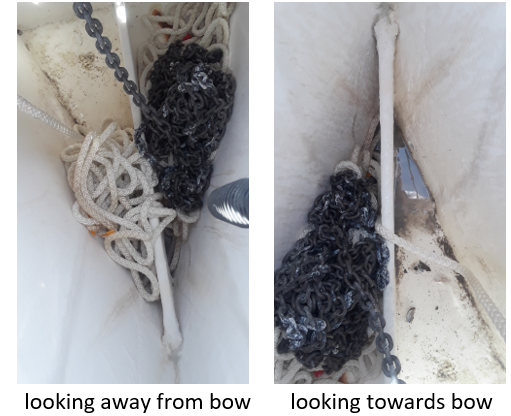

The anchor locker on my 2005 Hunter 46 leaves standing water below the through hull drains on each side of the boat. The photo on the left shows no standing water (the floor slopes to the bow) whereas the photo on the right show standing water below the through hull drain, located 1" above the floor. As a result, the anchor locker does not free drain. A few questions for the forum:
1. Is there any risk with standing water on the anchor locker floor near the bow?
2. Are the drains correctly located 1" above the floor and, therefore, standing water is to be expected?
3. If you were to mitigate standing water and provide free draining what option(s) would you recommend, e.g., raise the floor to make it flush with the through hull drain with say King StarBoard HDPE Marine Building Material sealed to the floor and sides, install a new through hull drain that is flush with the floor, etc.?

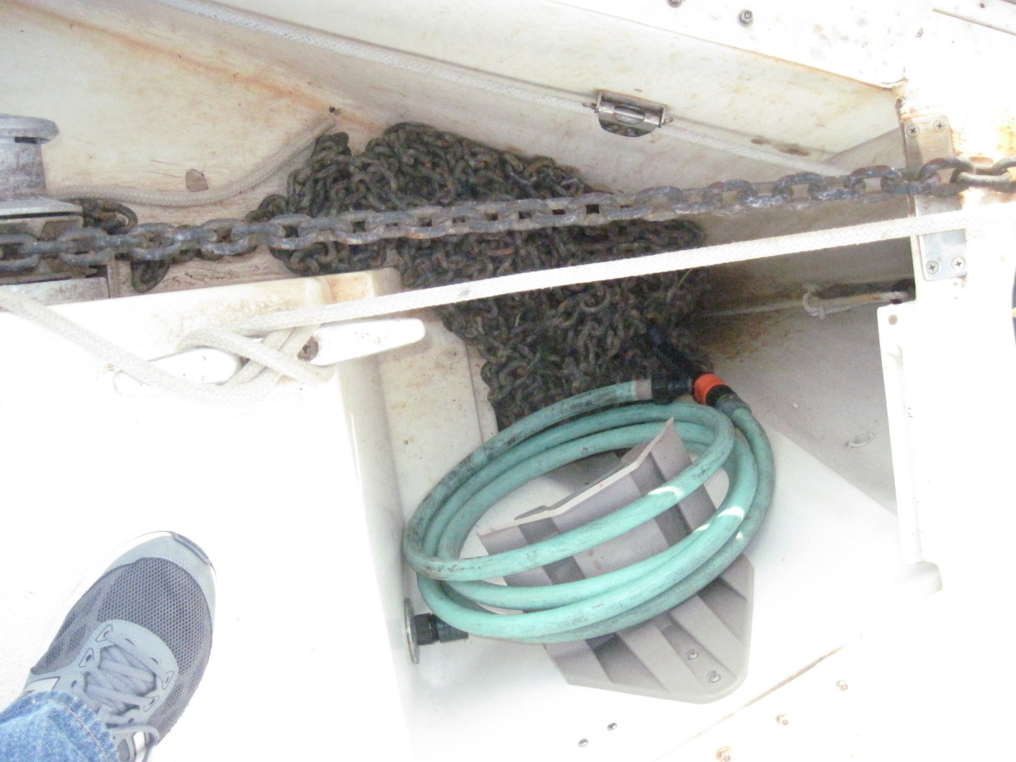

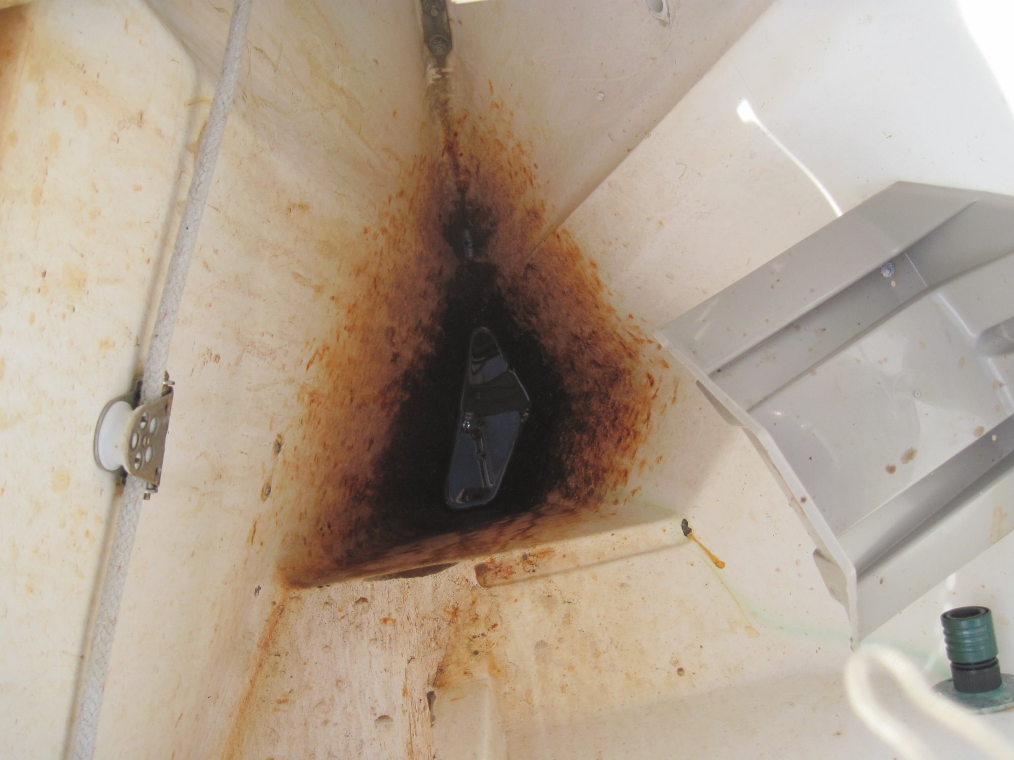

I considered raising the floor to be even with the existing drain but I couldn't think of a suitable way of accomplishing that. It is a difficult spot to measure, cut , and fit anything. I didn't think pouring epoxy into the spot was a good idea either since as the block of epoxy would cure it would produce a tremendous amount of heat and I didn't think that would be good for the Fiberglas hull.
So what I did was to cut, by trial & error, a plastic support that would fit snugly around the bottom of the locker and would also have a couple "feet" that would extend to the bottom to take the weight load of the chain.
I used a regular plastic milk carton that I bought for a buck. I made so measurements as best I could and cut a cardboard template that roughly fit around the edges. I then used a portable Ryobi 18V circular saw to cut the plastic carton. I cut it so that a vertical portion of the carton side would reach to the bottom and cut bottom of the carton to fit the shape of the locker.
Attached are some pictures- Empty locker, Plastic milk carton support, chain stowed.

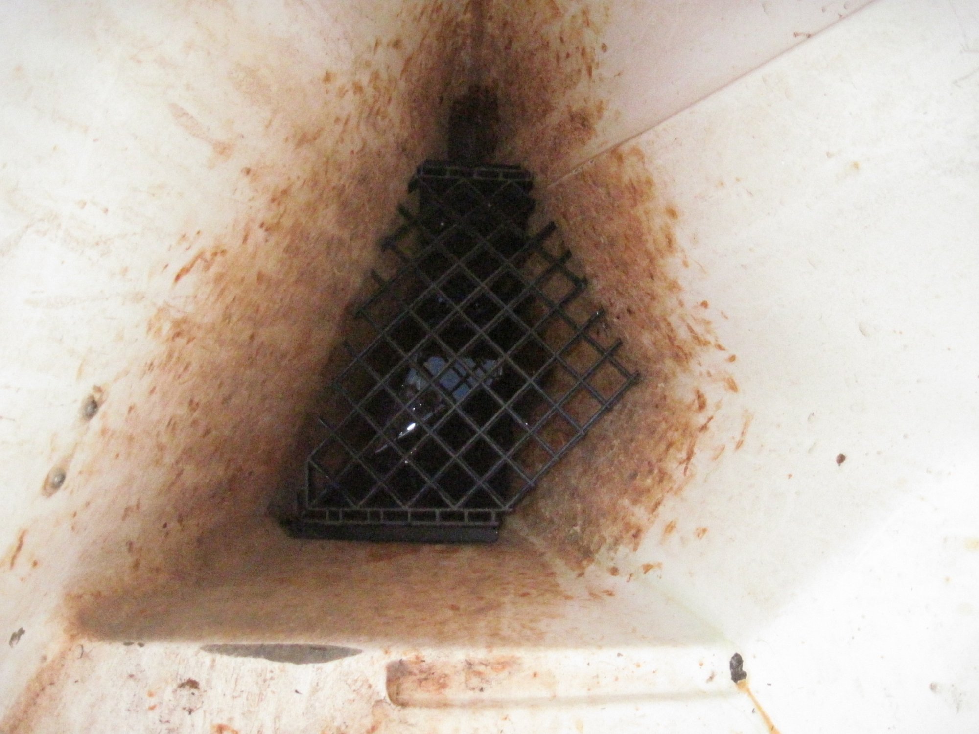

On my boat the lowest hole is about a half inch above floor. I bought a plastic grid and cut to form to keep rose and chain high and dry......

Thanks FastOlson and NYSail, great suggestion!!.............I used them those on my previous boats.
