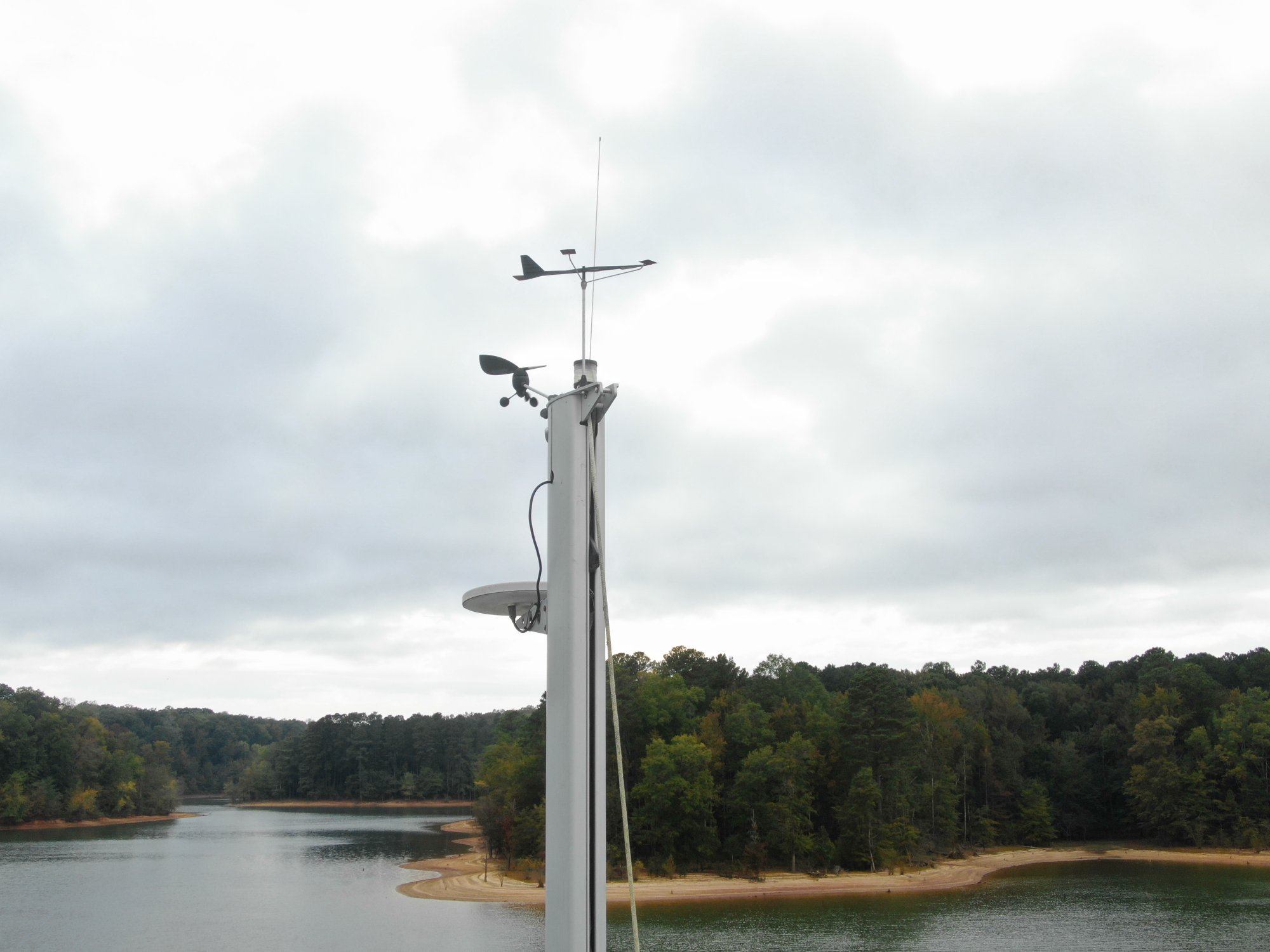

Ok -yes i an climb up there and fetch it, bring it down and then get the correct bulb, then climb back up there. 60 ft off the water with a fiberglass deck somewhere close to the bottom. Or maybe, just maybe, someone might be kind enough to lend me some hard earned knowledge about which bulb to take up with me the first time. Hunter 38 2006 anchor light drone pic attached.

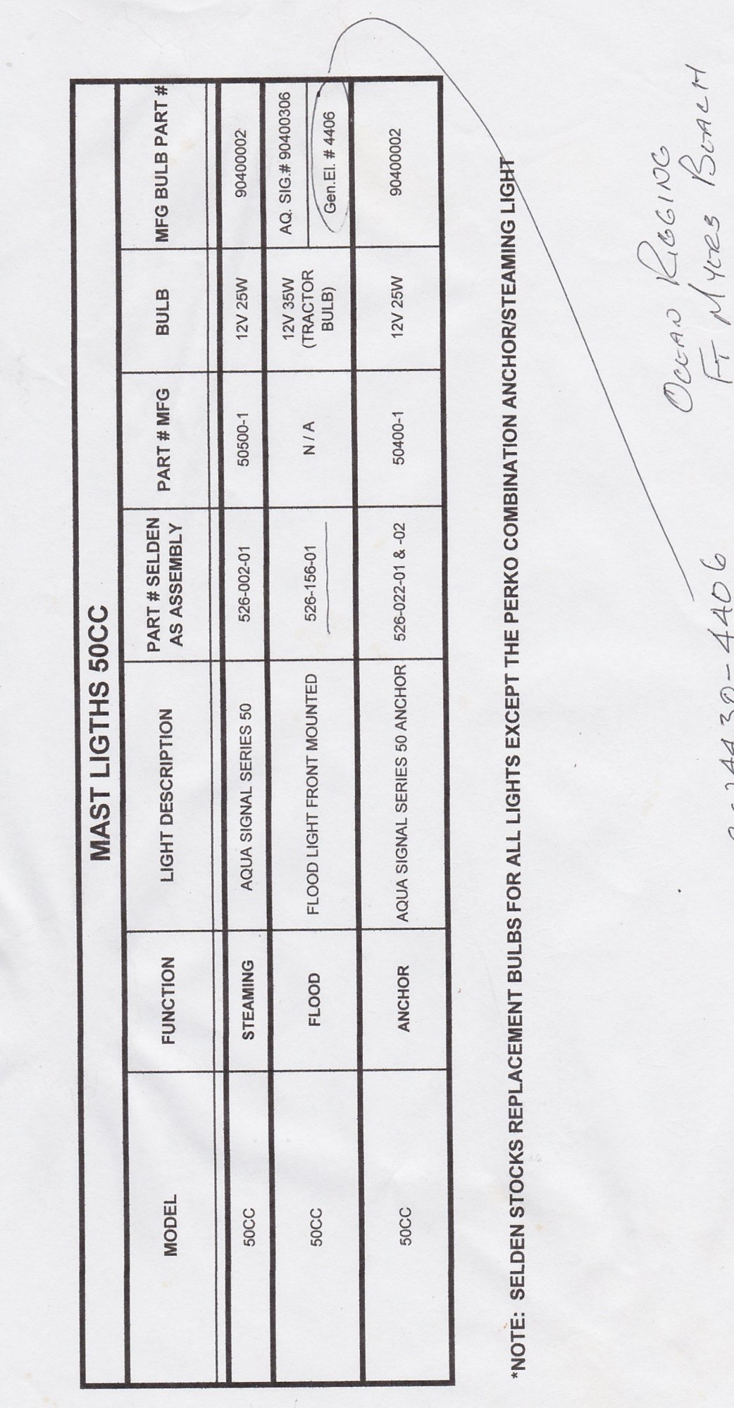

OK I think I can help! Your anchor light looks like a Aqua Signal Series 50. Takes a 12v 25W Bulb. Bulb PN 90400002. Replace the bulb with a LED and save lots of power at night! The Mast Light index below states it is for a 50 but I think they are pretty much standard issue for Hunters. Hope this helps!

Ok -yes i an climb up there and fetch it, bring it down and then get the correct bulb, then climb back up there. 60 ft off the water with a fiberglass deck somewhere close to the bottom. Or maybe, just maybe, someone might be kind enough to lend me some hard earned knowledge about which bulb to take up with me the first time. Hunter 38 2006 anchor light drone pic attached.View attachment 170937View attachment 170937
