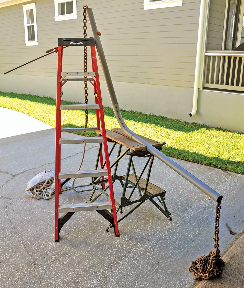

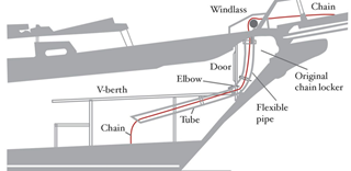

All my Hunter sailboats had/have an anchor locker in the bow, without a deck pipe pipe in the locker, where I stow 350 feet of rode. I installed a shelf below the horizontal windlass (like shown in the schematic diagram) to facilitate feeding the windlass / locker and getting it off the wet floor. The Cruising World and Practical Sailor articles discuss the use of an angled spill pipe to redirect the anchor chain from its original locker in the forepeak to a larger locker farther aft, which not only allows the rode now run freely without piling up, but it also lightens the bow. Maybe others in the forum have done this OR installed a separate deck pipe like the sea dog.
