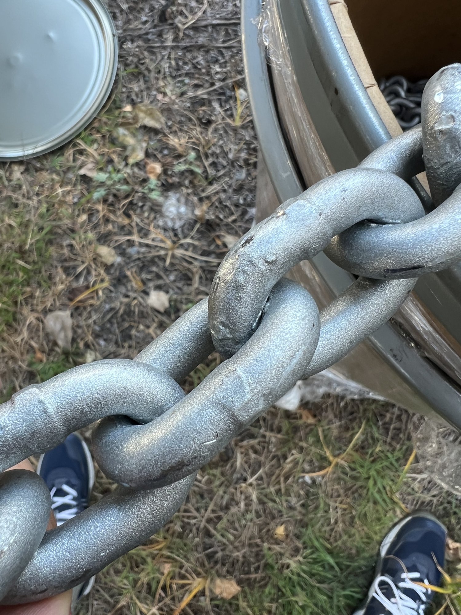

Fast service and fair price, including shipping for a 300# drum to my boatyard.
Before that I had ordered Acco chain from WM (when it was on sale) and wasn‘t happy with the galvanizing on my order. Rejected it and paid more for the LaClede chain. I later heard Mantus was also reselling Laclede chain Mantus Chain - Mantus Marine
