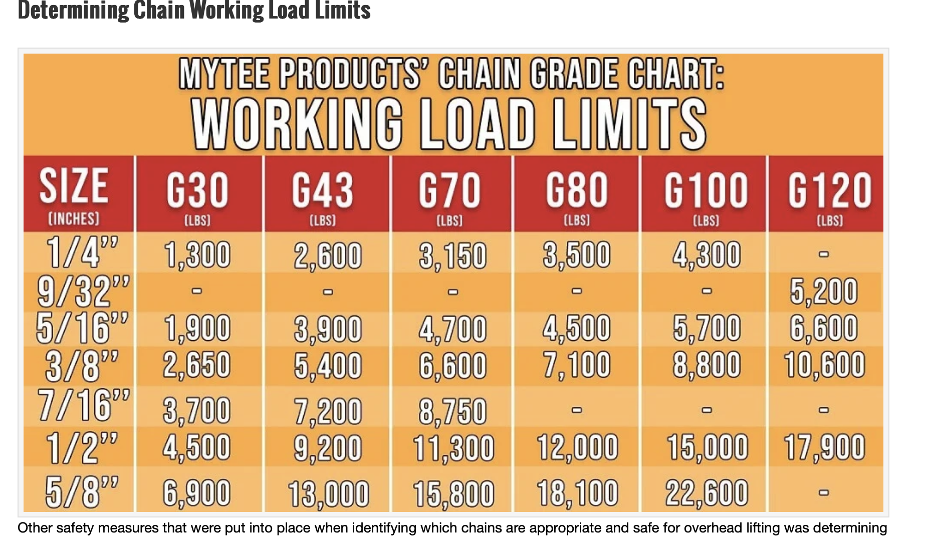

Look at this chart from this website
A ¼" chain is 80% of the diameter of a 5/16" chain, following your reasoning, it should have 80% of the strength of 5/16" chain, but it doesn't.
Using G30, the working load limit of ¼" chain is only 68% of the 5/16". Looking at the math from the other direction strength of 5/16" chain is 146% of ¼" while only being 25% larger. The point is diameter is important and the relationship between strength and diameter is not linear. The loss of strength due to the erosion of the chain (rod) is disproportionally greater than the amount of erosion considered as a proportion of the rod diameter.
In an article I published in Good Old Boat Magazine a few years ago, I found shackle size (rod diameter) to account for 98% of the variance between mean breaking load and cross section area while diameter alone only accounted for 94% of the variance.
