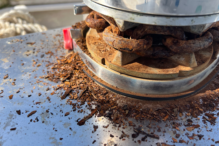

I’ve noticed accumulation of rust flakes around my windlass when dropping anchor, and see some flaking corrosion on many chain links. It is G4 chain, which I thought was essentially corrosion proof.
I know some rust isn’t cause for concern, but this seems to be diminishing some link diameters. Am I at the point where I should replace my chain? Is this amount of corrosion normal for G4? If not, why would this be corroding so significantly?
If I need new chain, how do I mitigate such corrosion in the future?
Water dripping on or regularly exposed to rain on Windlass and/or chain.
If the rest of your chain is not so exposed you can cut off bad and add new.
Jim...
PS: you can lose 125% of the link diameter and still be ok.

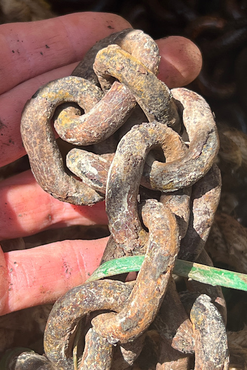

Your first photo shows come links that look a bit dicey. The second photo shows links that look like they could be re-galvanized. Hard to really know, the devil is in the details, as the saying goes... How many feet of chain do you have? If you lost say 10 feet off the worst end, would that be too much for where you anchor? Just a thought, if you could cut off the worst of it, get the rest re-galvanized, you might be able to save a fair bit of $'s....

How old is your chain? Considering the condition of your chain, it would be a waste of time/money to re-galvanize, IMHO. Go with new.
We used our 1991 original 30' hot dipped galvanized chain many times over the years and it looked nothing like yours when I replaced it in 2015 with 50' of ACCO brand (Made in USA) hot dipped galvanized 5/16" G4 chain in order to obtain a bit better holding weight. Our 2015 chain has spent a lot of time in sea water and it looks the same now as it did then.

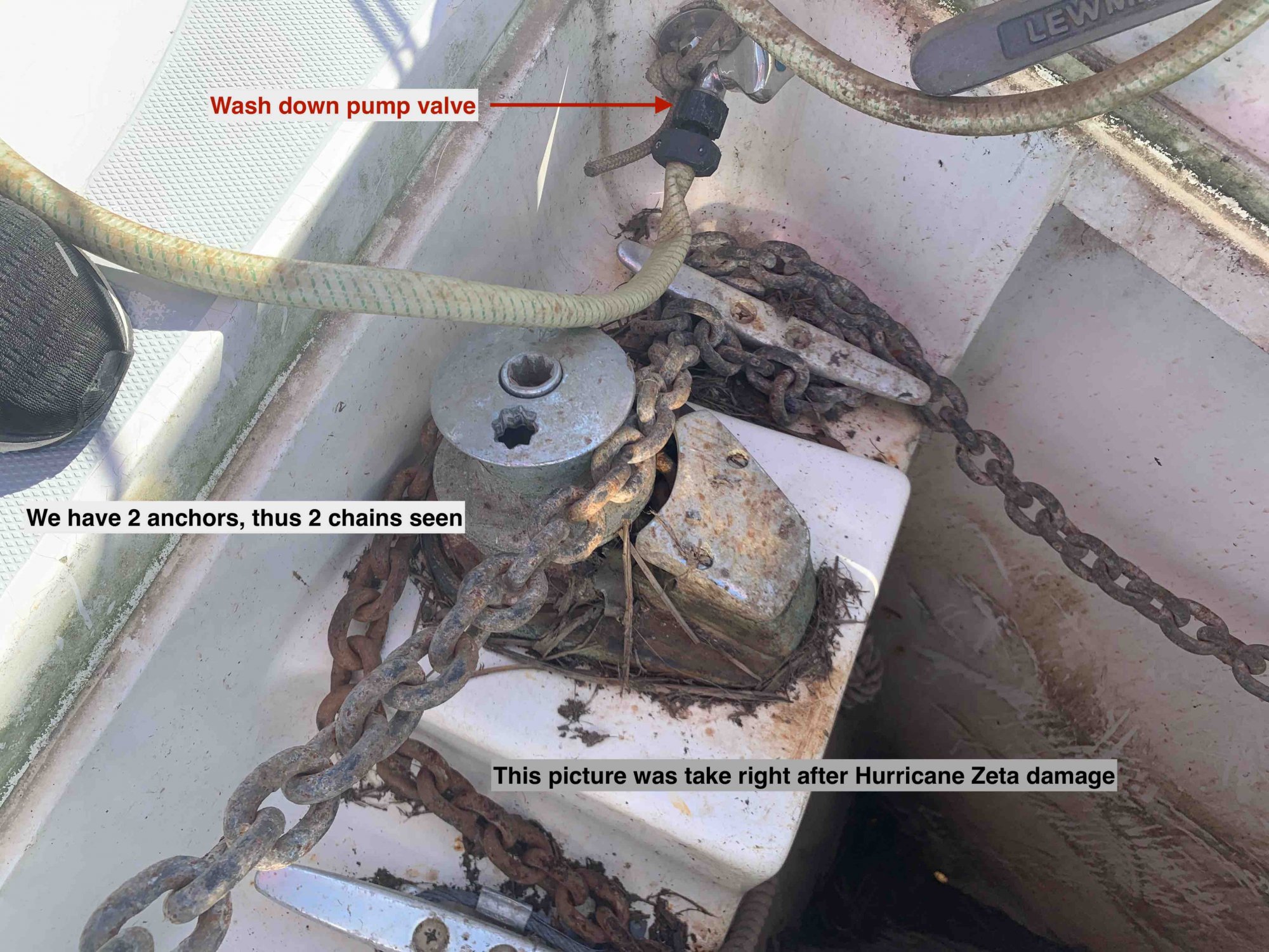

We have a sea water pump to wash anchors and deck.
Outlet is installed inside our anchor locker.

Actually, there may be some left. The innermost layer of hot dipped galvanize has a high iron content so may appear "rusty" when in fact that layer is still protecting your chain.... Certainly can't tell you from the photos...
