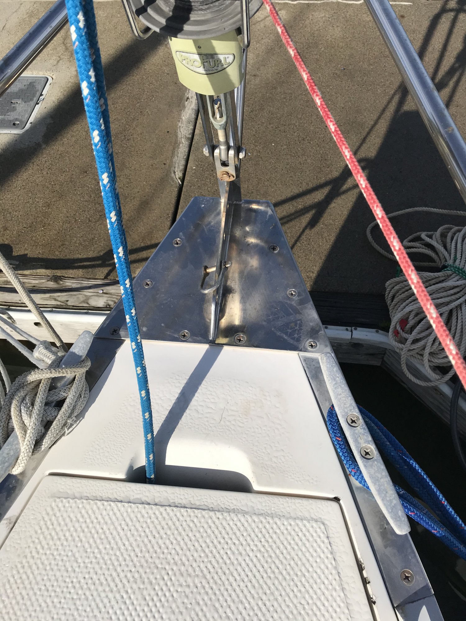

I’d like to add a bow roller to my 84 Hunter 31 has anyone done it so I can I use the existing holes/bolts?(see picture)
Is there any problem with that.
Any ideas suggestions welcome I’d love it to be an easy install.
oh yeah I’m adding a Rocna30 if that makes a difference.
Thanks in advance.

I've installed two bow rollers and seen hundreds...
Not sure you could match up your existing holes with the pre-drilled holes from
the roller factory.
But hey, stranger things have happened.

Scotty... I hate to think I am missing something, but I do not see any holes in the bow plate to install your roller. I would think you will need to set the roller on the bow and then drill holes where placed in the roller. I would then back up the bolt holes with backing material (not just washers) to help the thru bolts to hold the roller in place.
Practical Sailor magazine had a good article on backing materials... You can find it using a google search.
Looks like you have the room. It is not a difficult DIY task. maybe 2 :beer:. One for you and your sailing buddy.
I'm referencing the large Philips head screws on the steel bow plate(in the pic) I was hoping I could use all 4 of them maybe with longer screws to attach a bow roller that maybe even leads right to the anchor locker to protect the fibreglass from dragging chain as it pays out.
I might just have to buy one with no holes and match them up it seemed like a simpler solution than drilling more holes in the deck?
Comments, suggestions or personal anecdotes always appreciated..
It may be more than 2 beers lol
24,949
Ok. Well there is nothing stopping you from just drilling holes in the base of the roller that match up.
I had to drill a couple on my roller base when I installed it. Recognize that the screws in the roller base are located so they manage the stress from the anchor hanging out over the end of the boat.
In physics terms "You are securing a lever to the bow of your boat". You need to make certain it is attached with through bolts and the underside of the deck has backing plates to stiffen the deck preventing the roller from damaging the deck. You do not want screws into the deck or bolts with tiny washers that can pull through the deck when you are in a big sea and the waves are bouncing off the anchor as it is dangling out in the air on the roller.
Ok so maybe a 6 pack... Just save most of them for the post install celebration. Worst part of the project for me was drilling holes in my boat. :yikes:

A bit unclear from the photo, but it appears that the bolt holes that secure the existing SS plate to your stem line up with the bolts that secure the deck/hull joint. If it were my boat I would find a roller that would use those existing bolt holes for mounting the roller. If unable to locate one, whatever roller I could find that works, I would mount it to that existing stem plate, either by welding or bolting to it. The way that stem plate is mounted and secured to the deck/hull joint looks robust enough to handle a roller mounting. The bolts that secure our roller use those same through bolt holes for mounting. I'm assuming that your deck/hull joint is secured the same way as ours, which use through bolts.

Hi Scotty, hard to tell from the photos I posted regarding the anchor lock that I use, but on the last photo, you can see our stem has the same kind of plate your boat has, but with ours Hunter screwed and welded two pieces of SS channel to that plate to work as a bow roller. The main longer channel has two small nylon rollers in the back and one larger in the front, with with SS pins or axels, to help guide the anchor rode. This article might give you some ideas as to how to locate or put one together here.

Another thought would be to remove that SS plate, make a dimensional diagram of what you want, and take it to a metal shop that has the SS channel material they can weld to that plate. Might cost less than trying to find one. Just say'n.
