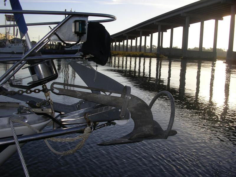

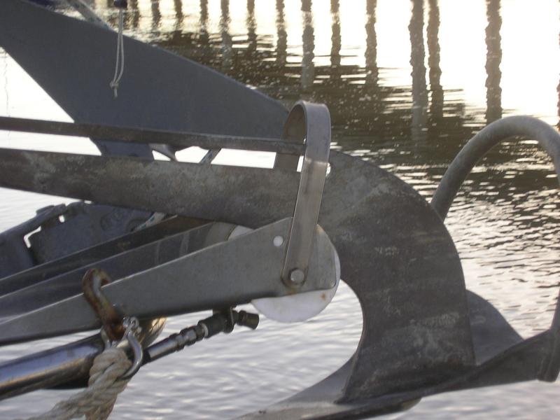

Hi all,
We had an issue with our anchor chain jumping off the roller while retrieving the anchor with the windlass. It usually happened when the winds were up and we were swinging side to side. We always communicate bow to helm, but sometimes the strain would pull the chain over the side. I had seen smaller boats with a boom bail to hold their chain rode but I couldn't find one big enough for our Manson Supreme anchor. The fabrication shop here at Hinkley Yacht Services made one for me. I'm very pleased with the results.

Just been wondering here where hinkleys shop is ..... and had to ask if that was the thunderbolt bridge in the right if the pic ....oh the bail looks like the one that is on my Lewmar bow roller...

Is that a pressure washer hose up there?
If it is ya got me thinkin for my next project!!!

ALL You Get
Gary
No, just a wash down pump with pre-piped nozzles to each anchor chain. Now you have me thinking.
We anchored out four days now and the roller bail has paid for itself.
