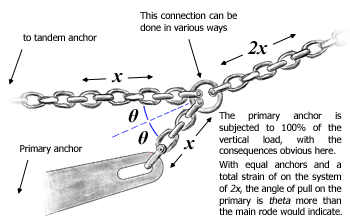

Yes it does. I've done this. First, 20 feet is your assumption. Let's say 6 feet depth, for a total of 9 feet. That makes 108 feet, no problem there. Next, set two anchors in tandem. Dive on the anchors and watch the nearer anchor lift as soon as the wind hits 15 knots. Right off the bottom. Look the Peter Smith drawing, which anyone will tell you is mathematically correct. Then ease the scope to 20:1 (180 feet) and both anchors stay on the bottom.
I'm not saying this is common. It is very, very rare. It is something you only do on slate, cobbles, or hardpan, so no, it does not apply to you. I'm saying you need to understand ALL of the math before you set simple rules. I disagree with Peter on many things, but in this case both the math and practice say he is right. The US Navy has also researched this.
I have no interest in scope vs. hold arguments. I have tested anchors and a range of scopes and published the data. I've done the same with catenary. You have to consider wind, bottom, anchor type, chain weight, yawing tendancy, and depth before you can talk about scope. Or you can just pick a "rule" that fits your boat and the places you go.
