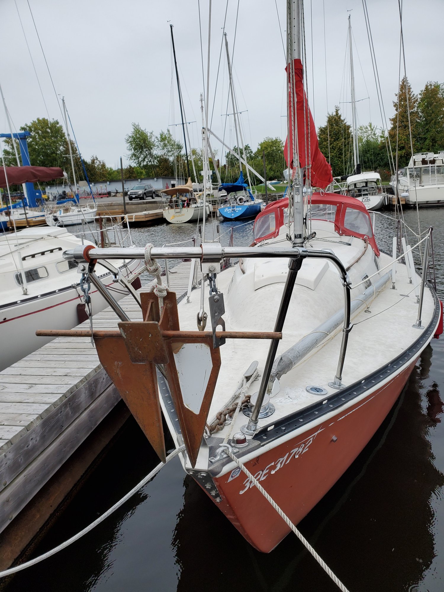

@fred1diver Does your Grampian have an anchor rode locker in the forepeak? I'm just trying to understand if you need to store the entire anchor plus rode, or just the anchor off the bow. My C&C 27 didn't have an anchor locker either (they added it the next model year) but did have a hawse pipe leading to a rode storage in the forepeak. When I was racing I would disconnect the shackle at the anchor and stow the anchor in a cockpit locker. When cruising I kept my danforth anchor on the pulpit with hangers. The spinnaker gets hung up on it, that's why it needs to be stored for racing. The danforth works exceptionally well in the mud we have on the Ottawa river and is light enough I could manage without a roller.

Hey Darcy, I don't have an anchor locker, I also use a danforth and have the brackets to attach it to the pushpit, I also have a hawse pipe, but a chain won't go thru it unless I modify it. It has 2 small holes big enough for the rode to pass but not the spliced eye.

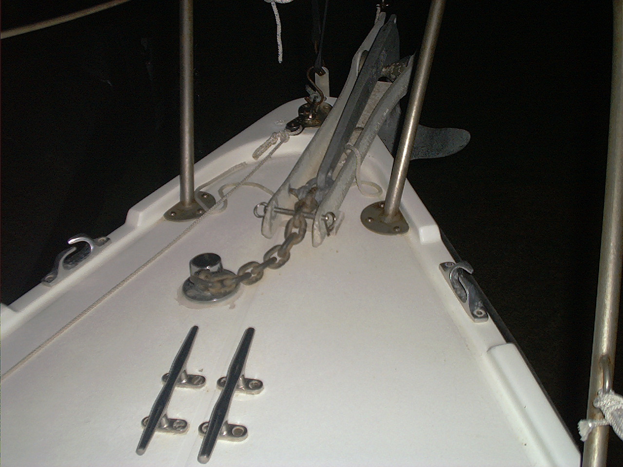

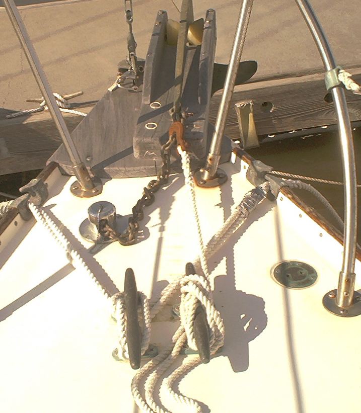

The first 15 years with our h27, our Bruce, 20+ feet of chain. and nylon rode lived in an open anchor bag tied to the toerail at the bow. The bitter end of the rode was permanently on the bow cleat. A very workable solution.
A few years ago, I installed a hawse pipe and a bow roller, so we have a more common configuration now.
