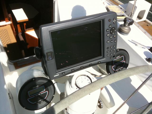

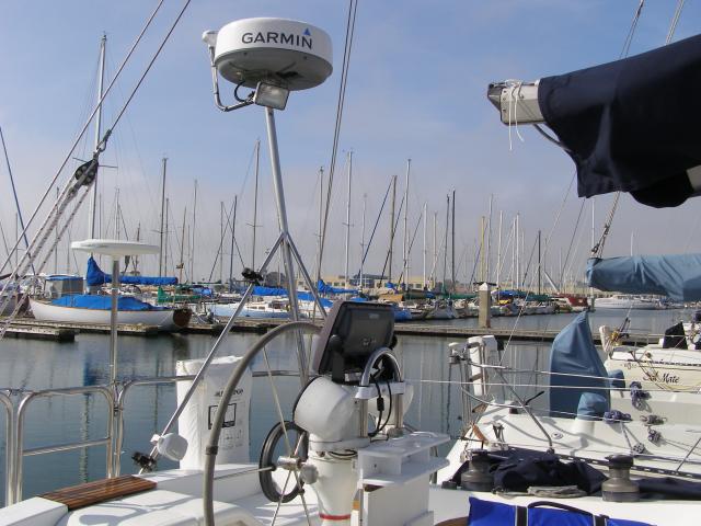

I recently installed a Garmin 3210 chart plotter, gps and GMR 24 digital radar for my 1987 Hunter 31. I had a pedestal and mounted an Edson table to it to mount the chart plotter. Alternatively, you can install a new pedestal to mount the chart plotter on. However, these are discontinued products and new ones are way more expensive. Last time I checked the 3210 was $1000 and GMR 24 was $400. New models sell for $2000 each. The gps is tied into the VHF emergency response signal. The chart plotter's split screen shows gps and radar. I plan to use it for night and offshore sailing and foggy conditions. I used them both last weekend when I got caught in the fog in a channel in San Francisco. Big improvement over the Loran I used sailed the Cheaspeake at night and Atlantic. Years ago I sailed from Marina Del Rey to Catalina Island in the fog across the shipping channel on a charted sailboat and would have welcomed a radar and gps.
