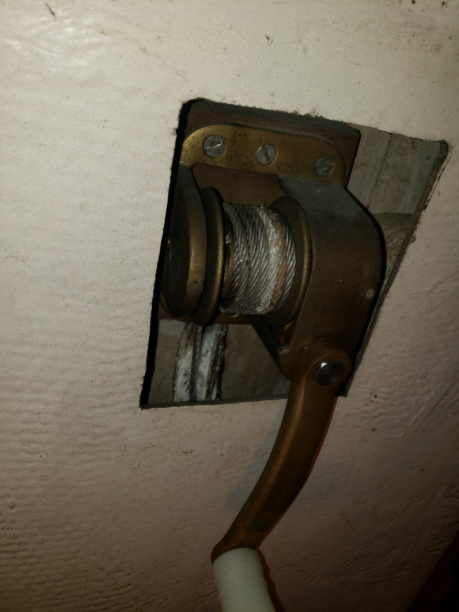

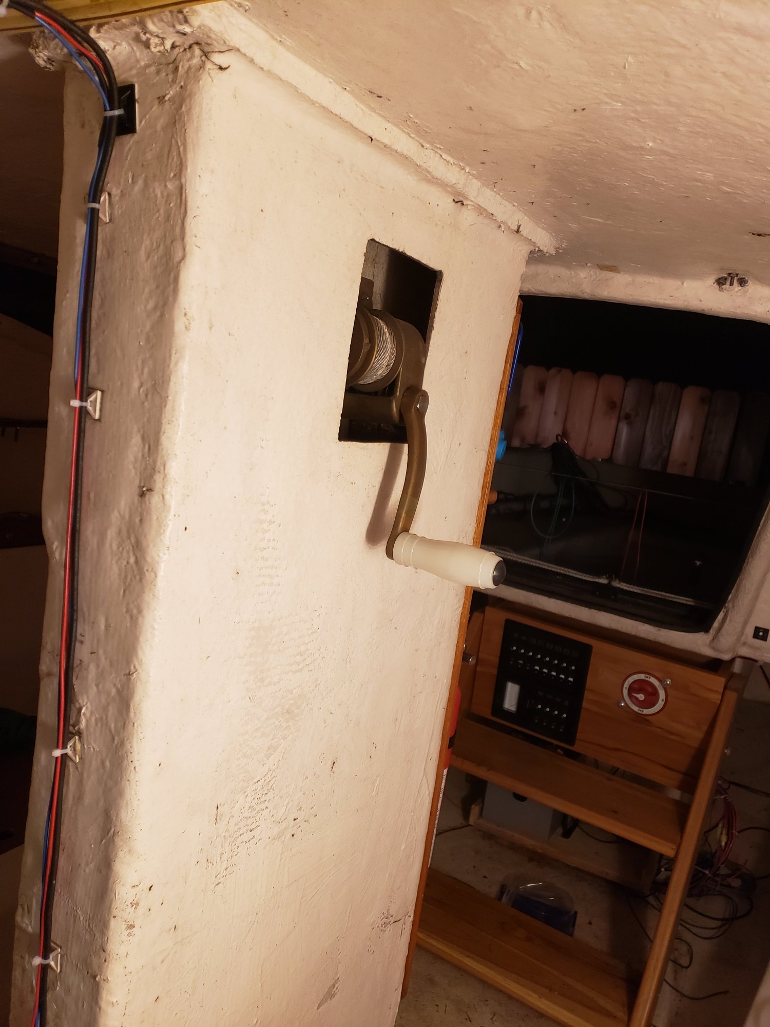

It sounds like you have a swing keel or lifting keel weighing 550 pounds. It would be held in place by a bolt either thru the keel housing inside the cabin below the winch or by the bolt secured by two hangers just like the Catalina 22 and and 25 on the hull. The machine bolts holding the hangers in place on the bottom of the hull are screwed into stainless steel plates embedded in the fiberglass hull referring to swing keel.
Since I am not familiar with the boat, can you take more photos at the bottom of the keel housing inside the cabin? Also look on the bottom of the hull for any bolts, hangers to see if there is anything there and take a photo or two. How about a photo of the deck atop of the lifting keel. I learned there were two keels one swing and the other lifting. So I am trying to make sure what exactly we are dealing with
