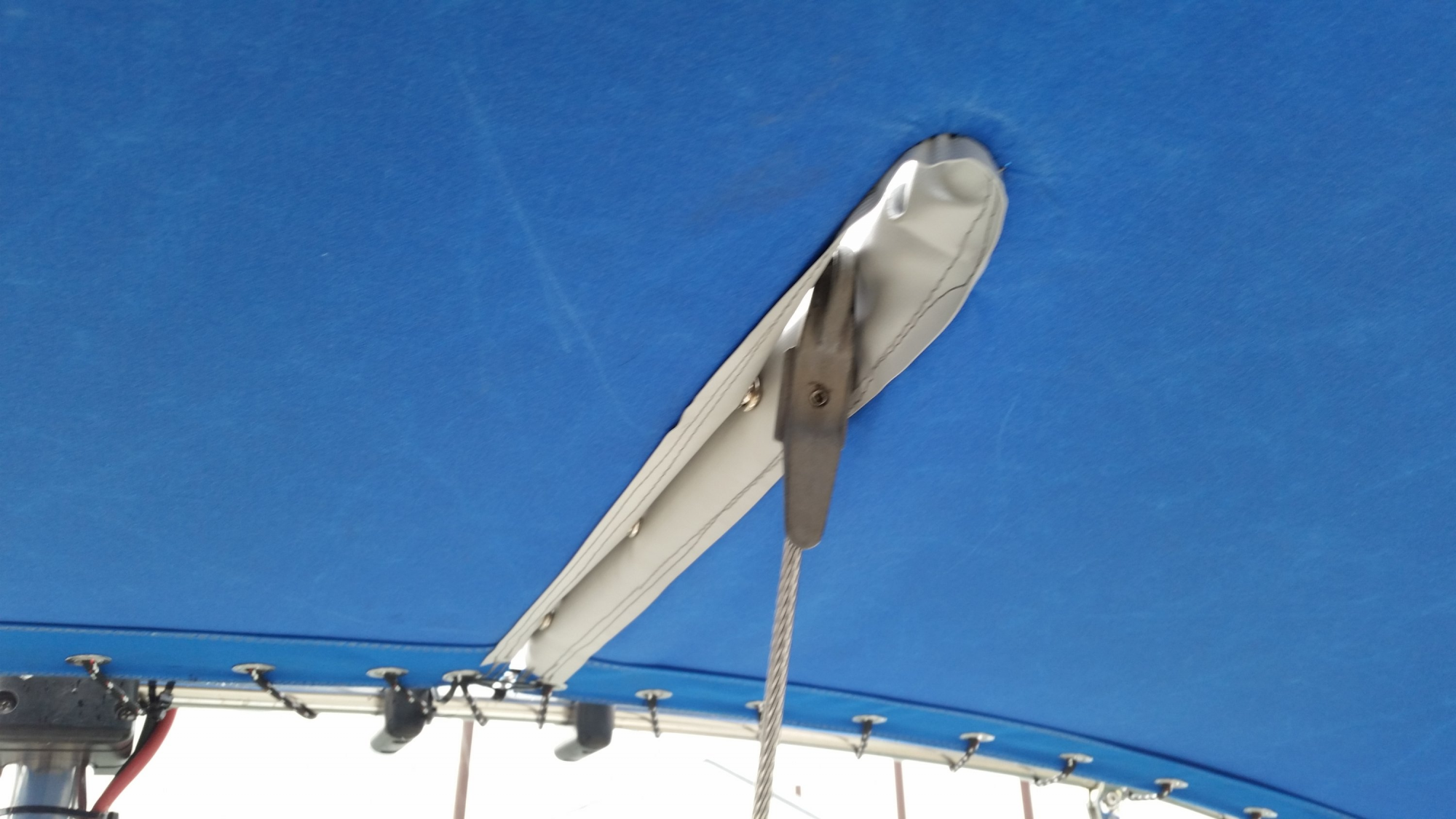

And if anyone has suggestions how to deal with the split backstay passing thru the bimini I'd love to hear them!
12,887
It is called a backstay slit.

back stay slit, zipper or laced.

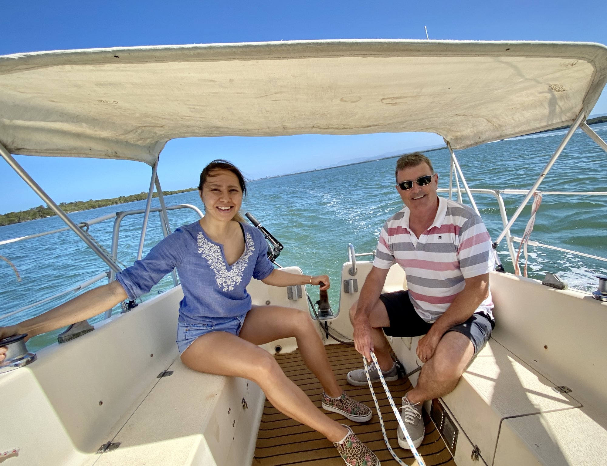

Here is a pic of my trailer sailer. This is a workhorse that has been through the mill. Not fancy but pretty sturdy.
The Aluminum frame and fittings have stood the test of time. 20 years of abuse.
Daughter at the helm.
gary

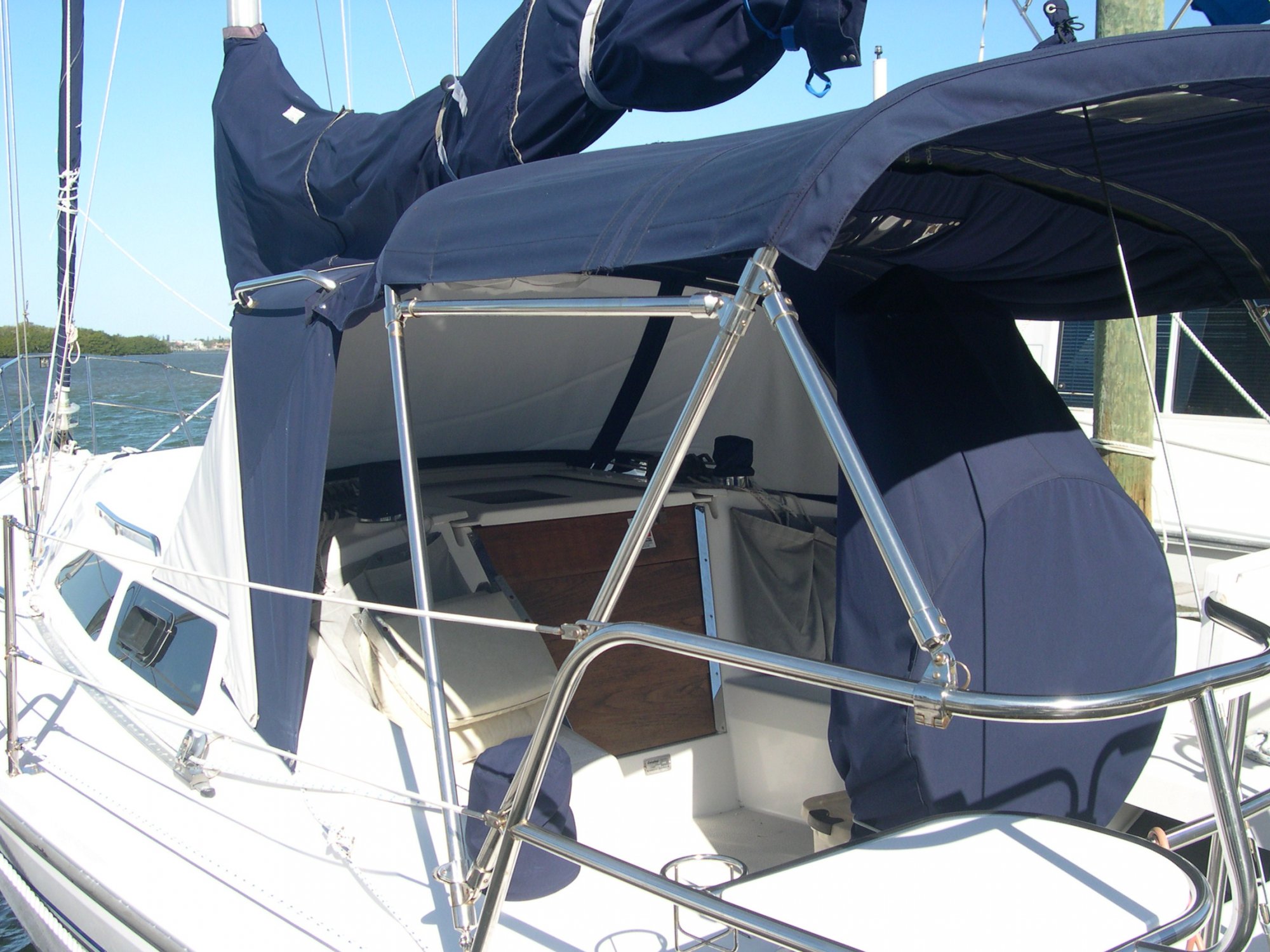

This picture shows the tubing securing the frame of our bimini. Stainless steel, obviously.View attachment 191691
Zombie thread comes back to life...
That's some nice work there. Where would one go to find such mounting hardware and tubing? Surely that isn't electical conduit from the local hardware store yes?

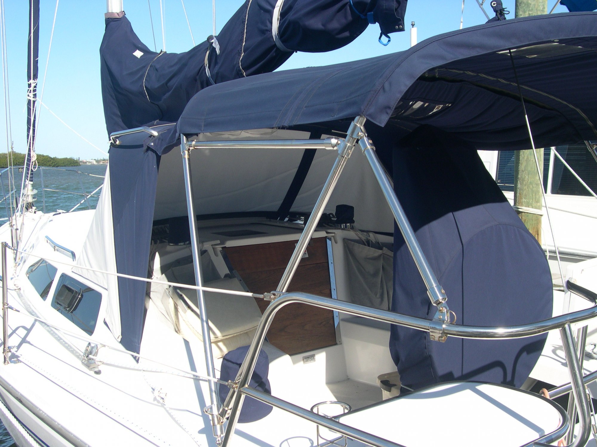

Catalina 310 Quincy, MA
I believe my bimini and dodger were installed by the Catalina dealer when the boat was new.
