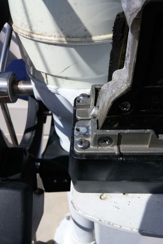

OK... this project (and thread) are done. I have installed the part back on the boat and it is (sorta, kinda, maybe) like new. After drilling the hole, I tapped but I must have pushed too hard. A small chunk of material came off. I installed the screw and added more material to fill the boo-boo. I kept turning the screw so it would not stick and to also ensure I get good threads.
Went down to the boat and everything fit!
So I would recommend this stuff. It is solid and easy to work with. For load bearing parts I would really shy away unless one is making a big piece with small mounting holes. Next (but not now) I will fill the screw holes in my mast.
Thanks for listening.

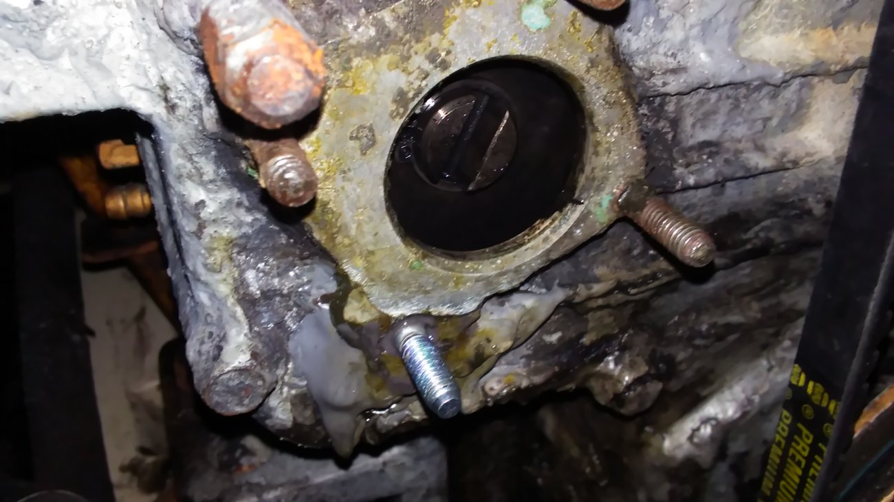

I finally got and used this Devcon material.
Far superior to JBWeld.
I cleaned the hole thoroughly and installed a new stud with the Devcon. I dry fit the pump and the next day I "glued" it in with the Devcon. After waiting a couple of days I reinstalled the pump, using Permatex Ultra Black gasket maker instead of a gasket sealant which had leaked last time, no doubt also due to the failed old stud.
So far so good.
Thanks for the OP from Brian, and to sailcapt340 for the Devcon. Timely thread for me.
