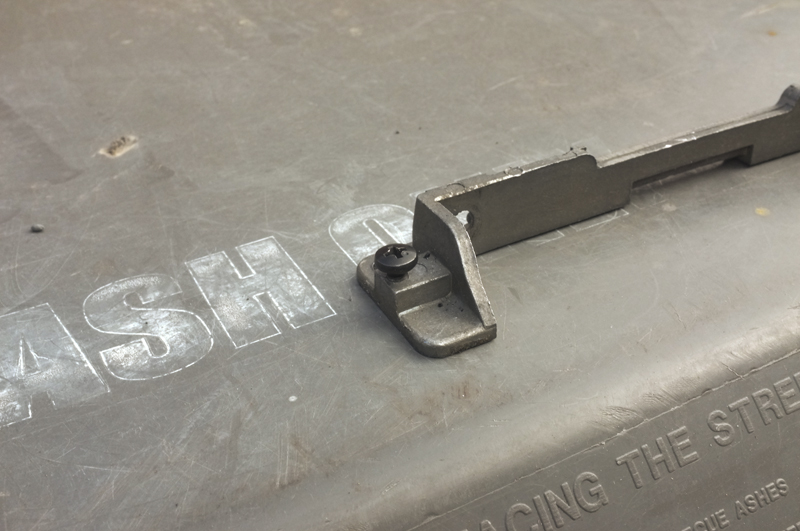

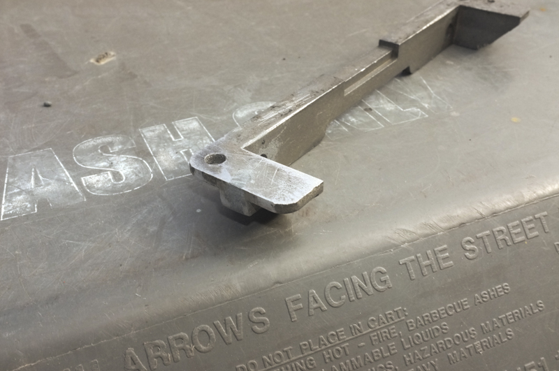

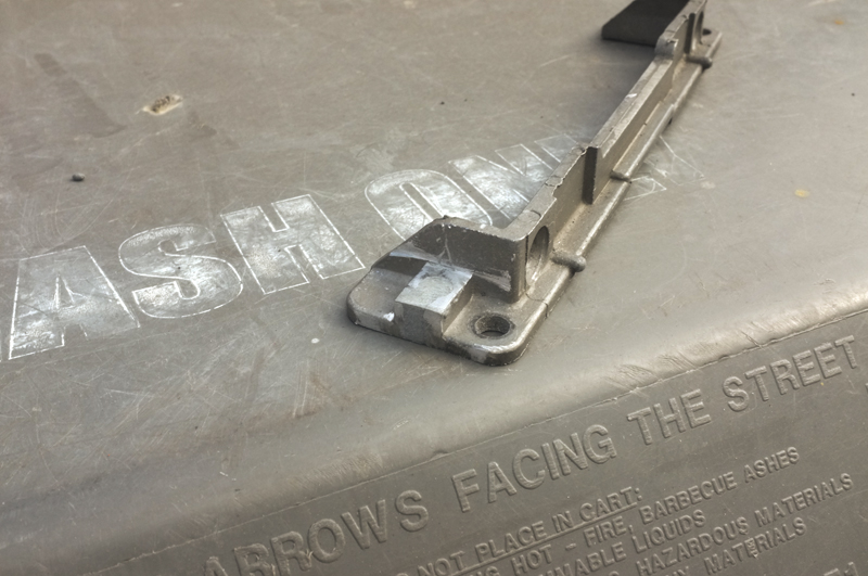

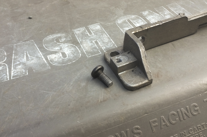

I have a small aluminum part on my throttle control that a screw was installed cross thread. The head broke off when I was trying to remove it. So I ended up drilling it out. but the drill bit kept getting off center. The end result was creating a new hole with part of the screw still in the part. Long story short, I ended up getting the bits out and in the process made the hole a little larger.

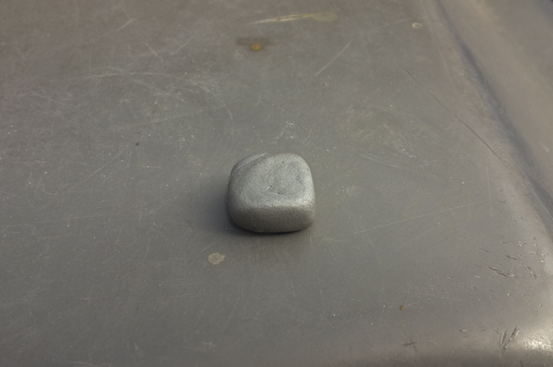

I have this Aluminum Paste that I haven't used yet. It says it dries quickly and can be drilled. So I have nothing to lose and worked it into the hole. I had a chunk of it just sitting (left over) on the bench. When I got done forming the fill, I picked up the chunk and sure as you know what, it was solid.
Has anyone worked with this stuff? It will be interesting to see if I can drill a new hole and tap for 8-32 screw. If it works I would have save beaucoup bucks on a replacement part. This is a non-load bearing part and is used only to secure the cover of the throttle housing. So no worries there.
