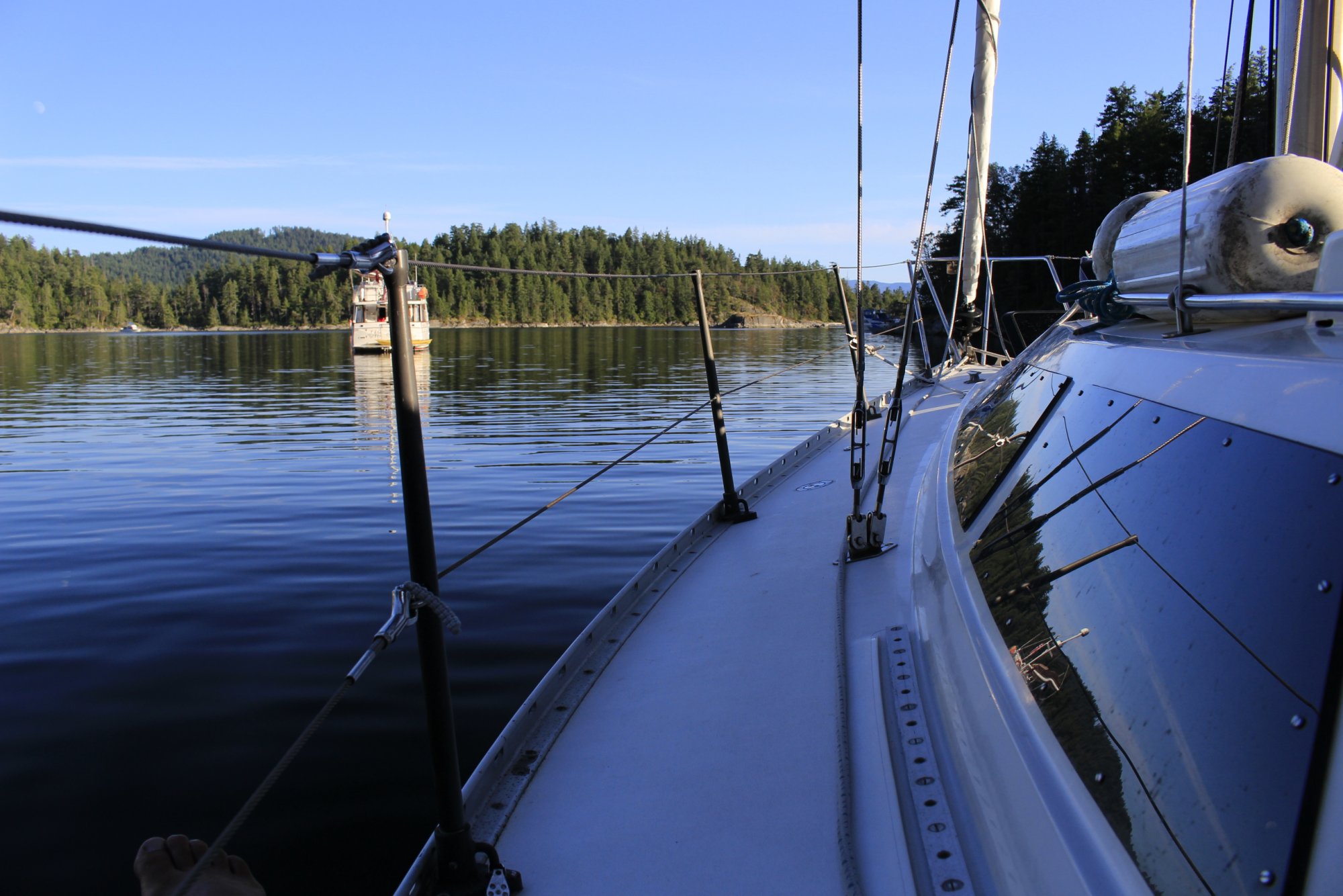

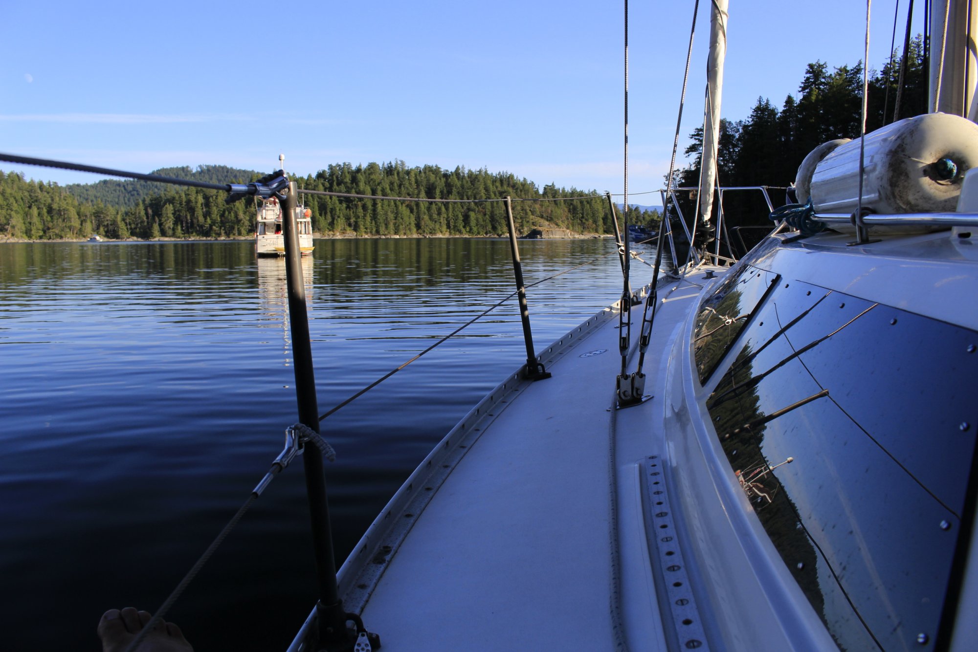

I think 3/8" would be overkill the windows are fairly small on the C 27 ... finally found a pic of the curvature we had to work with...
Thanks so much. It looks just awesome!
That is similar to the factory installation of the four fixed port (external lens) polycarbonate lenses on our boat.
With both sealant and screws it is "offshore strong" . They never leak, altho there are some key techniques to doing the install properly.
