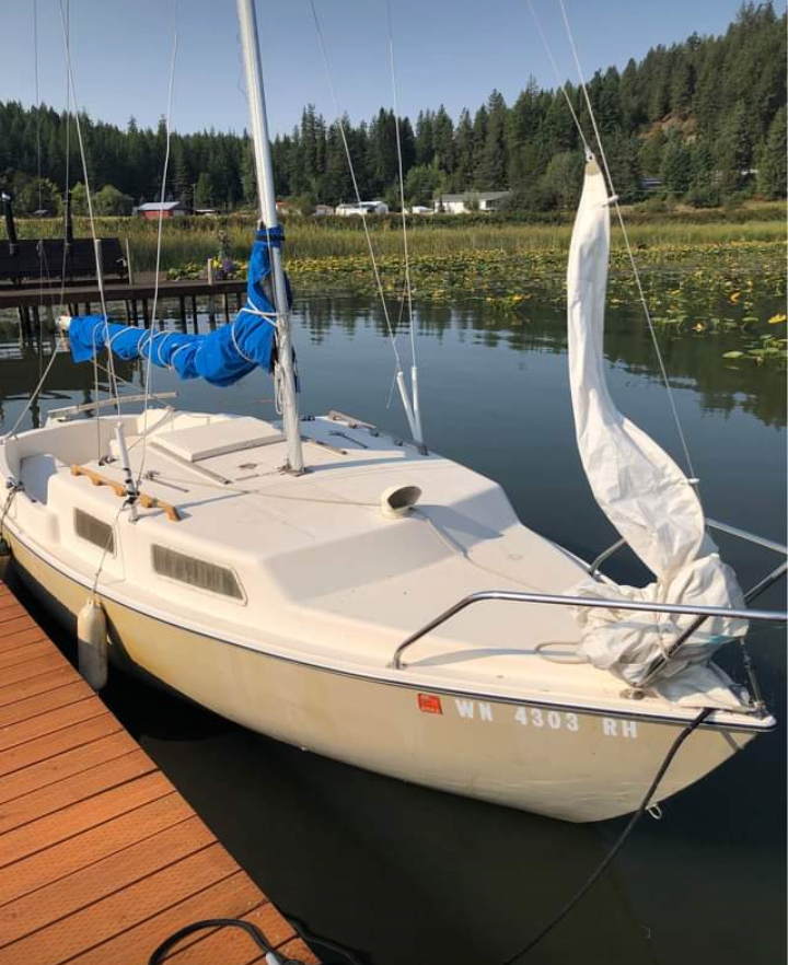

I am doing frame less windows on my San Juan 21
I was concerned about the over lap area being white through the the tinted acrylic. I saw someone on YouTube priming that area black on the backside.
I'm using the 3m tape and the Dow adhesive.
What primer is used.
Don't want that to compromise the seal.
Thxs

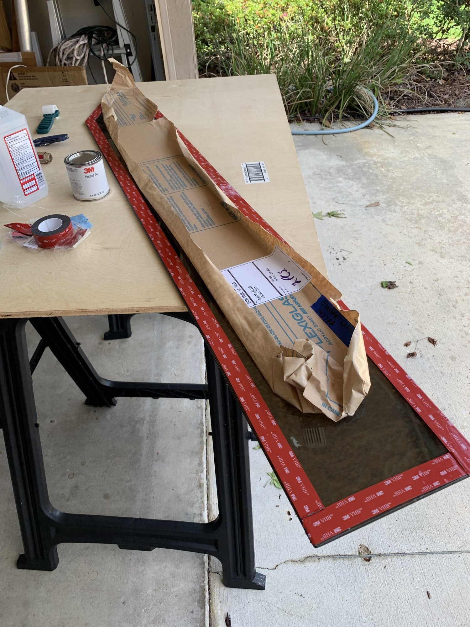

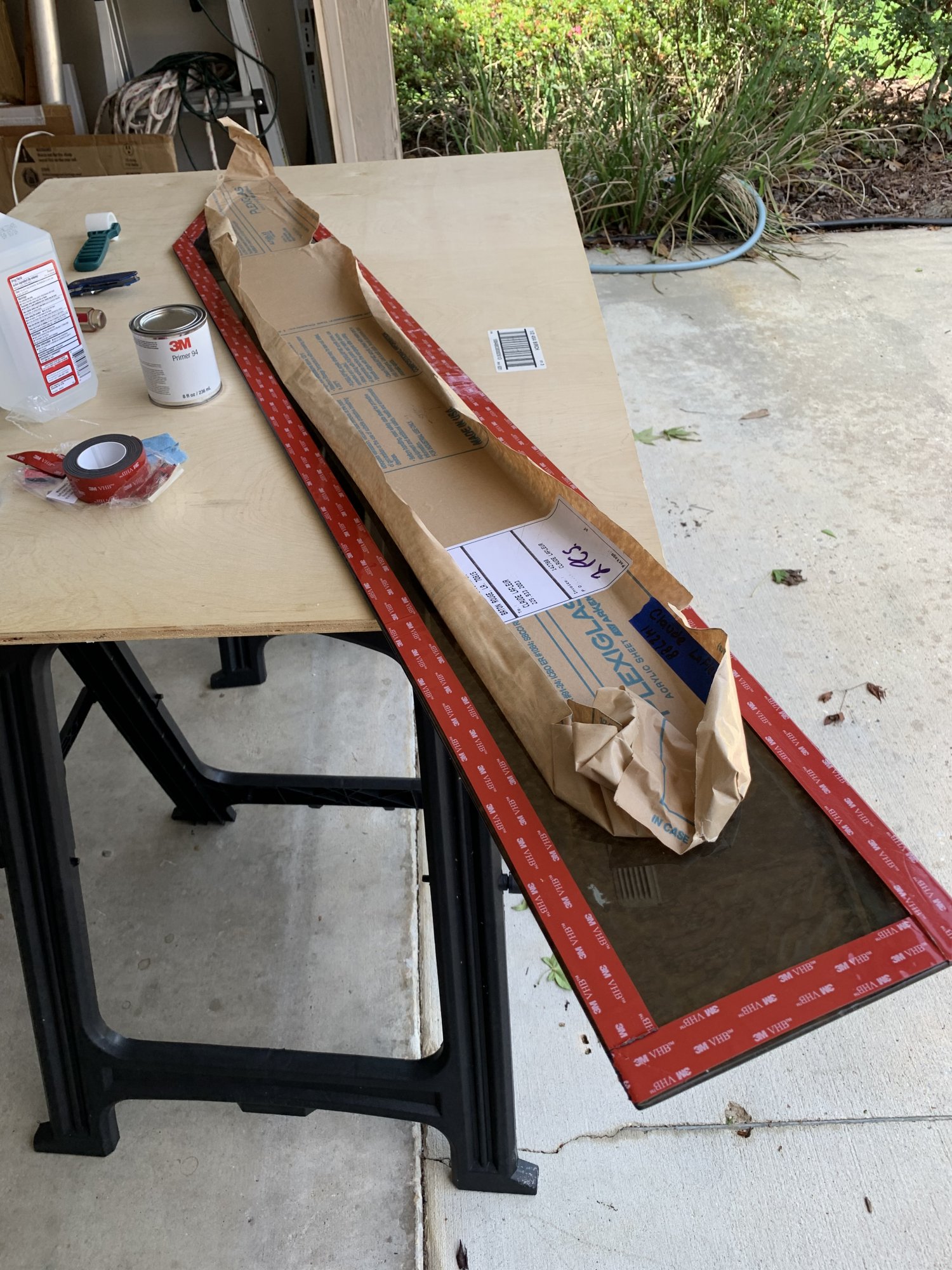

I used 1" wide black VHB tape to cover the overlap.. There was a thin (maybe 1/8") that didn't get covered. I masked that off and used a plastic specific "rattle can" to spray that and the area between the two windows since I converted to one "glass" per side. Paint came from Home Depot.. I did use the 3M #94 primer on the plexi and on the cabin side.. Note the little locator blocks that I hot glued to thhe cabin. When the plexi hits the cabin side, there is NO adjustment.. those blocks positioned it and then were easy to remove..

Ralph, I did not prime or sand the spots where the blocks went on, just wiped down. They easily popped off. I used a hot glue gun and regular glue sticks.

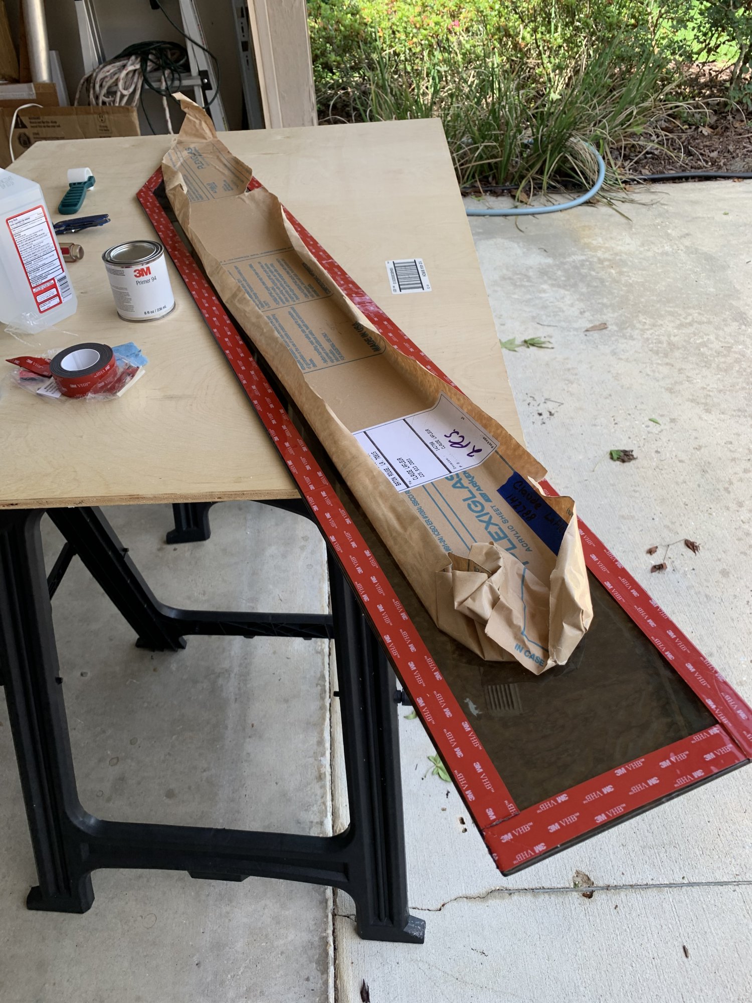

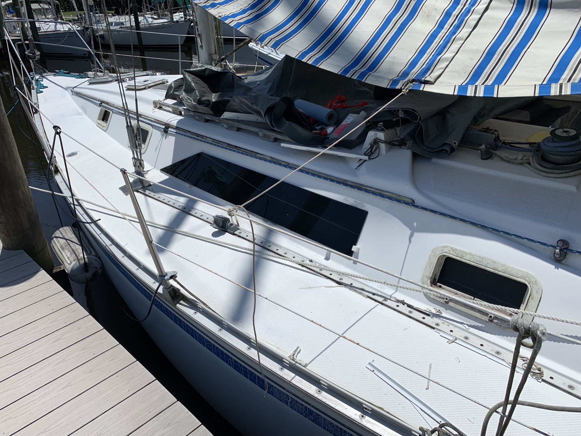

View attachment 199950View attachment 199951
Did you use any sealant or just VHB? If just VHB, any leaks?
10,200
After the VHB was well attached and the glass in place, I ran a bead of black Dow Corning 795 around the edge glass. Since the new glass was standing proud of the cabin side by its thickness, the bead made a kind of fillet at the glass edge. Since the VHB is a closed cell tape, I suspect it would be waterproof as is but didn't want to risk water freezing in the minute gap .. Yes it does freeze here a few times a year!
Likes: Trick
Sep 24, 2018
4,458
Catalina 30 MKIII Chicago
I was actually wondering if the sharp corners on your plexi was giving you any issues but I guess that solves it. I've done some research on VHB and there's over a dozen different types. Some are recommended for window installation and some less so. It seems the RV industry has been using VHB for windows for a while now. The trailer industry uses VHB instead of rivets for sheet metal panels. Last time I looked it up it was more expensive for rivetless. I though the labor to do a few thousand rivets would cost more than the tape
I like the method you used. Did you use a trim ring on the inside?
10,200
I ran a 1/8" radius router bit over the edges .. ya can't really see it but I was a little worried about the sharp outer edge chipping. Then sanded the routed part.. "breaking" the edge with sandpaper is probably sufficient. I used the original inside trim rings ..
I spoke to a VHB applications engineer.. he advised the 1" wide, thick black tape, I think I got 5952 VHB, 1" wide.

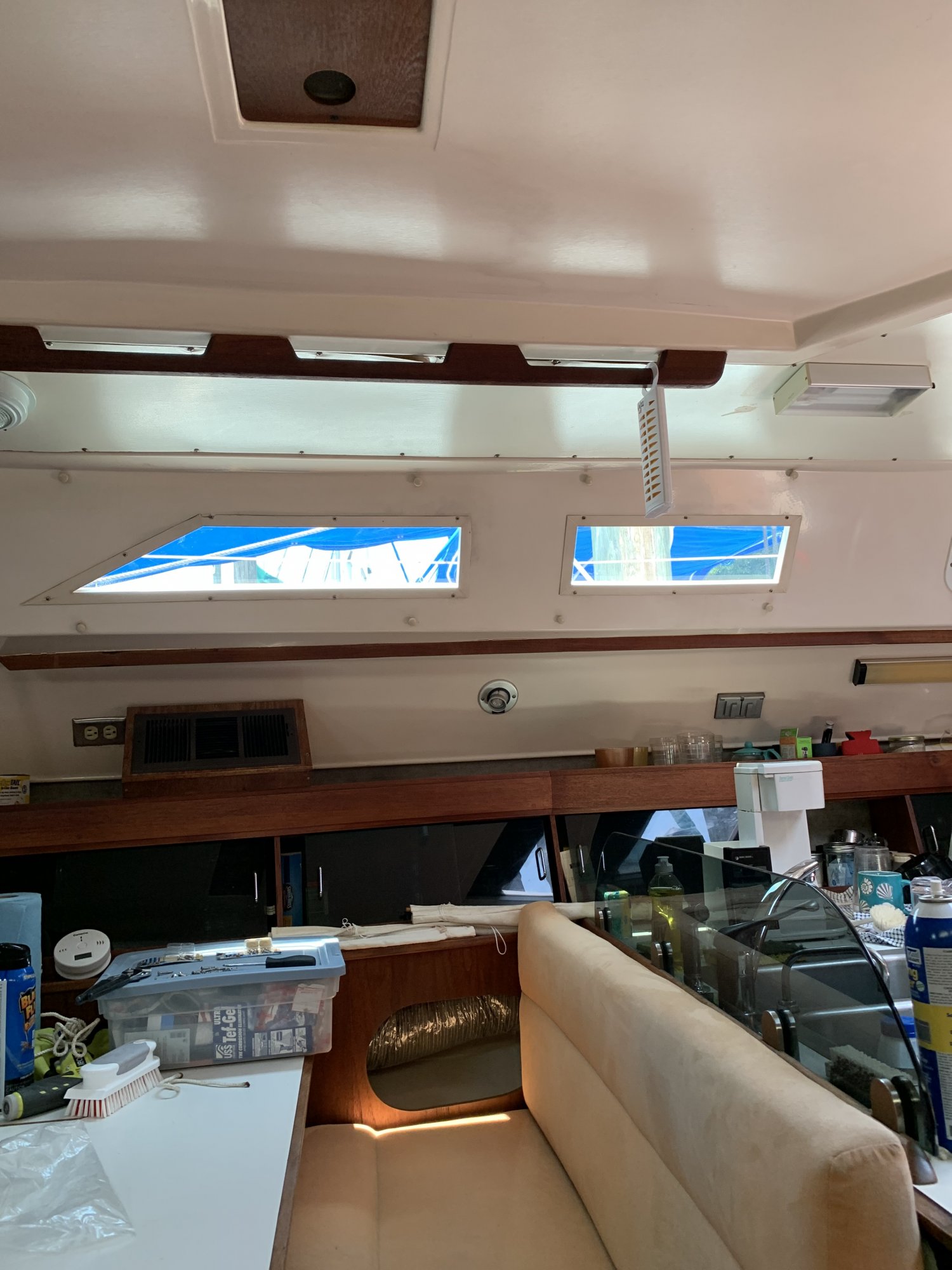

I used narrow black VHB tape (1/2" that was laid very close to the edge of the opening and used a razor blade to trim it flush. I used black 795 to fill down to the VHB. The acrylic was "Dark Smoke" and I can see no shadowing through the glass.
